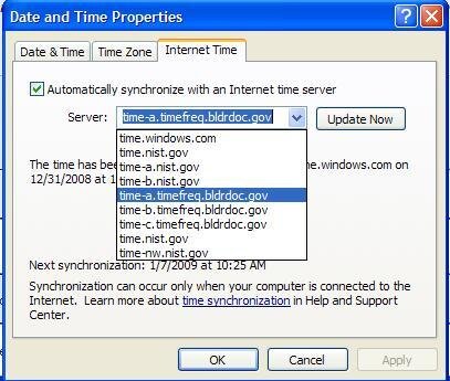

If you are running XP or Vista, syncing with an NTP server is built-in.
