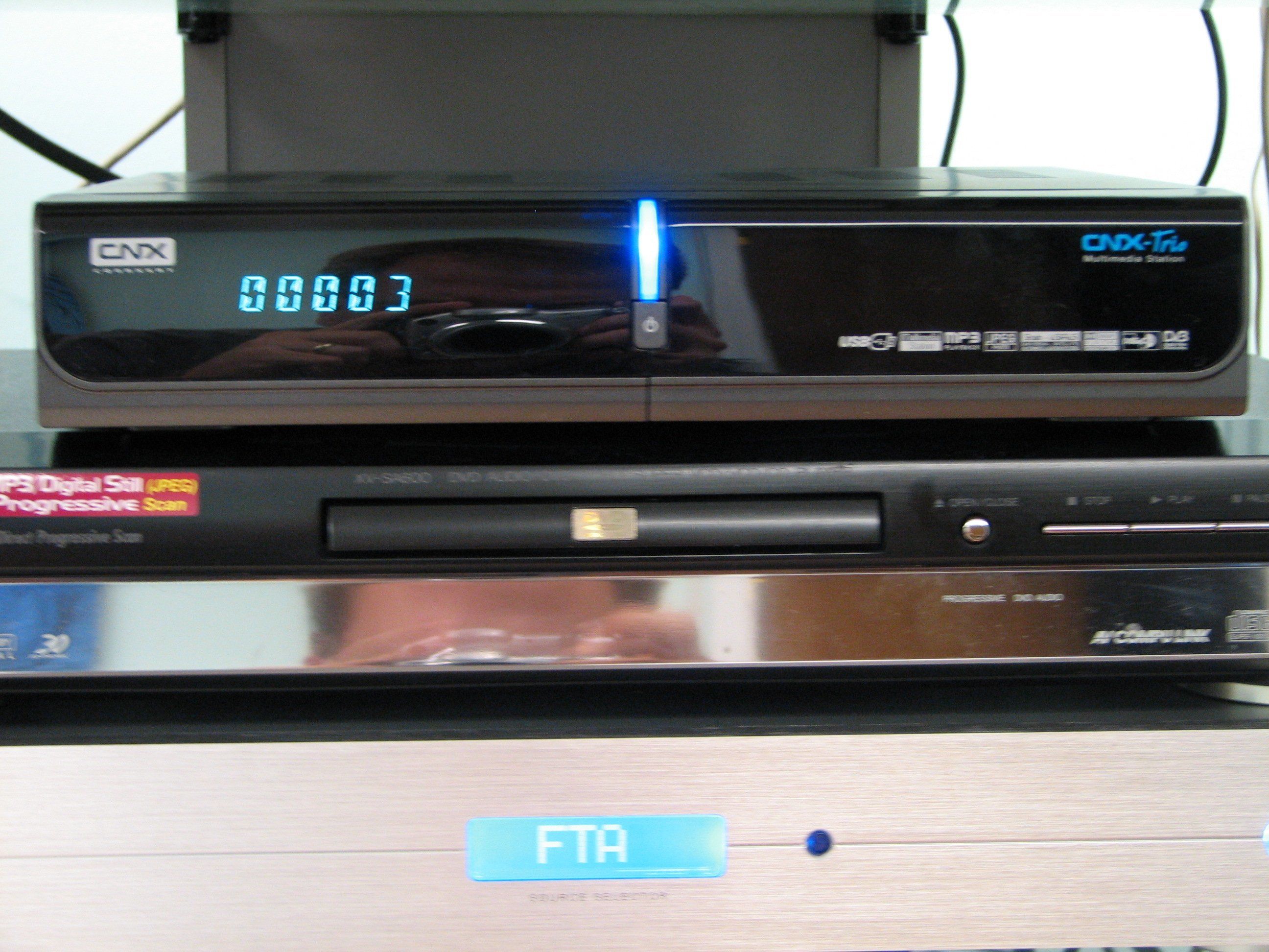

The Look and Feel:
In the box, I got a receiver, remote, batteries, A/V cables (RCA), manual, 64meg flash drive.
The Trio is a pretty slick looking unit out of the box. It feels very solid and well put
together. It's bright blue light on the front is kind of annoying in a dim or dark room, but other than that, it looks very modern. The unit I have is black, I don't know if they make a silver version. The two front USB ports are hidden behind a door (1 for USB files and 1 for divx files, they are independent and labeled with their function)

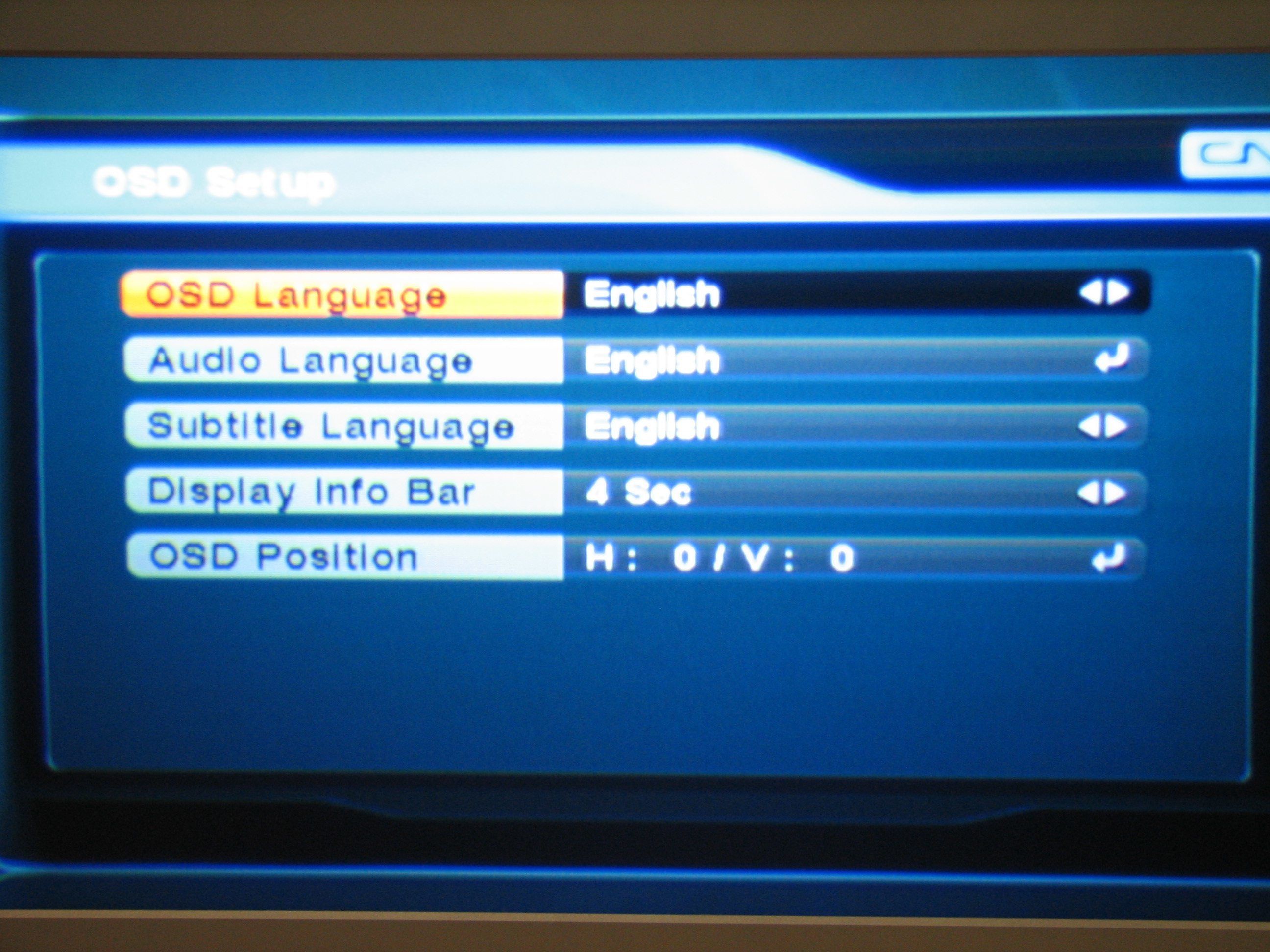

Nothing ground breaking here. Graphics are nice, I believe they are 16bit color. Main menus are basic blue/black/grays with some splashes of color corresponding to the fuction keys on the remote.

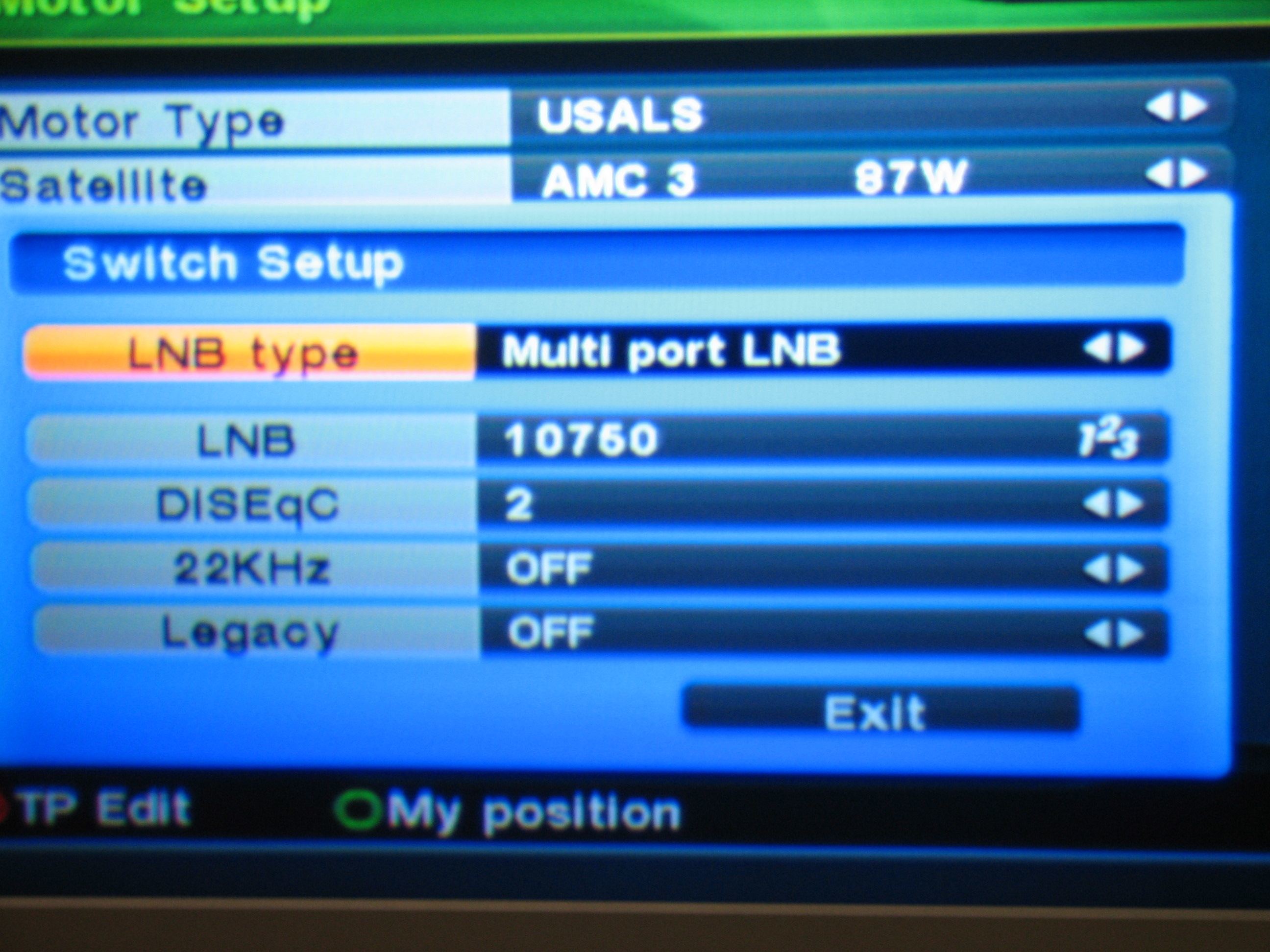

I setup my receiver to use USALS. Inputting the info was a bit cumbersome and the on-screen info was not explained well, but a bit of trial and error and I had it all setup.

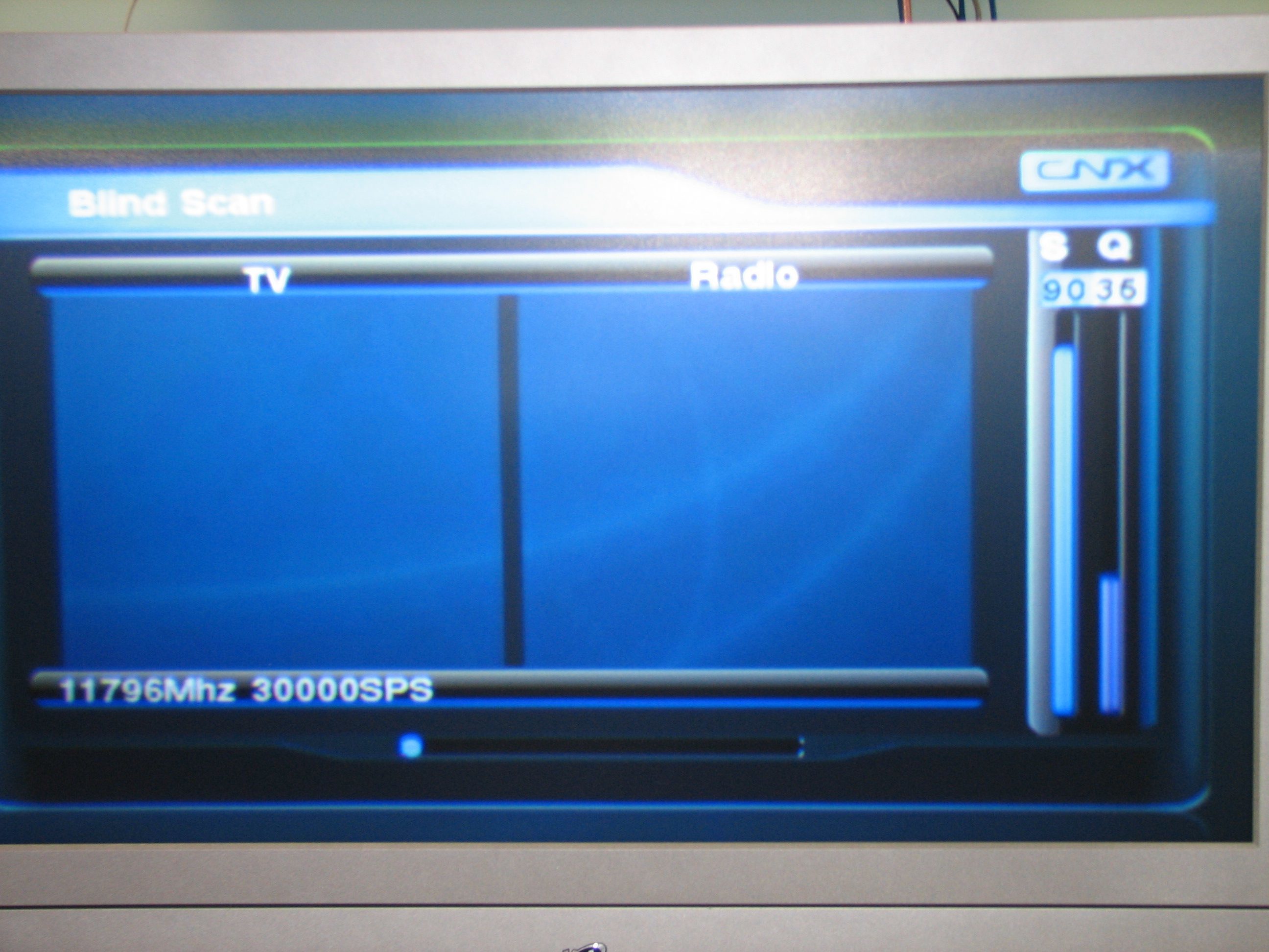

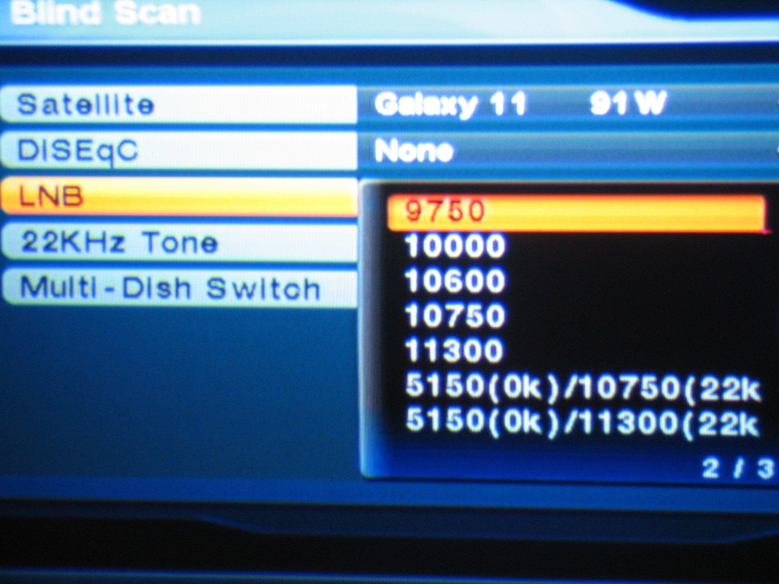

Scanning AMC-3 was interesting. Blind scan function is like you are doing a sat setup all over again. It's like the box forgot what settings I put in for AMC-3 earlier in the sat setup. So again, I have to put in what diseqc port and what type of LNB I am using. There is no polarity selection that I can find either.
The BS results were weird to me. The unit finds TP's and channels in 1 step and lists them in the resutls TV/Radio boxes. What was odd is the unit found all the TV channels just fine, but also found over 50 radio channels which were actually just 9 channels repeated over and over.
Blind scan time for this bird was very slow as the unit goes in 6mhz increments and does the channel discovery at the same time. So I guess overall the time is only slightly longer than my pansat 3500 which does the TP discovery, then goes on to a second part to get the channels.
I went on to scan other birds and found out that the blind scan portion is almost like a secondary setup for each sat. It seems that the original setup screen is only part of each sats setup. I also found that the unit seems to identify Data channels as such in the radio section when doing BS. Also, the radio station repeating bug seems to happen on any sat with a radio station or data channel. Another example being on G10r, the unit found over 1000 radio channels, in bunches of 252 in each repeat. When it finds these things, it seems to bog down the scan for a few seconds. Maybe there is a way to turn off the radio scan portion of the BS, but I have not found it yet.
I'm sure questions will come up from BS and I'll try to address them as you ask them, but for now, I will just say other than a few bugs, it does work as well.
Now on to motor control. I can sum it up pretty easily. IT WORKS! At least the USALs does. Diseqc controls work, but intermixing diseqc settings with usal settings seems to confuse the receiver and it got lost and I had to reset it. Keeping all Sats USALs was dead on no matter what I did to this thing. I even turned it off while moving from G10 to SBS6 and when powered back on it was like nothing happened and the dish resumed moving to SBS6 and stopped dead on. I have not done an all diseqc setup but I suspect based on the 2 sats I setup disecq wise with no USALs that it does not work correctly yet. Receiver got lost
after using diseqc postions moving from one sat to the other. It seemed to move slightly further each time I told it to go back and forth between AMC-3 and AMC-5. Each time I had to using the motor movement more and more to bring the dish back to correct spot.
So I give USALs support a big thumbs up and diseqc motor control is something to avoid right now.

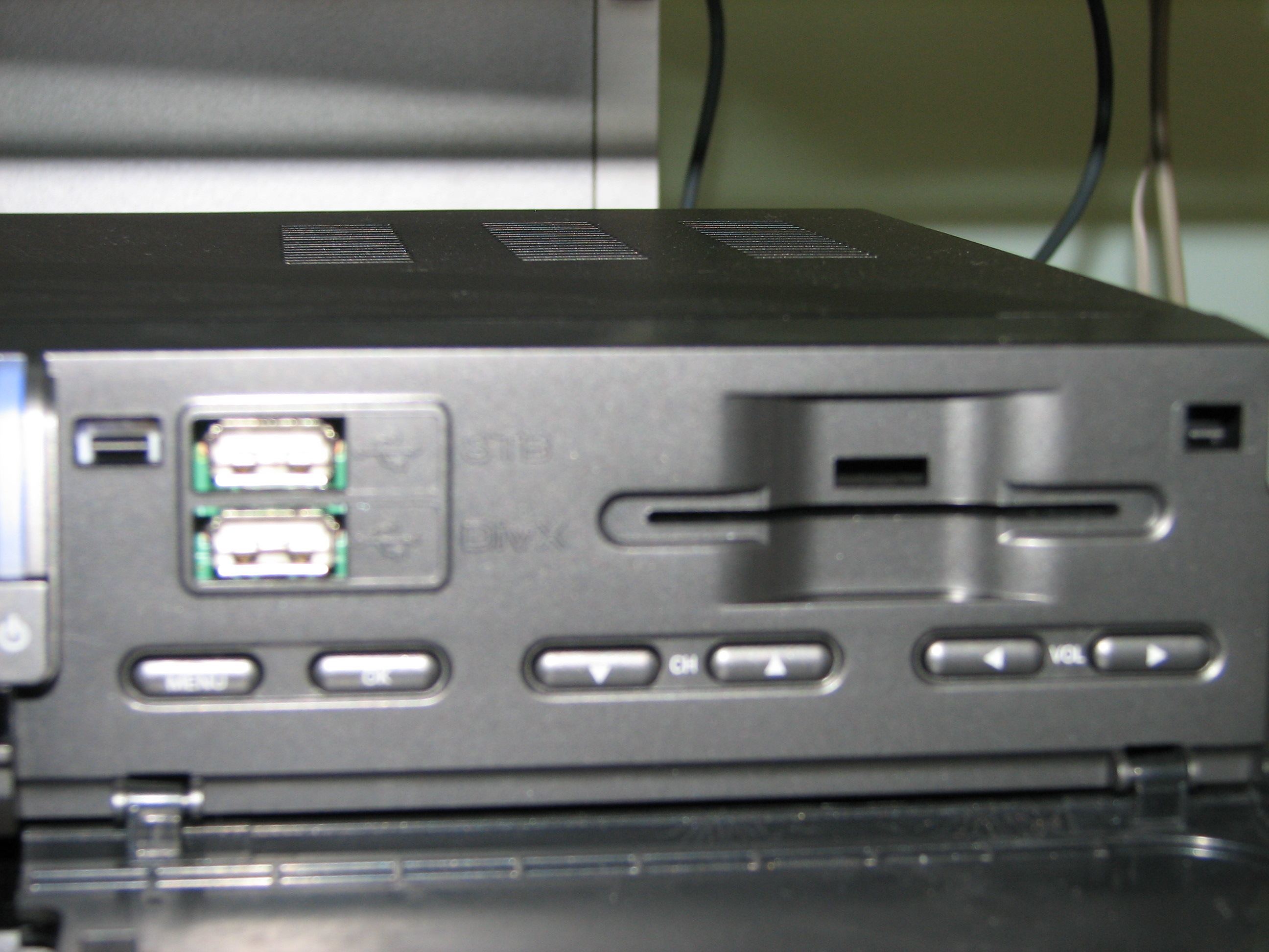

I can read divx from a hard drive, if you plug it into the divx port on the front. It'll read pretty much anything from the HD if you plug it into the front divx port.

I noticed last night that since the unit had 3 usb ports, it "auto-detects" when you tell it to read from USB in FTA side. Kind of annoying if you have a hard drive in the back and flash drive or another drive in the front. It does have an option to choose front or back, but only after it screws you up auto-detecting.

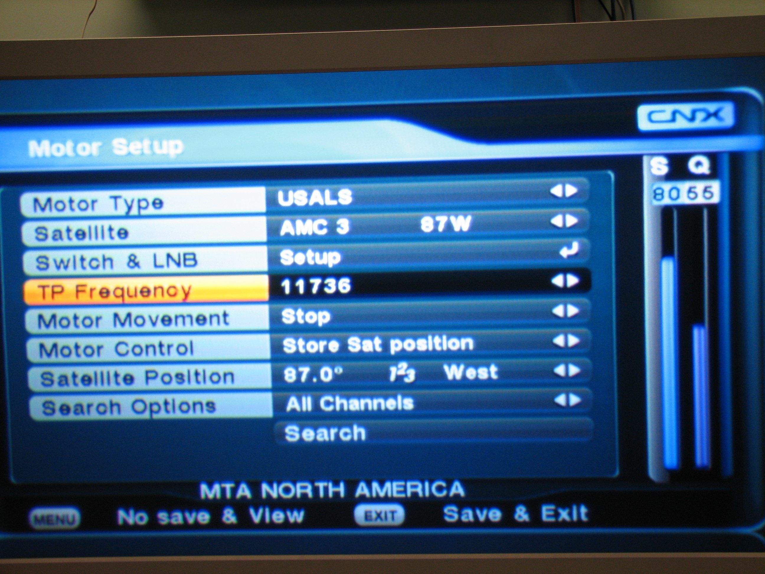

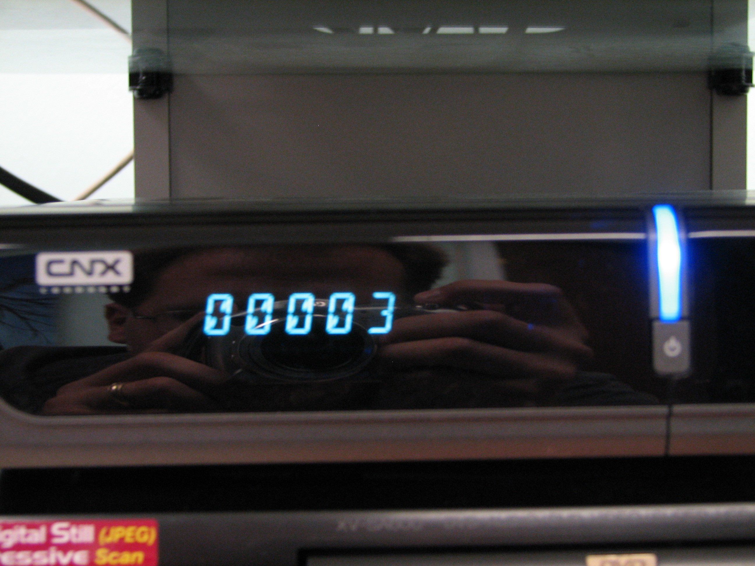

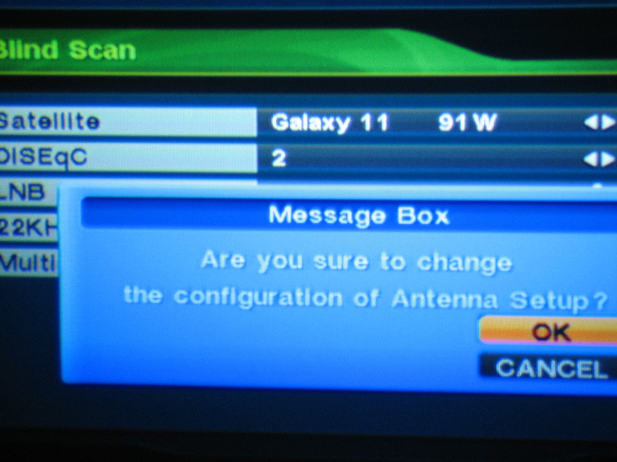

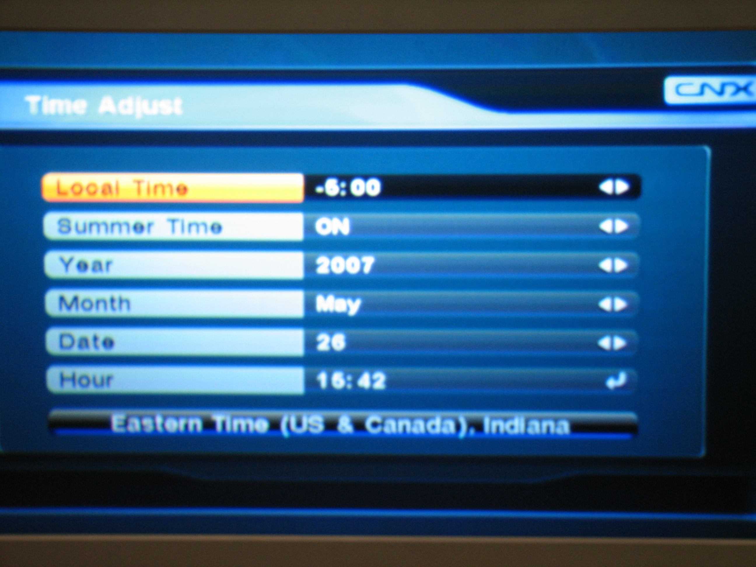

Ok, I forgot to do this and the_wizz reminded me.
Here's some pics of the unit front and some of the menu's. I didn't take any shots of the actual picture output as it always look bad on pics, but the PQ is really very good.
Remember I am not running the official website version of the software, I am running a pre-release version as I was selected to participate in some beta testing after contacting Conaxsat and asking some questions on the unit. I only took screen shots of the menu's that I was ok'd to take. Not that anything is top secret, but since it is not released to the public yet, features may disappear or change.

The main menu really won't tell you much, it has limited main options that expand into sub-menus
1. Channel Manager
2. Motor/Diseqc setup
3. OSD setup, user settings, time
4. USB utilities, timer settings
I recommend taking a look at the website to see the official specs and features.
Is there something specific you are looking for that maybe I can answer for you?

  • Blind Scan issues have all but been corrected (just a few minor things with low SR stuf) no more hundreds of bogus channels on the radio side.

Blindscan is much like a fortec now. Multiple stepping options, SR range selections, polarity selection. It is grabbing stuff that it missed before with low SR.
