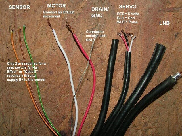

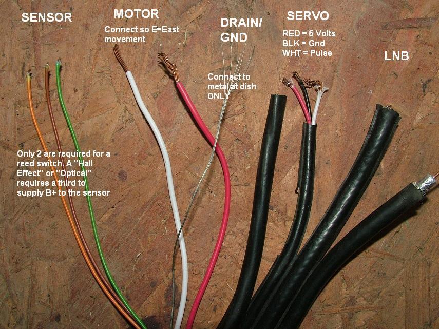

yes everything worked. I just don't have the manual to know what cables to connect where on the transceiver/receiver.
wires
maybe this will help
