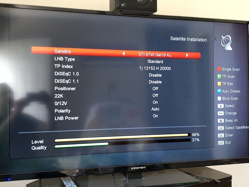

As a newbie, I just assumed that when I selected a satellite from the menu, the receiver was looking for any frequency it could find on that bird. I didn't realize I had to manually input a transponder. That was the major difference for me between pointing/aiming a Dish Network dish and this FTA. Once I realized I had to manually input a known transponder, it was super easy.
Now I'm ready to try 103. What's a good strong transponder I can use on that bird to help me align?
Why do the signal qualities vary so widely? Some are 82, some 10 or 0. Is it the location of the uplink? Or different transponder power? Signal strength stays about 92.
Not only was it not looking for any frequency but the typical FTA receiver does not know what satellite it is looking at, even though it shows 97W (or any other sat) on the menu.
As long as you have all the other settings correct you can be aimed at any satellite and it will pick up signals and show quality no matter what sat location is showing on your setup screen.
Congrats on your progress! :cool:
For the life of me, I cannot pick up 103. It's 103 W SES3 KU right?
I know you just went through this to get 97W but will ask again...Do you have an active transponder frequency entered for whatever satellite (103W) you are attempting to aim at?
That is the key...as I said just above it doesn't matter what satellite designation you are seeing on your "Satellite Installation" screen, as long as you have a hot tp entered and the other setting parameters are correct.
Yes, 11940 20000 Vertical
I can lock on 97 as easy as pie, 103 not a blip
