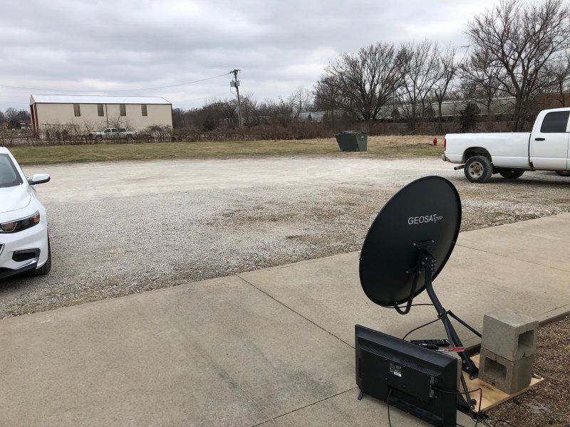

I was able to get 91, 93, 95, 97, 99, and 101, then nothing on 103, so that makes me think the building is in the way (I've been testing all this out on my temporary mast in the yard). Tomorrow I shall move the dish to another location and see if I can get 103.

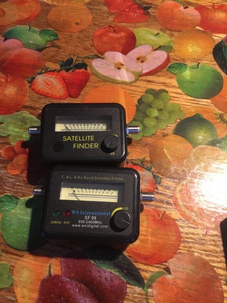

Get one of the elcheapo meters,they don't tell you much but it will show when you're pointed at something.
My Personal El Cheapo Meter Graveyard since October

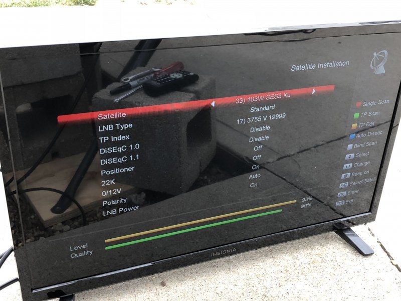

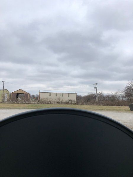

Ok, so I've moved the dish to a location with a wide open view of the southern sky. Same situation as before. I can get everything below 101, but everything above that is a no-go. I am REALLY confused about what I'm doing wrong. I adjust the elevation of the dish, the LNB skew, and the rotation of the dish and I get nothing. Nada. Help!!
What transponder are you using for 103W?
Try 11942 or 11943
Reactions: danristheman
v or h? 20000?
Yeah the rest is all the same, V 20000. I get that at 11942 and some receivers/LNBF combinations show it as 11943. The receiver should get it at 11940, but just wanted you to try that.
Makes no sense why you are not getting 103. If you are slightly lowering elevation from 101 and bumping slightly west...and you are adjusting the skew. ???

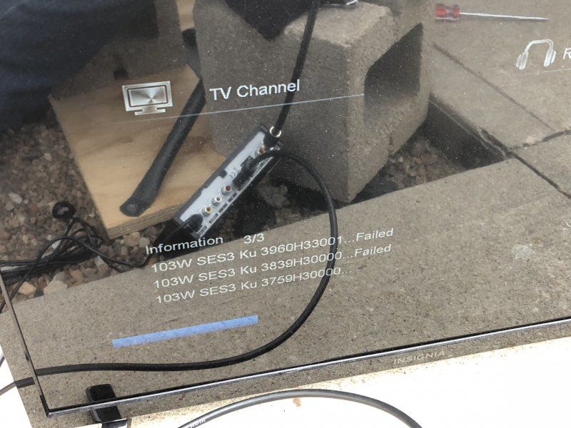

this is what im seeing
Funny thing is I can see all the Macy's stuff on 105 now, but I can't find the "sweet spot" for 103
Hmmmm check the LO for 103W Ku. Is it set for 5150? If so that is the issue. It should be 10750.

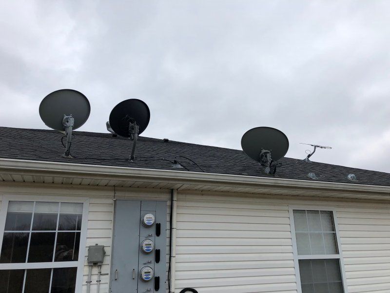

I'm going to leave it on my temporary rig for a week or so, then decide where to put it permanently. I like the idea of having it low to the ground so I can get to it easily, and when I add a rotor to it that will be helpful also. The thing is, not sure how well my landlord will like it there. The photo below is of my roof. Is this dish too big for a roof mount? It has a lot of surface area; I'd be concerned that wind would be an issue. There is a foot up there from a Hughesnet dish that might work, but the Hughesnet pole was bigger than the standard 2"
