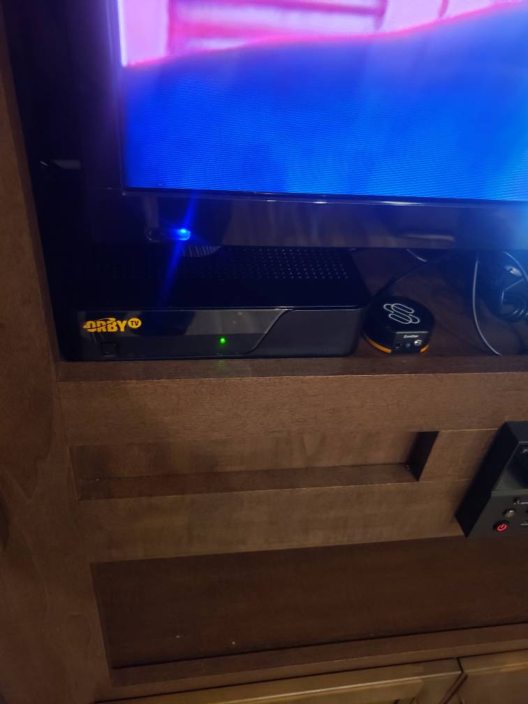

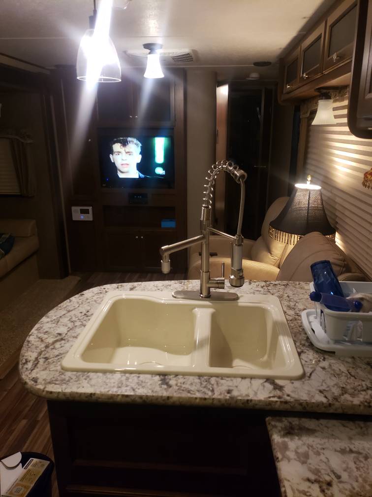

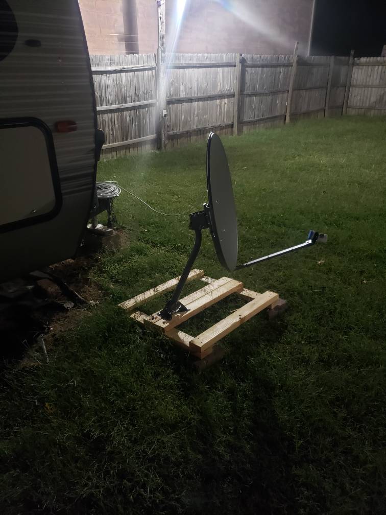

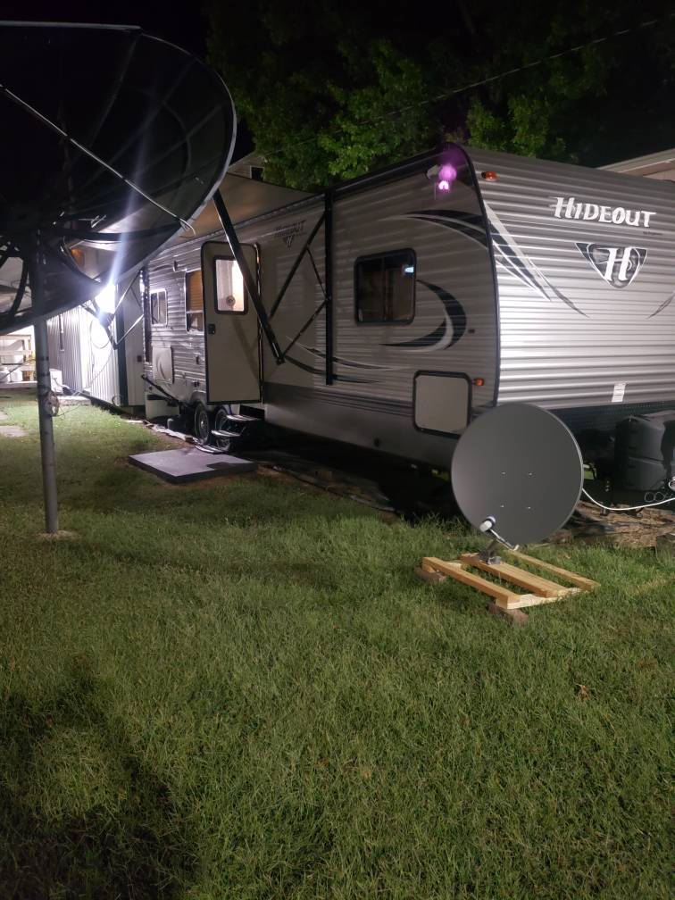

Here's my ebay dish. 30" ku on a home made mount. Works fine for my camper.
I also have orby in the house.
