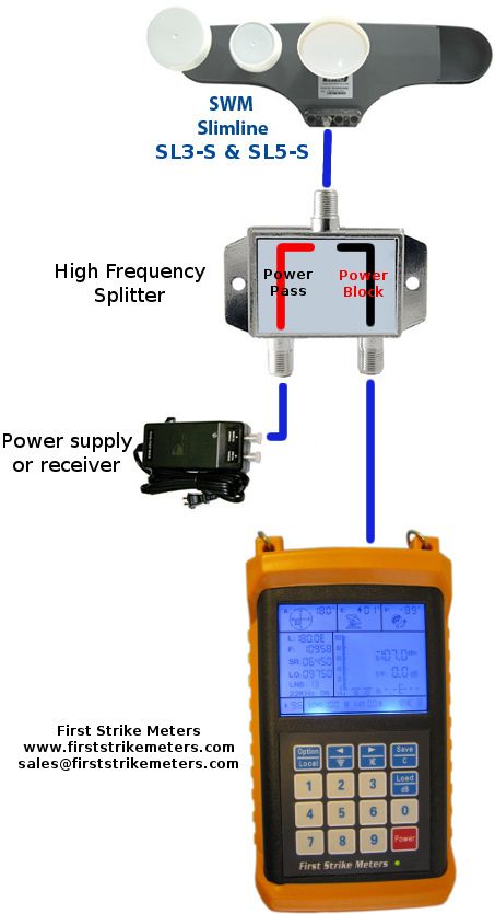

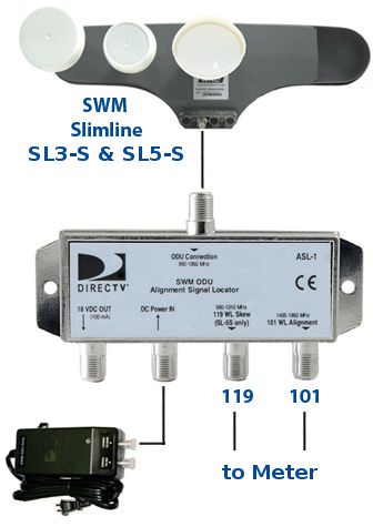

I found a few things on First Strike's website that might be helpful, maybe.
fs1-powerpass.jpg using a high frequency splitter to power multi-head LNBFs
asl-1_diagram.jpg Aligning DirecTv dishes
Those were from here: http://www.firststrikemeters.com/fs-support/fs1-frequently-asked-questions/

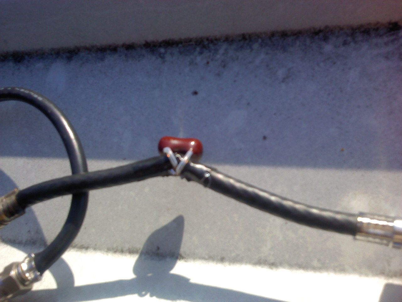

Ok Guys I have done some more research. I built a short RG6 jumper and opened the shield in the middle and cut the copper center conductor and brought it up and away from the shield. I then soldered a dipped silver mica 5000 pf cap onto the two leads. This will allow me to connect my FS1 meter onto the SWM 2 way splitter that Raine posted in his post above. Now the meter is not shorted out by the output of the 2 way splitter.
When I tested it at the location of the SL3S dish,with the DTV PS on the pass thru side, I did get a 2% quality reading on one satellite.
This leads me to think that I do not have the correct data loaded in the meter.
The ones posted on the FS1 meter site did not work on my meter. I did read of the FTA ABC sat at 91 W and loaded them into my FS1 meter and got 100% quality reading on the meter, so I am confident that the meter works when the correct data is loaded.

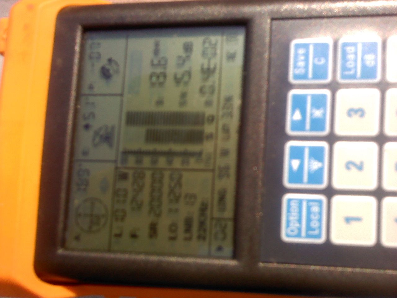

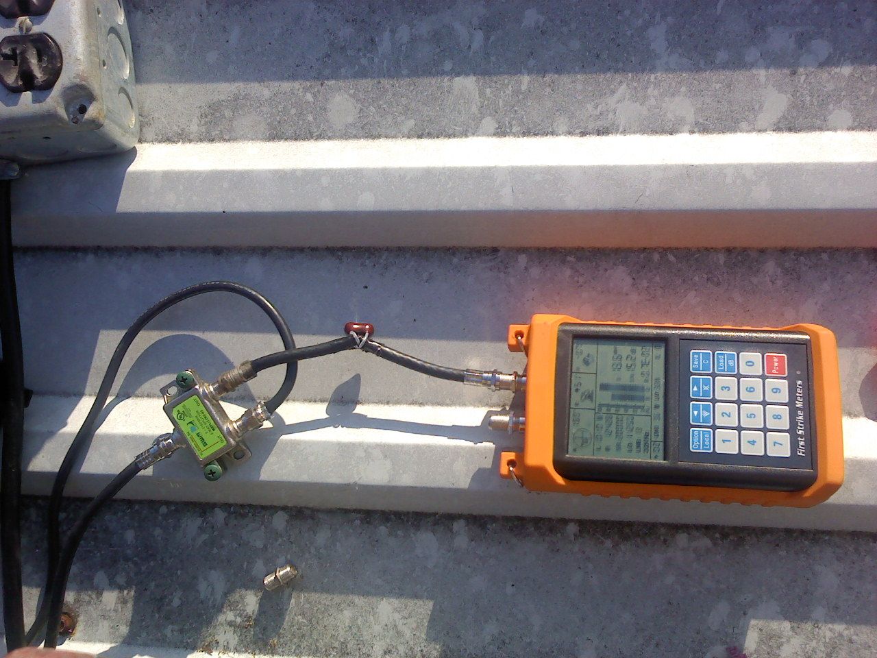

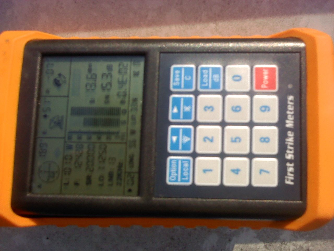

Well guys, time to close this link !! I did another site survey after seeing that a neighbors tree was imposing on my view of the three HD DTV satellites. I moved to the car port on the opposite corner from my FTA dish. I attached the mount to the square metal post with straps and 4 inch 1/4 bolts. Plumbed the vertical and then put two sheet metal screws to stabilize any sideways movement.
Then I powered up the LNB with the power inserter with a power pass thru splitter and my DC blocking cable and FS-1 meter attached to the receiver output side of the splitter. I tested with the four TPs listed on the FS-1 site for know active TPs.
Of the four listed for 101 W, the 2nd hit nearly full scale on the Quality Bar. I continued to peak in elevation and azimuth settings with the FS-1 meter. I locked the dish down and connected to the IRD receiver. I ran thru the 101 W signal strength reading. PRESTO ! All the readings were in the 90 to 100 % values. Now the critical bird at 99 W. All were in the 80s to high 90s !.. All the other signals on the 103 W bird were great.
I have posted some pics to show the hook up and the DC blocking cable and readings on the FS-1 meter. My cell phone lacks some clarity, but I was getting nearly 100 % Quality signals.
Thanks again to all that commented. To Raine: I will try some other down link frequencys and other TPs and look for readings. I am using S/R or 20000 and LO of 11250. If you have any other values, please pass then to me.
Thanks again to all ! Regards, Doug .
