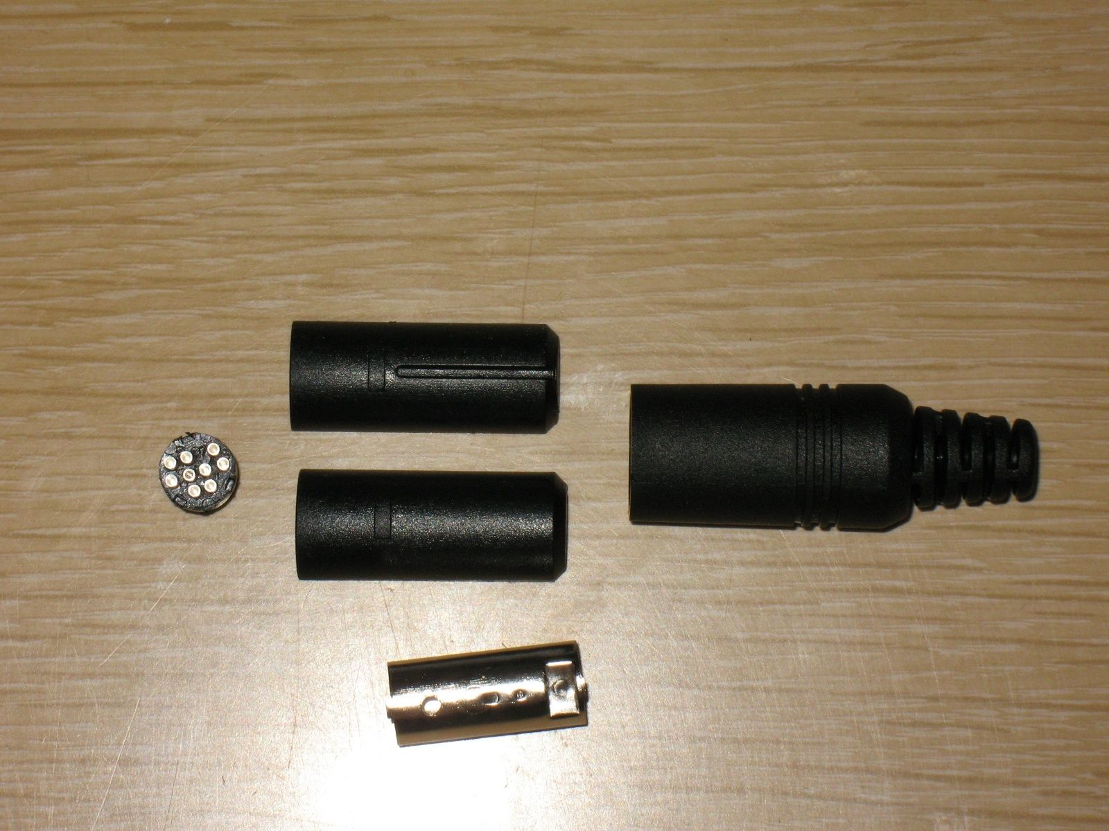

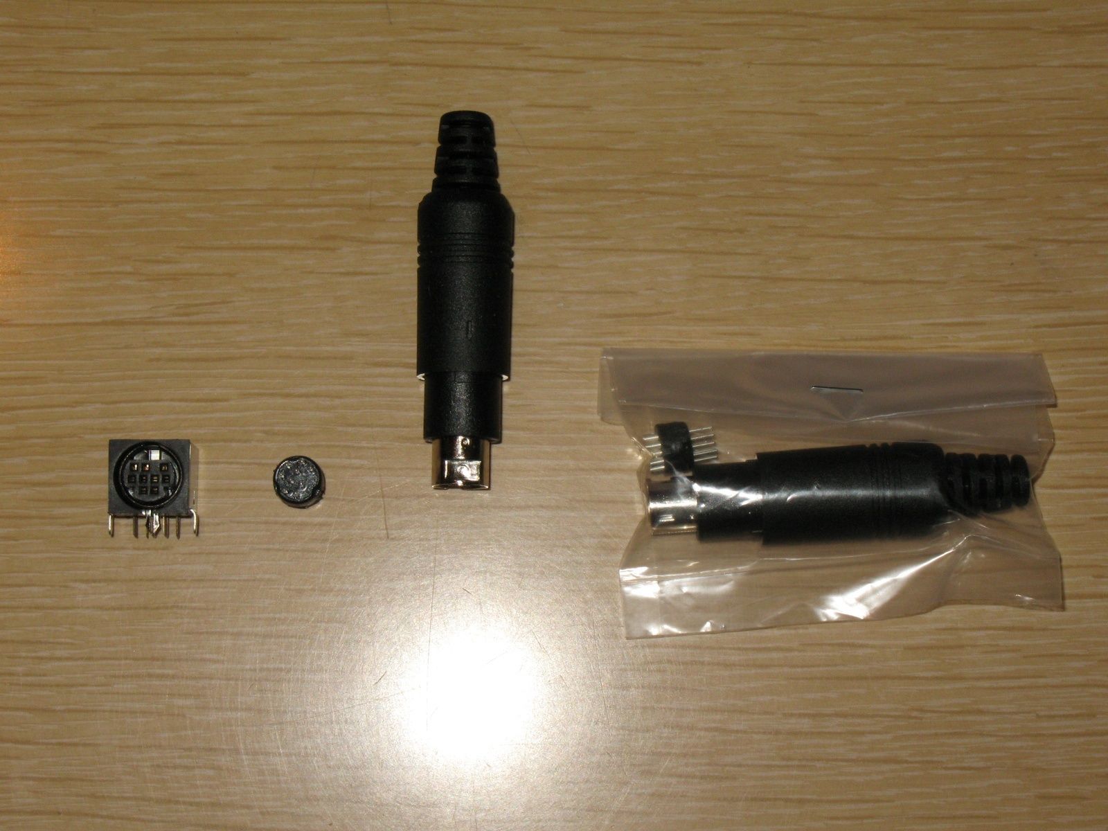

5.1 mini-din
If it's any help, I searched for the 9 pin plug & jack to repair an old PCI video/audio decoding card last year & found these on eBay. Unfortunately I don't remember the seller, but it was in electronics under audio.
The shell is larger(13/32"= 10 mm) than an s-video(11/32"= 8.7mm), which I'm sure you've already found out. I had to ask a lot of sellers to verify, but only the audiophiles seemed interested. Klipsch seems to come to mind.
Here are some pics.

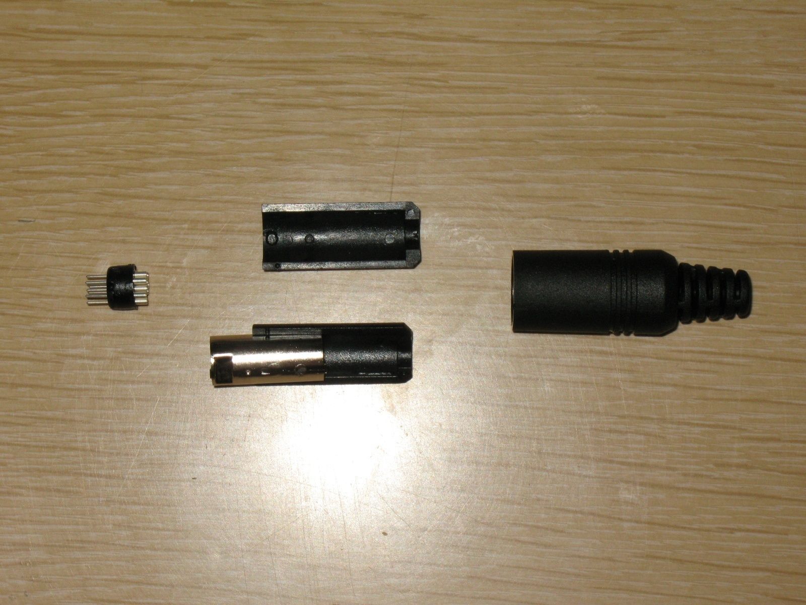

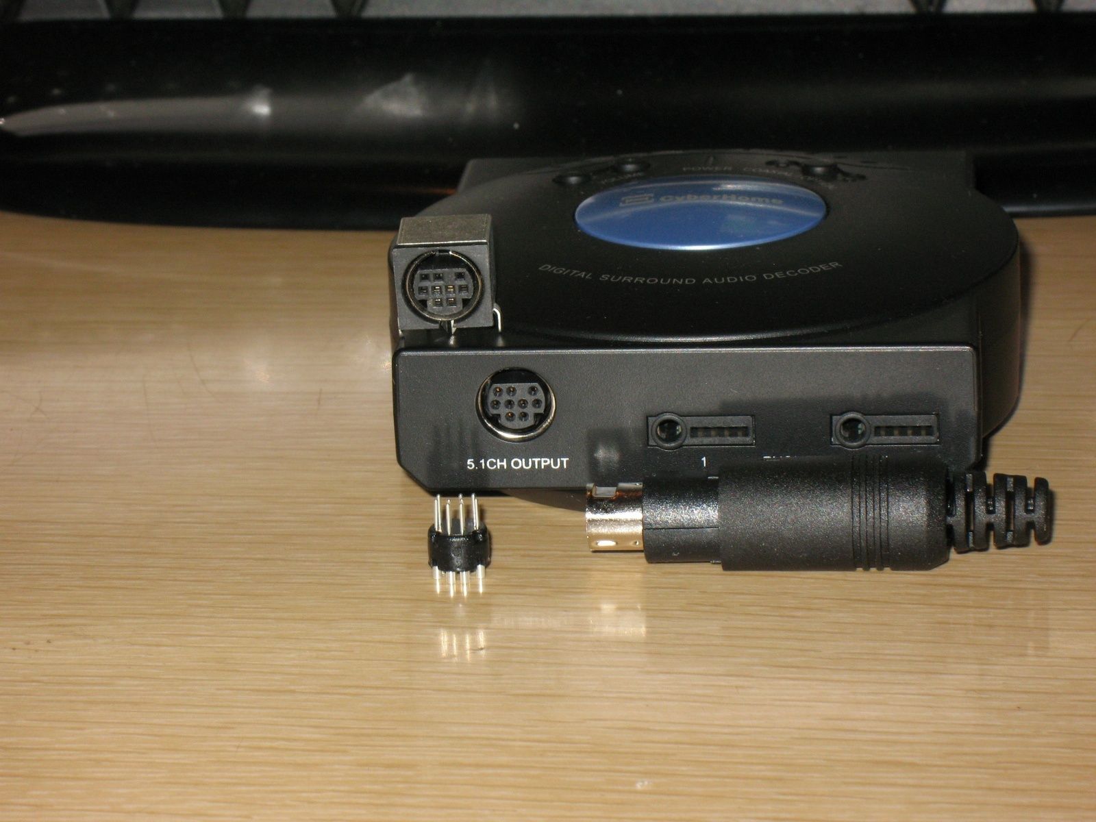

Digikey link for Cyberhome
That is one, but perhaps the optional pin body is different.
