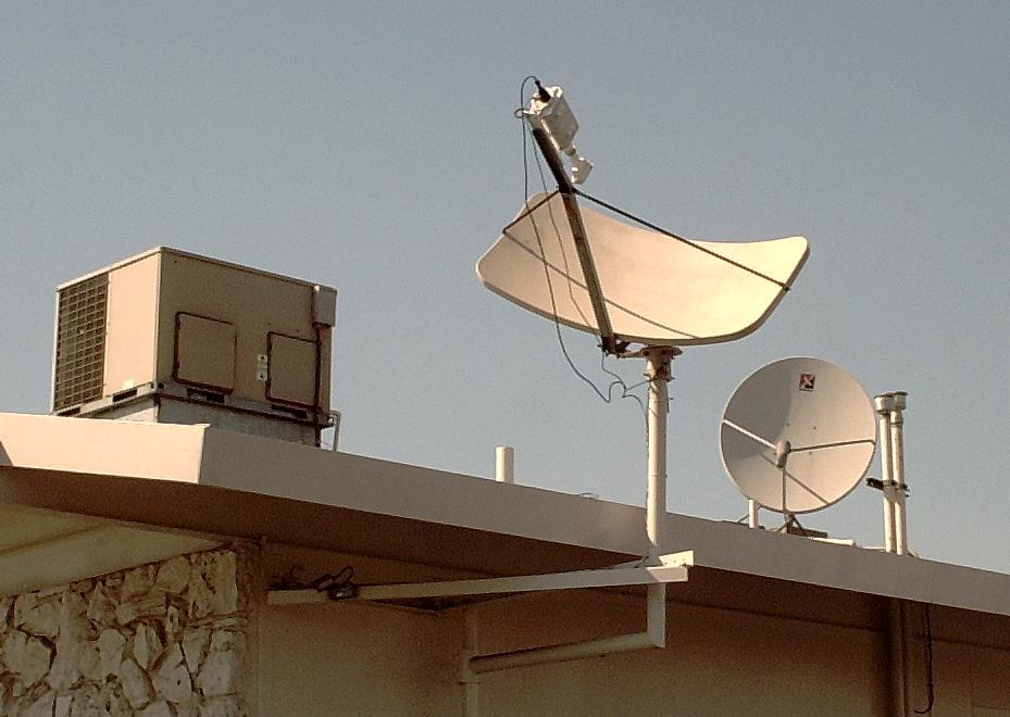

This dish is actually parabolic, and around 4' wide.
It's used for two-way satellite communications.
This one is on a current gas station, and was installed recently.
I believe the particular dish is made by Prodelin.
The round dish to the rear is an Andrew (Primestar-identical) commercial dish of about 1 meter (?)
That's it. Almost identical. It's hard to think that the one dimensional parabola would receive enough signal for satellite communications though. Must be a pretty powerful satellite.

optical illusion:
It really is curved top to bottom.
Think of a four foot dish, with a slice about a foot high taken out of the middle (top and bottom are gone).
The slight amount of curve is hard to see, but I assure you it is a slice of a parabola! :)

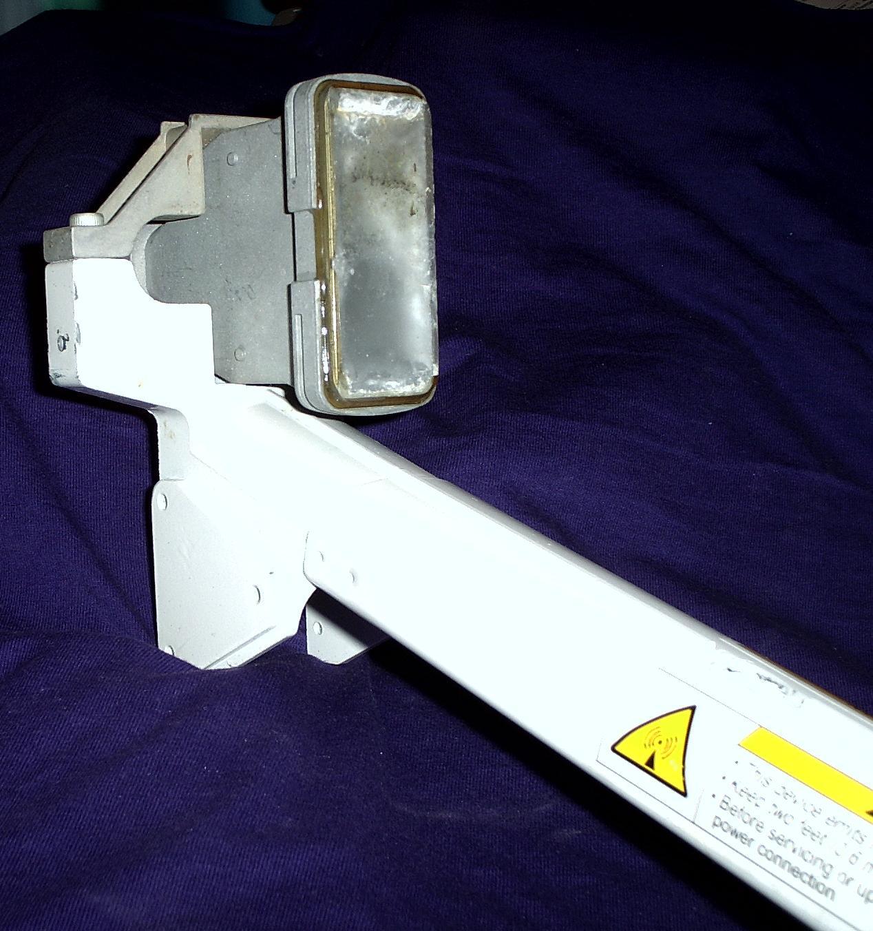

All the energy of the height of the dish is focused onto a feedhorn about four inches high.
Below is a picture of something similar (not the real deal) to show what I'm talking about.
Just don't have a good close up of the feed on the dish I posted above. :)

The four foot width, gathers lots of signal from the desired satellite, and suppresses signals from adjacent birds.
So, for all intents and purposes, it works as well in this application, as a big four foot round dish would.

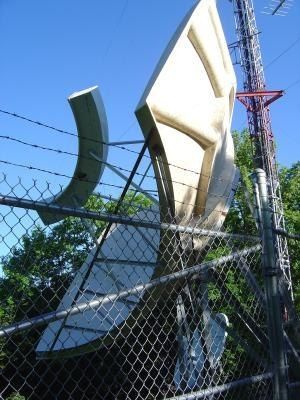

14karat, sorry to read about the dish.. Was your son driving the tractor at night when he mowed down your 10' ?
