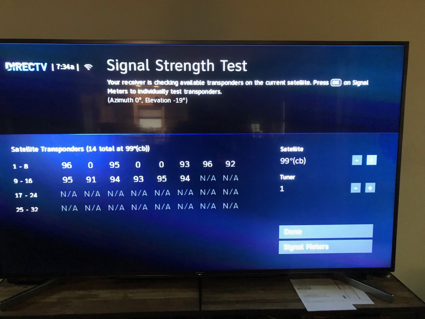

99(cb) slowly coming back.

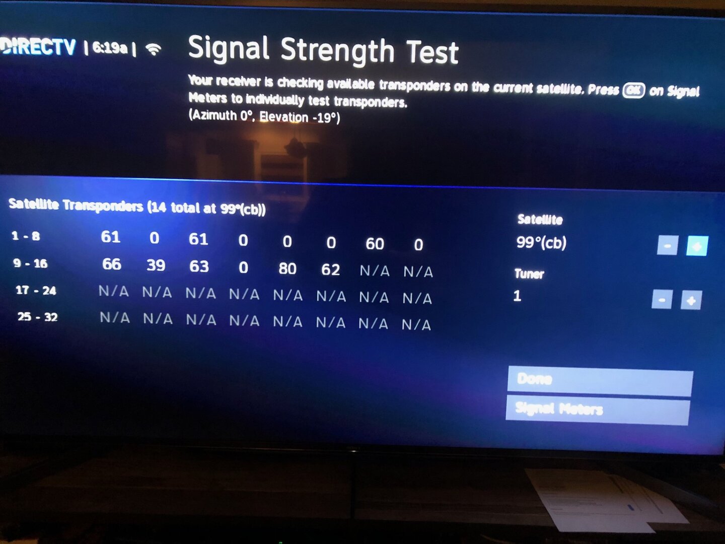

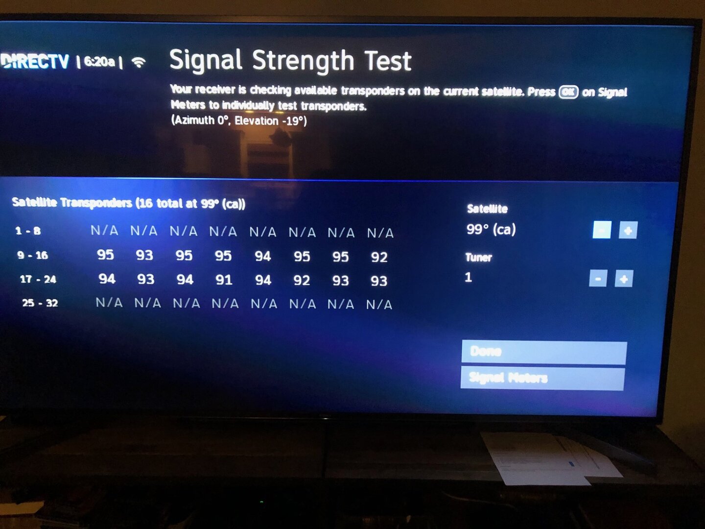

Birmingham ~6:20 this AM
Overcast with pending rain but partial recovery of 99cb

The 99cb TPNs are back to full strength (minus TPNs 2, 4 and 5 which no longer have any channels mapped to them)
The rest of D11's 99s TPNs have returned too
They still need to fix NFL Network, Newsnation and FBN being stuck in PPV mode

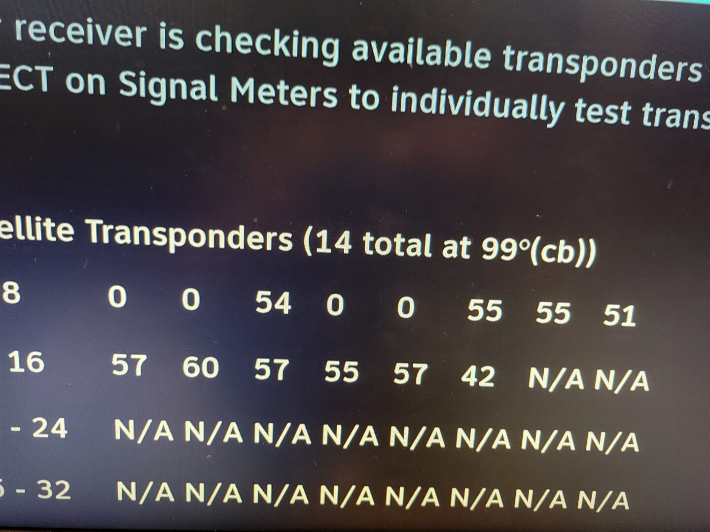

So related to this topic...I'm confused about how the sat signal meters work on a DirecTV receiver. When D11 died, I could obviously see that all the x-ponders on 99cb were 0's...but since D11 also has spot beams, where are those signals shown? Are those then shown on the 99s meter selection? And what about D14's spot beams; are those ALSO shown on the 99s meter selection?

99s does show spotbeam Signal Strength but evety area is different due to overlapping spots.
You would have to have your "baseline" readings to known what is missing,
