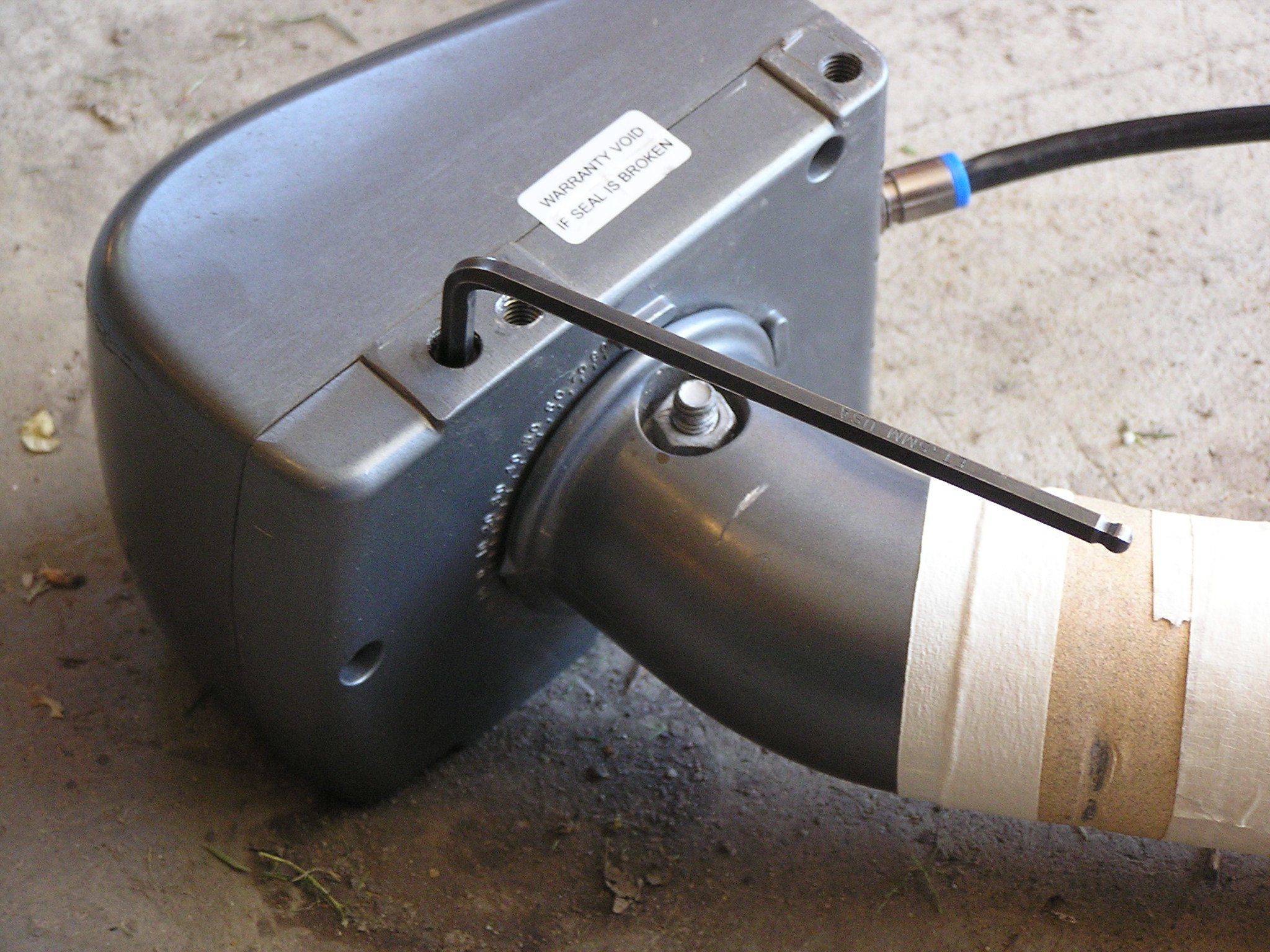

Strange I should see this post. A few weeks back my dish toppled over in high winds. After I set it back up it had about ten degrees of slop in the motor. Like you I was told that it had an automatic backlash adjustment so there would be no way to remidy this problem. I took it apon myself to repair the motor (DG380) just two days ago. What I found was a set screw on the side of the motor that allows you to adjust the backlash. See the attached photo and note the allen wrench I used to reset the backlash. It took about one full turn in on the set screw to remove the slop. I played around with this set screw in and out noting the slop, and set it just to were all notible slop in the motor stem was gone. I then used my stb to move the motor from east to west limit. All worked OK so I re-installed on my dish.
EASY FIX!!!!!!!!!!!!!!

Apparently you can set the initial backlash on the DG380 motor using this set screw. So if you notice a little bit of play in the motor you should be able to correct for it. If you over tighten the backlash adjustment the motor will not move and possibly fault out. So it is a trial and error approach unless you install a current meter inline with the motor. You can at any time back out the set screw to add play to the system.
Looks like a far easier backlash adjustment than the one on the SG-2100s (which are known for motor shaft slack issues)...
I adjusted the screw on the side of my 380 as per Walrus' post and it does take the slop out. Be careful not to run it down too tight as it will lock up the motor. Takes about 30 seconds and the motor has never worked better.
