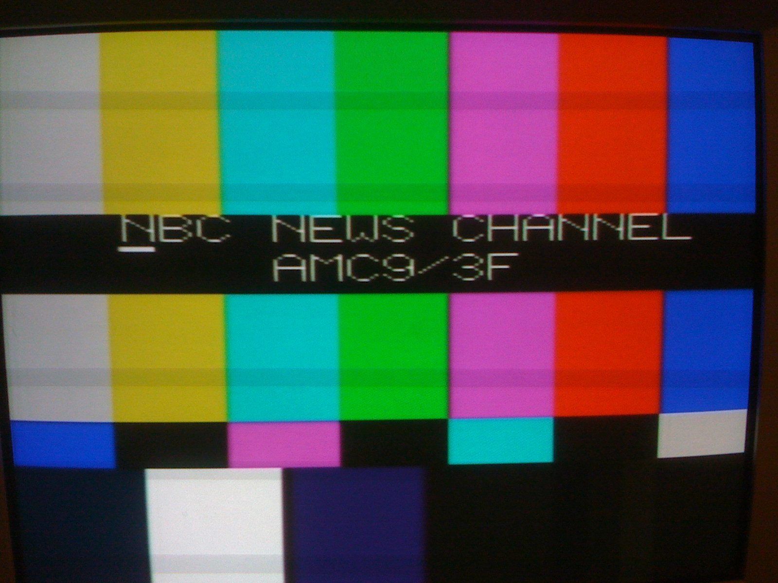

We had some wicked nasty storms come through today and all the satellites went out for a few hours except the one with Nasa on it, that one barely skipped a beat.
White Springs has come back on again and some of the channels on the satellite with "This" TV. I can't remember the name but it's near the White Springs satellite.
Some channels are just showing color patterns and an annoying beep, some are fine, and some are just black.
But RetroTV won't come back on. I can tune it to a channel that says
"NBC NEWS CHANNEL AMC9/3F" with the colored background and the annoying beep. I push info and it shows the signal is 100% and the picture quality is 100%.
But when I try to tune to RTNEAST or RTNWEST there's nothing there.
If I push info it shows not signal for a while then a signal pops in and out a few times. Eventually is will settle down on a signal of 90% and picture of 100% but the screen remains black and there is no sound.
It does that on both east and west channels. :(
It was working ok earlier before the weather got nasty.
I have no idea what in the world is going on, I can't understand it unless they went bye bye. :confused:

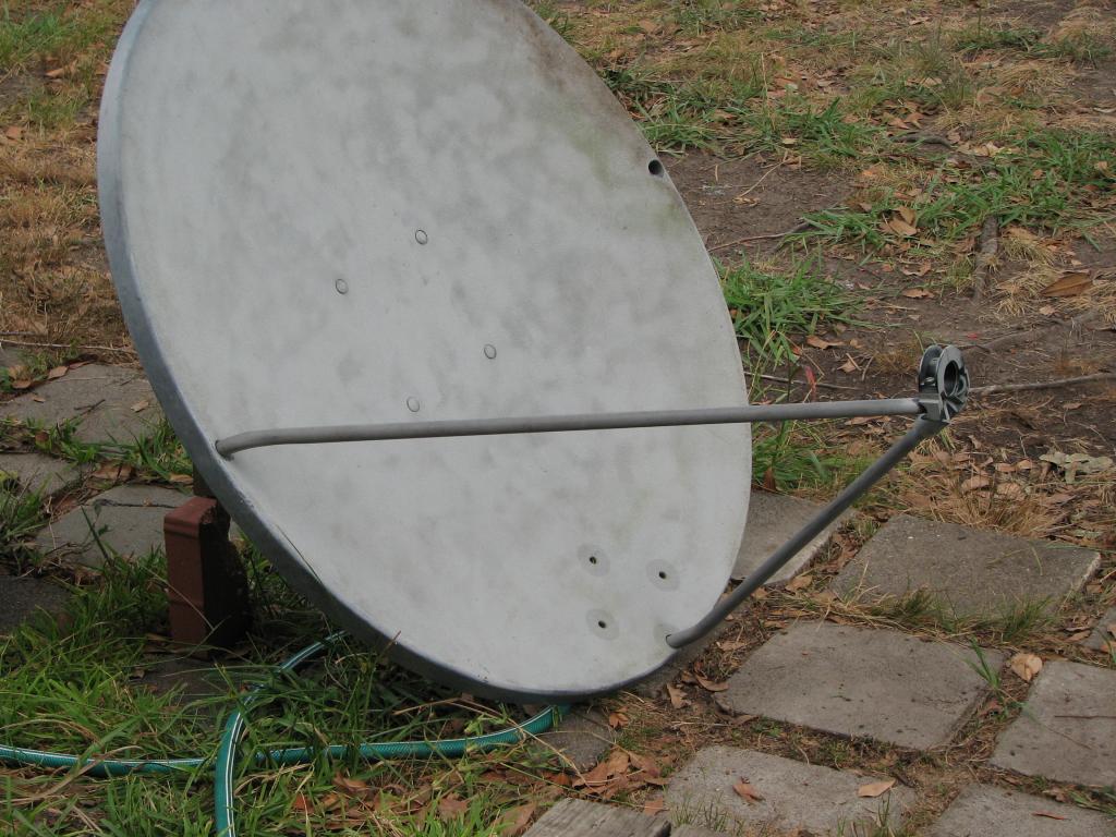

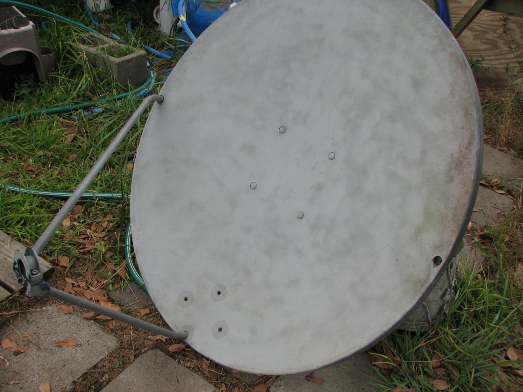

So I found almost all the parts to this one dish that is pretty darn big. Fully assembled I doubt seriously I will be able to lift it. I'll probably have to get some help from Mr. Nice Neighbor.
Anyway, so I got a few pictures of the thing and I am hoping that someone can tell me where I can get a replacement part, one of the tubes on it is missing.
It looks like it's probably the same brand as those other two I have, the smaller potato chip shaped ones. One of the smaller ones say on it's face "Primestar" and another one (the one I have for White Springs) you can tell it had the same logo on it but was painted over.
I'm sure one of the resident experts will instantly know what this one is.
I just hope that someone can tell me where I can get a part to fix it, where that missing tube is. There's supposed to be three of them from what I can figure out. There's some other holes on the bottom of it but it looks like someone drilled those, they don't appear to be factory made.
Sorry for the random wandering in my own topic, I'm just lost and trying to find a solution to this mess.

Yep that would be a good one to motorize, but it'd take some fabbing. There is a place that sells those lnb-support arm tubes, I hope somebody can chime in with the name of the place as I failed to bookmark it!
"fabbing" ? :confused::confused:
Oh, yes! - :up
That would be my choice, as well.
The 1.0 meter round Primestar is the perfect dish to motorize!
It's big enough to do the job quite well, but not too big to be flung around on a motor.
(Primestar is just a defunct satellite company ; the dish was made for them by Channel Master)

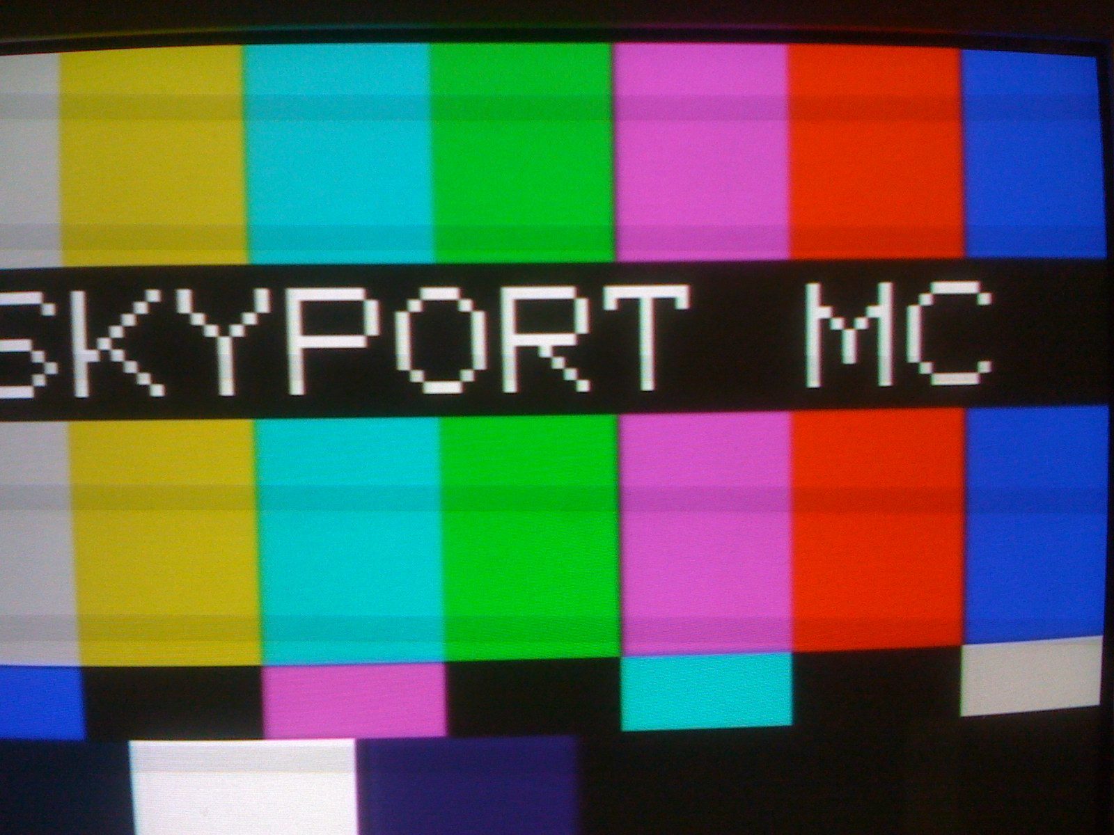

Here are the pattern things I'm getting,
One of them is on a lot of channels on the Galaxy 18 satellite
SatelliteGuys.US - 123.0°W Galaxy 18 Ku
The other one is the only channel I can get on the RetroTV satellite.
SatelliteGuys.US - 83.0°W AMC 9 Ku
It's just odd that that one channel only comes in now and the other two are blank.
They show a signal in the info but that's all.

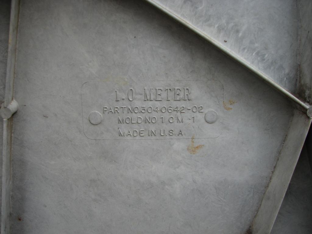

well, I have been googling a bit.
I've had no luck finding someone that sells parts for these dinosaur dishes.
A few places I found were for dealers only and would not let me even see the content of their website or products. :(
But I found a few documents that may be helpful.
I'm still hopeful someone will think of a place that does sell parts.
Here's two documents I found directly related to that big dish.
The back of the dish says
1.0 METER
PART NO.3040642-02
MOLD NO 1 0 M -1
MADE IN U.S.A.
And in the documents, I believe the missing part to be listed as
Item 6
Part 6010100-05
LEG-SIDE-FEED (1.0m)
I'm really hoping someone, somewhere still has one of those.
I'm guessing that without it the dish is pretty much useless.

I scoured around the web and came up short too Dee. Andrew corp owns the CM name , now they're sold as Andrew dishes. But found nobody selling parts,other than lnbs and the mount/bolts. Might be easier to find an electrician (hope you know one) and see if he can take a few minutes and his pipe-bender , and bend you a new support arm. Its standard size conduit, I believe. Couldnt find another place that sold those parts at all, just bolts , and a few of the lnb-arms for the elliptical shape dishes and mounts.
*Haven't got another 1m lying around in the weeds do ya?
It may be easier to find similar dish parts around your neighbors' houses. You may want to post the dish back mount pics to see what work needs to be done to pair it with a motor. Buying a motorized dish set is always an option. Anyway you'll need to buy a good motor and a new Invacom QPH-031 LNB for that whole thing to work as you want. Don't overlook OTA signals, I found OTA to be excellent complement to my Motorized Dish setup. Its also surprising, some local stations aren't available on anything but (free) basic cable, and some only over OTA NTSC signals that are supposed to be cut off by now. ATSC has excellent HD pic quality, its less compressed compare to most sat signals.
Hi Dee,
Glad to hear you got some rain and survived the rough wx. We finally got some decent outflow stuff here for several hours today. I had a rain related Ku dish issue too.....
Anyway, if you want to publish the name of the company/person that made the accusation, I'd be more than glad to take a bite out of his butt. That is nothing less that cohersion, and an attempt to take advantage of a female AFAIC. If this person, or his employees are truely so uninformed as to make such allegations, I feel the least that needs to be done is enlighten them to their apparent ignorance.
As to parts for your Primestar, if the arms that remain are not bent and needing the other support for alignment, it is likely a cosmetic issue. Unless you intend to hang a bag if bricks from the thing two should support an lnb w/o issue. If the assy is still rigid with just two arms it will function but look odd. As posted, a piece of EMT (electrical metal tubing, aka thinwall conduit) probably 1/2", bent with an electrician's "hickey bar" should be "fabbable".
Fabbing = the act of fabricating, (creating, making, building from raw, usually metalic materials, etc....yeah, it's a guy thing....lol)
You might even find an electrician that you can get interested it the hobby and barter for some of the other equipment you have to liquidate.
First, I'd check if the two arms are as secure (unmovable) at the pioint where the lnb mounts as it would be if there were three.
This is odd.
RTNEAST now says Provider: TandbergTV when I press info.
There is now one of those color patterns in place, the signal is showing to be 100% / 100% and it's making that horrid, continuous beep.
There is no text on the screen like the other one that says NBC something something (see previous picture).
RTNWEST is still black and silent and it still says Provider: RTNWEST under info.
It says the signal is 100% / 100%.
Oh, and it also says this, 11735MHz 4444Ksps Horizontal (for the west)
and for the east one it also says the same thing, 11735MHz 4444Ksps Horizontal.
The other one says 11775MHz 4232Ksps Horizontal
AMC-9/3F Provider: NBCNC Satellite Operations
and it's 100% / 100% on it's signal.
So it looks like to me that RTV did go bye bye.
