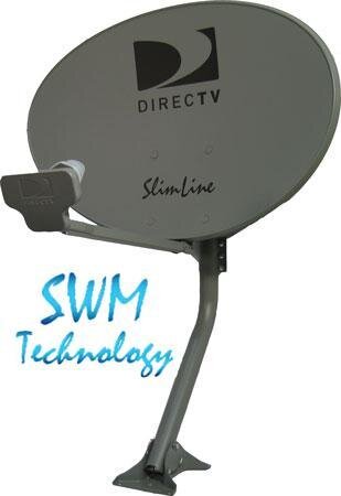

The Slimline-3 AU9-SL3-SWM_4_zoom.jpg and Slimline-5 AU9-SL5-B_zoom.jpg are the only dishes that can pick up DirecTV's HD signals other than the old original AT59_zoom.gif, the Slimline-3 only has 1 pod and the Slimline-5 has 3 pods but they are different sizes, oval, small round, large round.
You are describing this Phase-III dish and it is Ku band only and will not get any of DirecTV's HD channels as of over a year ago now. At one time (over a year ago now) DirecTV had just a few HD channels on Ku band like 1 HBO, 1 Showtime, HDNet, and TNT but that was it and is gone now.
