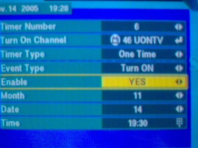

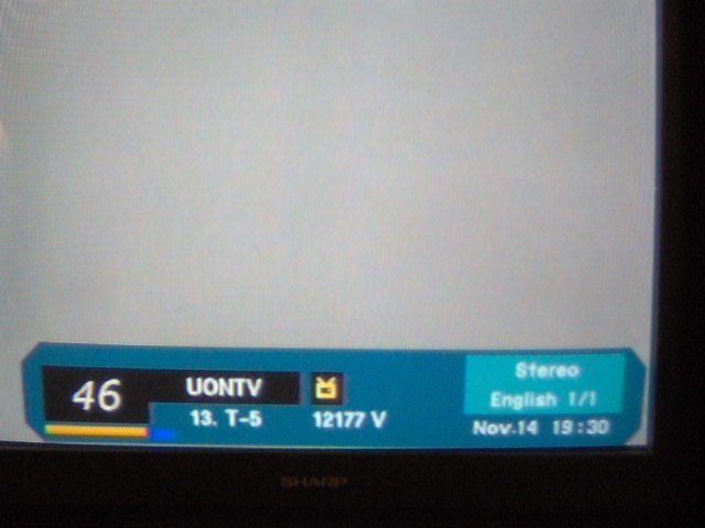

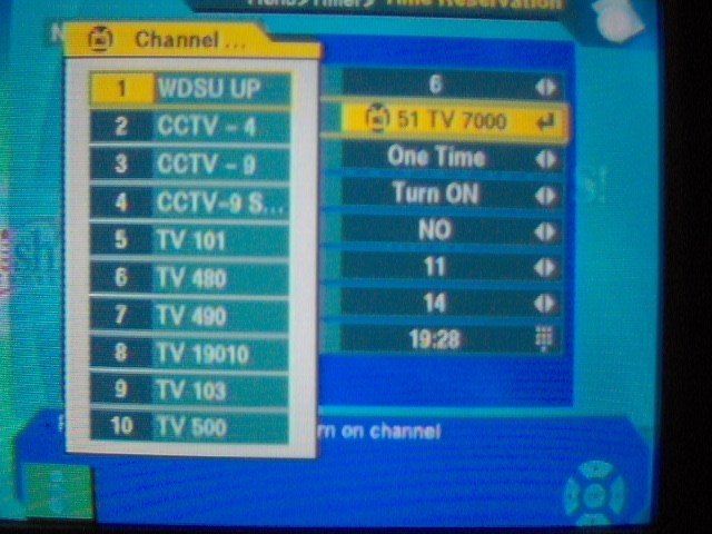

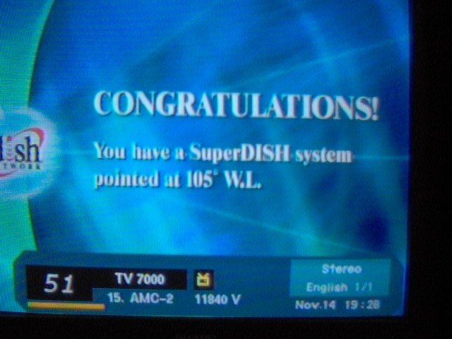

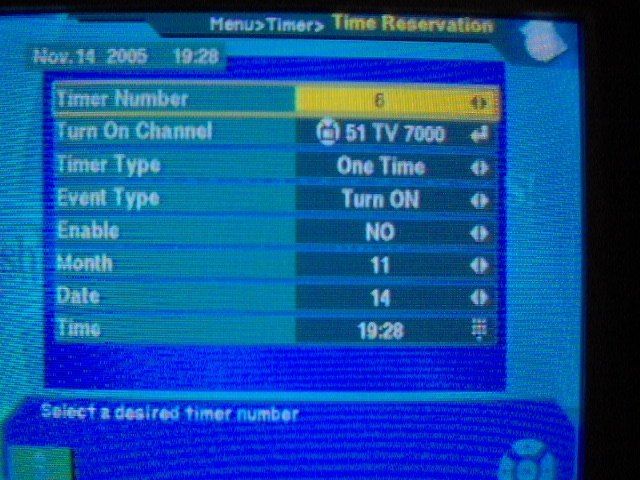

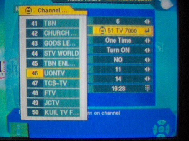

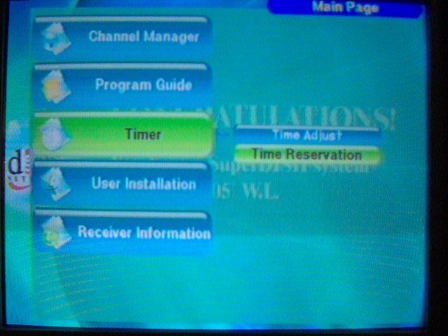

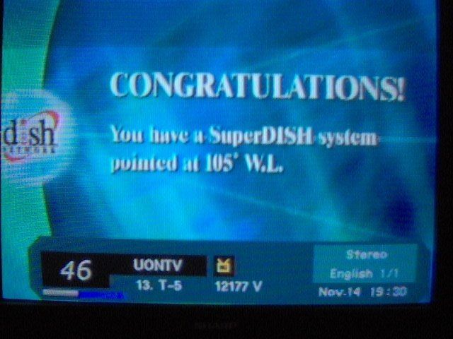

Below are some screen shots. I was on Dish 7000 (SD 105 test card) and wanted to program it for UONTV...below is how I set it up

Thanks for those pictures...
I used the Timer feature now couple of times.. (setup a couple of timers .. to change the channel to another channel mostly) .. and this time - they worked OK :)
