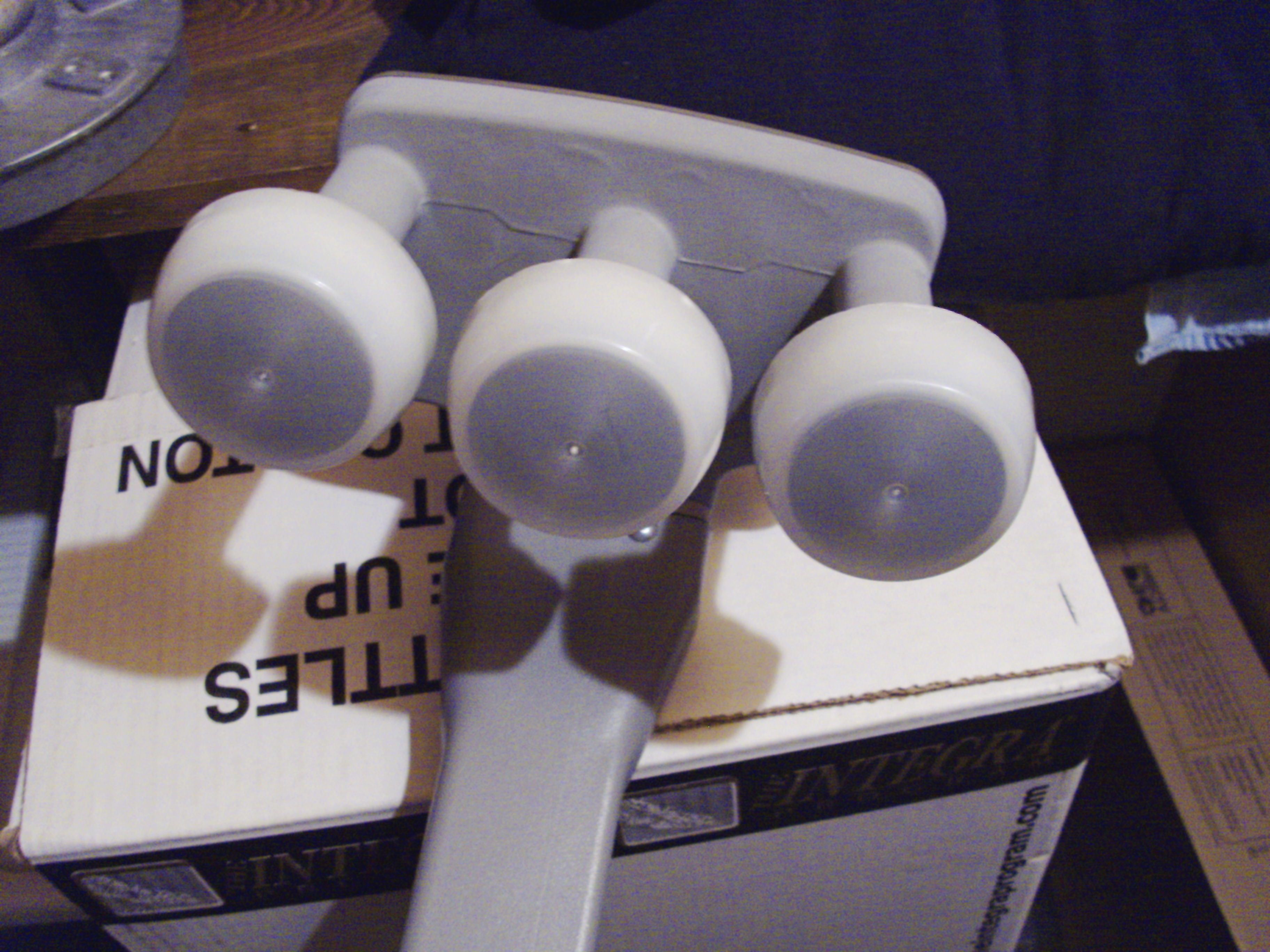

I have a 3-LNB"18x20" it had two inputs and 2 outputs to the switch then I added another receiver and switch, a 2X4 Multiswitch with 950-1450 MHz. My zip code is 87035. All tv's need to either watch local channels or cable channels. When the tv in the first receiver out put changes from local channels to cable then the other tv's switch from local ABC turns into VH1, CBS goes to GSN and NBC goes to Direct TV Cinema, but once all tv's are on cable they can all watch different channels. Very frustrating and confusing as to the problem. Do I need to add a special ground wire?
I have a 3-LNB 18"x20" dish. The connection had two cables from the dish to the switch and two cables from the switch to the two receivers. I got another receiver and wanted to add that receiver to my satellite so I purchased a 2x4 Multiswith, 950-1450 MHz. My zip code is 87035. When all the tv's are watching local channels things are great, or when all the tv's are on cable channels things are also ok. When the receiver that is connected to the r-1 spot changes channels from local to cable and the other tv's are on local then things go funny. If you are watching ABC it has the picture and sound of of VH1, if you are on NBC, you get the picture and sound of Direct TV Cinema and if you are on CBS you get the picture of GSN and sometimes the sound of the local channel. If all the tv's are on cable channels then they all can watch whatever cable channel they want without any problem. This is very frustrating and confusing, I was wondering if I needed a different switch. Please help with a solution.
OK...on the dish itself...more specifically the LNB (eyeballs)
is it one giant piece of plastic with 3 eyeballs on it or can you take them off separately?
If it looks like the pic below that is a Phase III dish. The 4 coax on the LNB you can hook each receiver directly to it. You do not need a switch.
Unless you have one of the older Phase II dishes that had a external switch all you need to do is remove the switch from the setup and hook the 3 cables from the receivers to the LNB
It looks just like the picture, but it only has two cables coming out. Do I neet to remove the eyeballs and add another cable for my third tv?
