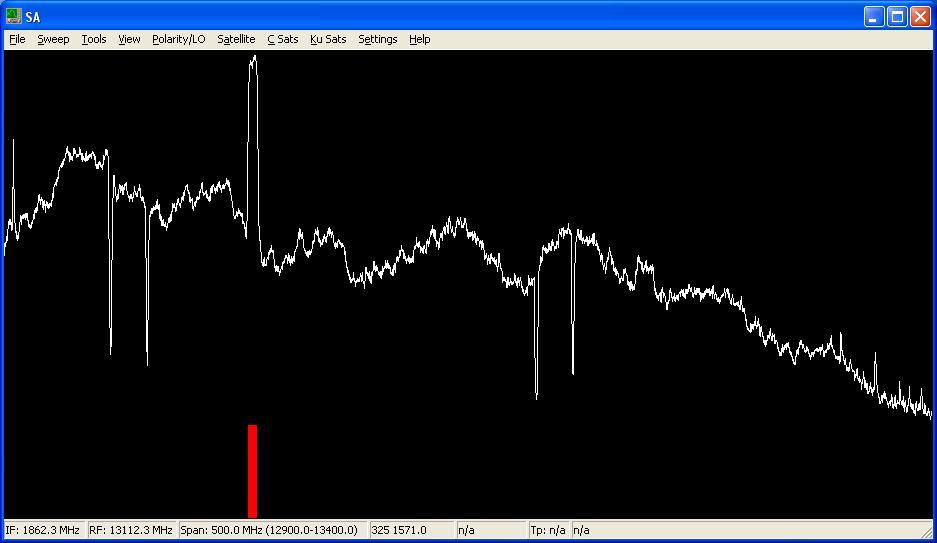

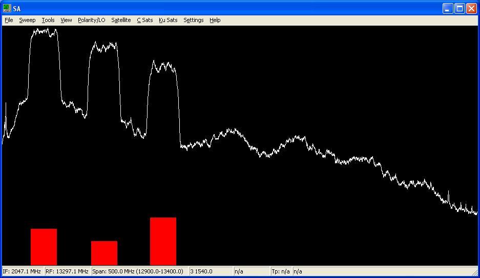

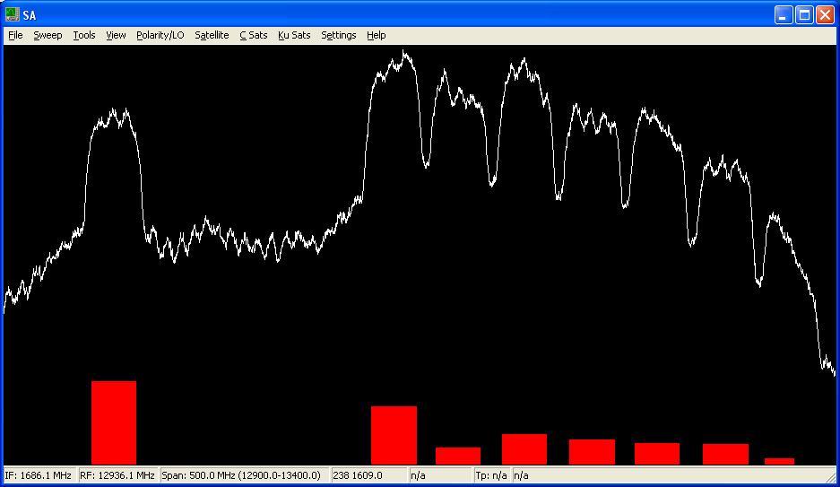

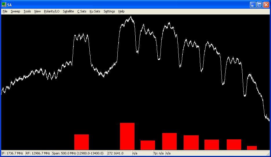

There are spectrums for 103(a) and 103(b) at Pacific Coast.

My guess (and its only a guess) is that the spectrum analyzer is indicating that there is usable signal(s) there, but that our end user systems have not yet been told (via update keys in the stream) to allow us to see anything.
