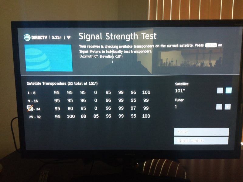

Here's an updated signal reading
Other sats are between 70-90 while 99s and 103s are N/A
If your numbers are as low as 70, you may need to have your dish realigned. Also, you should have a reading on 103s t15 and t23. That's where the Boise locals are.
My mistake, I am picking up signal on those Transponders but I am going to talk to my apartment landlord about getting the dish realigned as some of the transponders are in the 70s
On the 103s t15 and t23, and all of the other satellites, you should have numbers in the uppers 80s at the least, except the ones on 101 we have already discussed.

Are these settings ok on the 101?
1-8 - One 64
9-16 - One 0
17-24 - One 0
25-32 - One 76 and one 0
All the rest are upper 90's and 100's.

No, the power on the "HD side" will remain the same. The reason it is somewhat more susceptible to rain fade is because Directv is currently using a higher frequency for MPEG4 HD channels than they do for MPEG2 SD channels (i.e. Ka vs Ku) not because they are using less power than is allowed. If they move some HD channels to 101 then those channels will become less susceptible to rain fade, but we don't know if that's the plan.
BTW, people should quit posting their 101 and asking if its OK. 101 doesn't matter, post your 99ca/99cb/103ca/103cb. Those are what matters. If you have good readings on those then you know you are fine on 101, but it is quite possible to get pretty good readings on 101 and still have a lot of room for improvement on 99/103...
