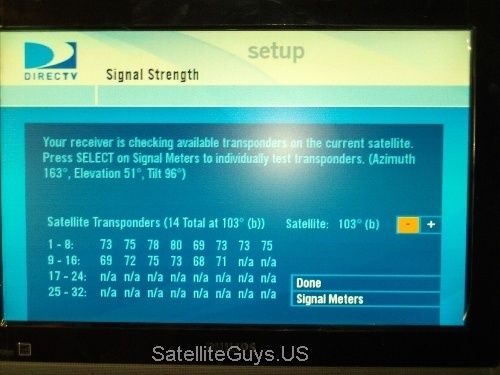

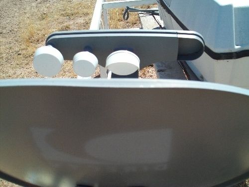

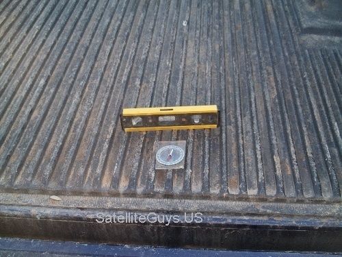

I was playing around today with my camping Phase III dish, I found that the LNB from my AT9 would fit, so I swapped LNB's and set the Phase III on my Tripod and hooked to a H20 I had brought out to my Camper... with no tweaking I got good signals on 101 & 103b... (nothing on 99b or 119 and of course did not get all channels) I did move it slightly and lost signals... will have to play with it more, but this looks promising...

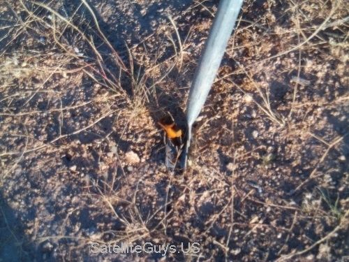

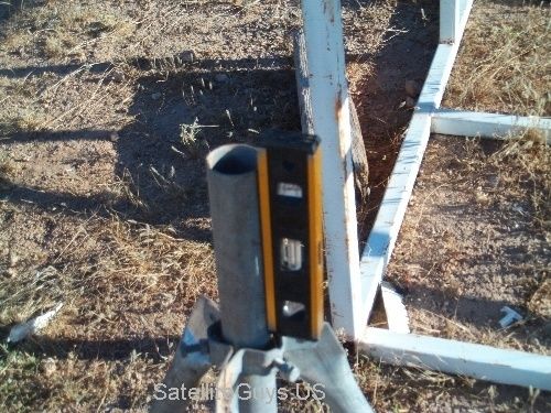

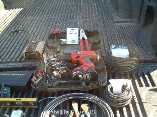

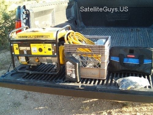

Essentials I take with me when camping ...
There have been a number of experiments involving use of the Phase III dish with Ku/Ka LNBs. The mounting arm apparently needs to be modified to get a reliable three satellite view.
Note that due to the size of the reflector, this is largely a fair weather endeavor.
hint - it works even better with an SL3 :) (assuming you don't need 110/119)

Get a new reflector bolt in there and retest. I've seen some serious issues where something didn't work because the reflector bent from missing the screw. It could account for the slightest move/lost signals.
