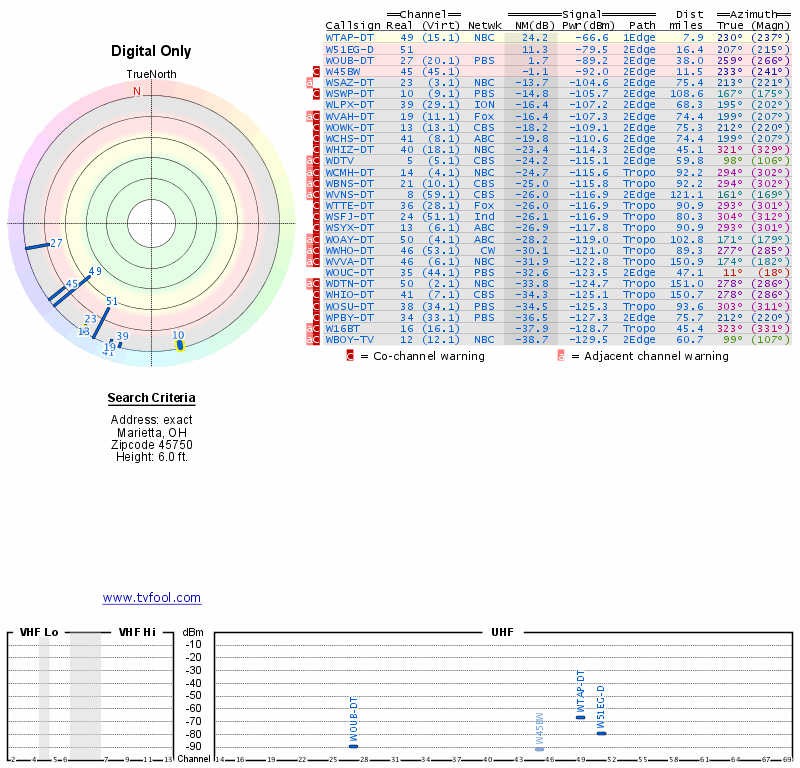

My zip code is 45750 and only get one local OTA Digital channel from WTAP.. I can't just get a simple antenna? I have one here that I hooked up to my AM21 .. it was able to receive information on the channel's 15.1 15.2 15.3 which I believe is all coming from the same location and the information but not matter what I do with this antenna I get no signal strength.. if I have to shell out more money on this I don't think I'm going to bother just to get NBC.. What the heck do I do here?
Also if this makes ANY sense .. have a look!!
