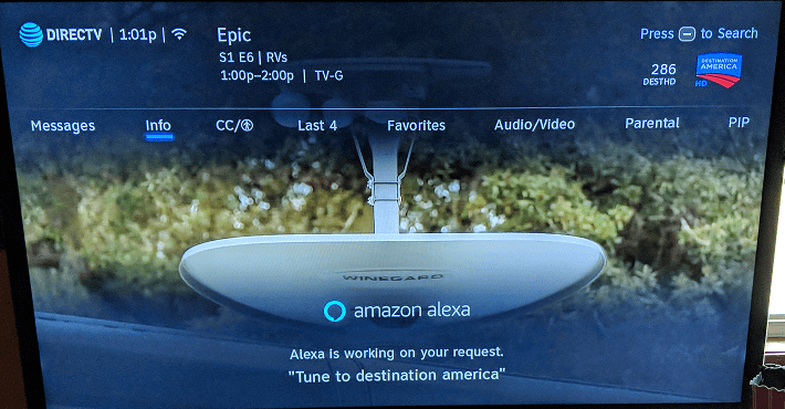

Below is the picture with the graphic that gets thrown up when you use an Alexa command to control a DirecTV receiver. Purely coincidental that I took it about a half an hour ago during the intro of a show that shows a Winegard Slimline 5 DirecTV dish for RVs. :D
