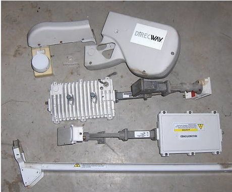

Just to clarify, the lnb that I posted from mclean surplus is for the rectangular feedhorn BUT does not directly bolt to the feedhorn itself. As you can see in attached picture, it bolts to the back of the tube assembly with the feedhorn bolted to the other end and the transmitter bolted onto the bottom.
I have three of these, one on my Motosat system, one on my dish used when a campground has too many trees, and one extra arm with lnb and transmitter in case one of the other two go bad.
Chuck
