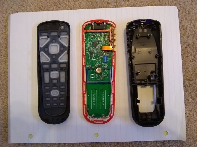

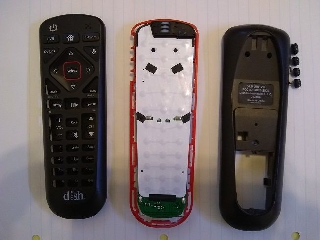

Wasn't easy for sure. None of the cell phone type opening tools worked and I have a all of them. Basically this remote wasn't designed to be opened, it felt like it was glued shut and that was after removing the two small Torx screws from behind the back cover. It had at least 20 of those very strong latching snaps. The only way to pry it was to stick a fairly large screw driver through that orange spacer which is NOT a simple trim and in the process break at least a couple of these snaps. Once you are able feed the screwdriver in then slowly you can separate and open it completely. I have taken apart many remote controls and this one is of the best constructed mechanically and electronically. All the buttons are actually tactical switches, none of these crappy carbon coated rubber dome contacts. Sorry I forgot to take some pictures.

I had to disassembling one of my 54.0 remotes again and this time I took some pictures.
