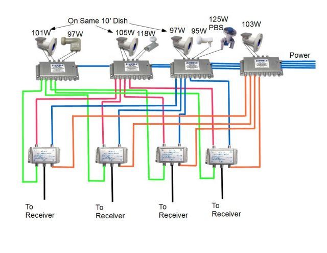

This setup works fine for me, same receiver:
Zinwell powered multiswitches and chieta diseq switches
and LOONG cable runs too. Not sure why it wont operate a single diseq for you.
Im using the Diseq1.0 settings in this case.

WOW!. Yea, I'm sure it would work. Only prob. Both LNBS are single output on my corotors. I'm looking at your 125 PBS feed however. Is that single feed, single polarity? I've not got the second BUD or the 36 inch (soon I hope to be 6 foot) offset hooked in at all. Would really like to use those for 58w to 30w anyway.
For G19, I can use the other receiver on another tv input for the time being for DVB-S signals BUT I can get the handful of stuff I watch off of G19Ku on the current C/KU bud. Just have to keep swappin' leads...Painful...
