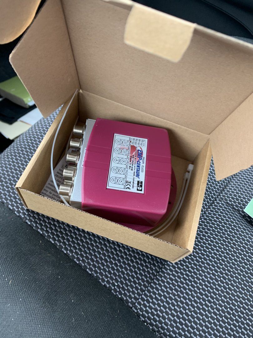

Was wondering if anyone knows of a DisEqc switch that has an OTA antenna input and also a splitter to use inside that will split off the FTA (to rcvr) & OTA (to TV) signals.
This one has a terrestrial input, but I think it would only work with a receiver that "knows" how to separate the OTA feed from the satellite feeds..

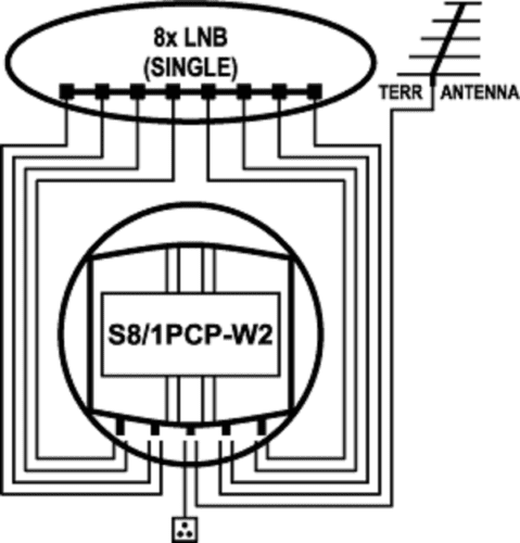

EMP-Centauri brand
9in/1out 1.1&1.2 switch for up to 8 satellite positions and 1 subscriber, equipped with combiner for terrestrial band. It is designed for switching between 5 to 8 LNBs. Control mode is configured using built-in DIP switch, see Instruction manual for details.
The product allows joining terrestrial band to common downlead.
HDTV and UHDTV compatible
Parameters:
Frequency range
LNB inputs 950-2300 MHz
Terr. input
5-862 MHz
Output
5-2300 MHz
Control
DiSEqC 1.0, 1.1, 1.2 commands
Insertion loss
Sat. 5 dB avg
Terr.
3 dB avg
Sat. inputs isolation
25 dB min
Power consumption
From receiver 50 mA (18 V) + LNB
DC current pass
400 mA max
Dimensions (w,d,h)
11.2 x 11.2 x 4.8 cm
Temperature range
-30 ~ +70 °C
