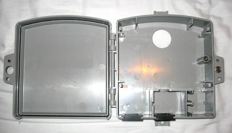

Whatever you get, I'd recommend a HEAVY DUTY Weatherproof box with neoprene gaskets like this one.
These were commercial DSL/fiber optic service entrance boxes that I got from a failed dot.com. They have a design life of up to 25 years, like the ones that the telephone companies use. They have both pole and wall mounting lugs.

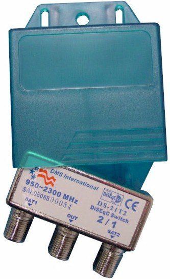

I have had my 2 way switch WAY up there in the open for around a year now with no problems! Dielectric grease only! This way water just runs right off.
They do come with a cover now (see below) but I have not used one on my 2 way!
