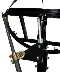

Here's a pic of the RETAIL plate attached on a mount.It's the triangle shaped thingie that the actuator is bolted to:

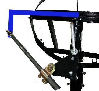

To minimize the tendency to flop, make sure that the motor is mounted on the side of the mount that has the lowest satellite elevation in the arc. If the satellites are lowest to the horizon on the east side of the arc, mount the actuator arm on the east side of the mount. If the west side of the arc has the lowest elevation satellite, mount the actuator arm on the west side of the mount. If the lowest satellite elevation is the same on either end of the arc, place the actuator arm on the side that has the prevailing wind load.
To increase count resolution between satellites and allow the dish to cover more of the arc without flop, bolt or weld a "L" bracket similar to the this example blue "L" bracket onverlayed on armadillo_115's photo.
L bracket huh? That's interesting.I was going to extend mine with just a straight piece of angle iron... but was afraid that would require a much longer actuator to swing it thru the arc.If a straight extension doesn't work,now I know what to try next.Thanks Titanium!
I will try a straight one first because the attachment points are sooo close on my dish.I have to clamp near the end of the actuator.Will that still help on the flop problem?

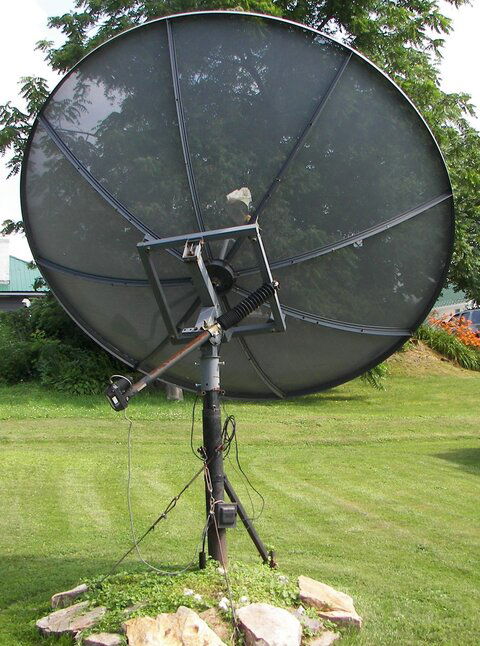

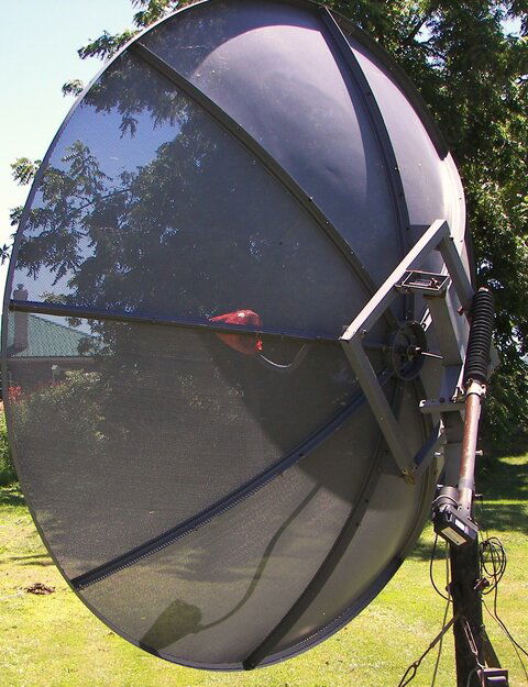

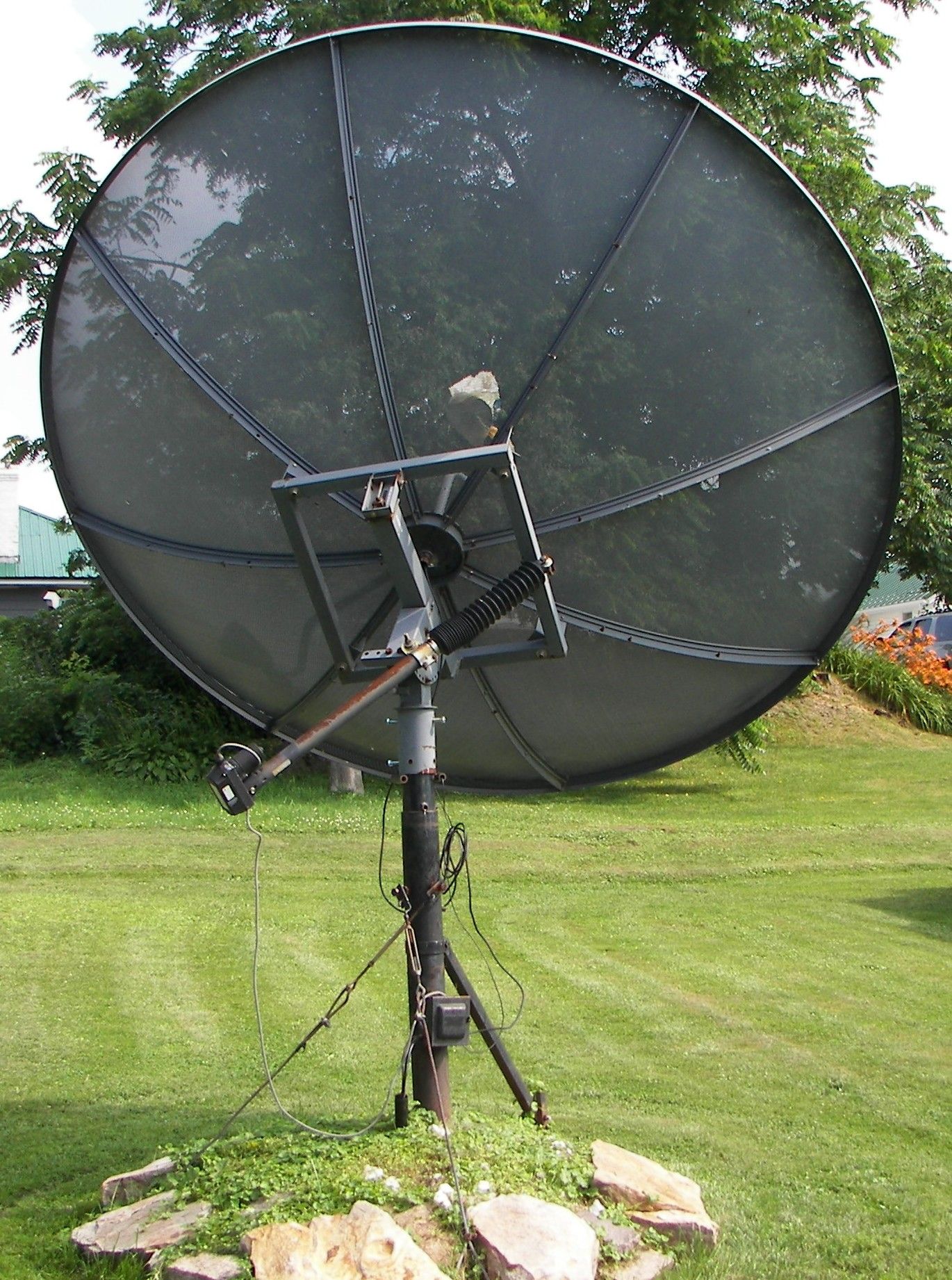

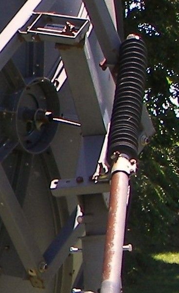

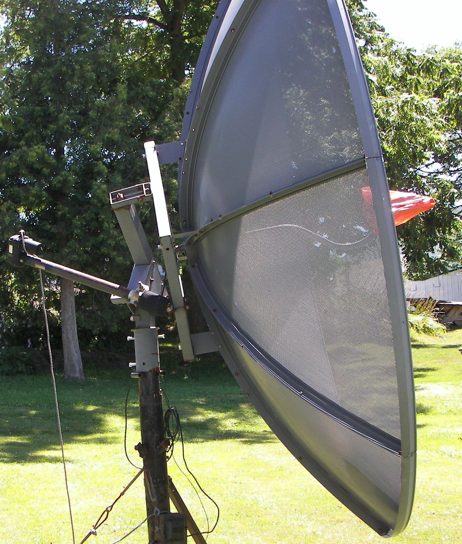

How a 10' Winegard Pinnacle does it;
24" actuator but an 18" would have been plenty.Of course for me it's kind of pointless as everything to the east side is pretty much blocked by trees and buildings.
Reactions: norman881
A straight extension will add counts, but doesn't significantly change the angle in relation to the pivot point. The "L" leg shifts the angle away from the pivot to provide increasd push/pull range before the flop.
