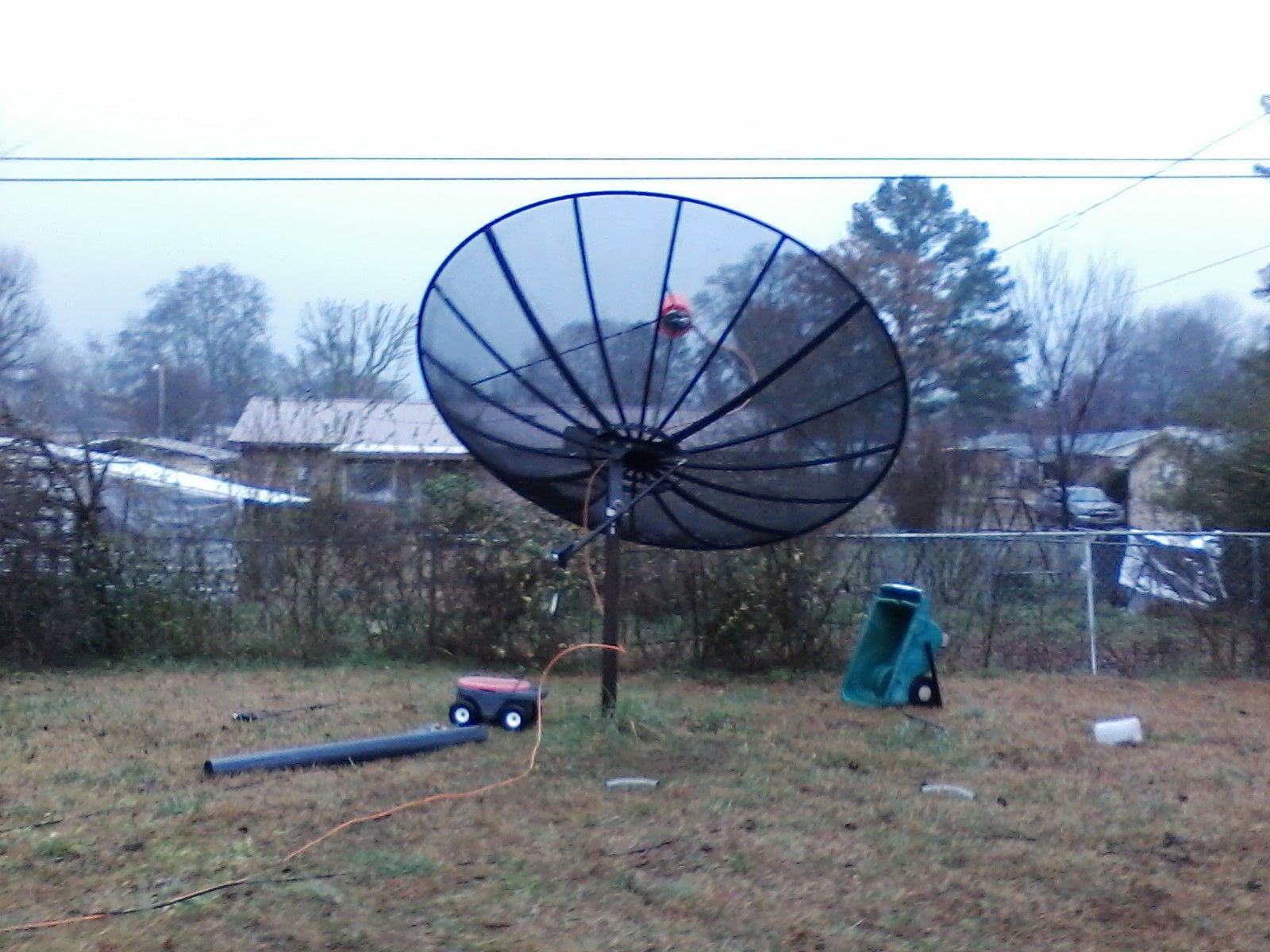

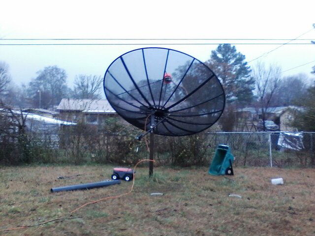

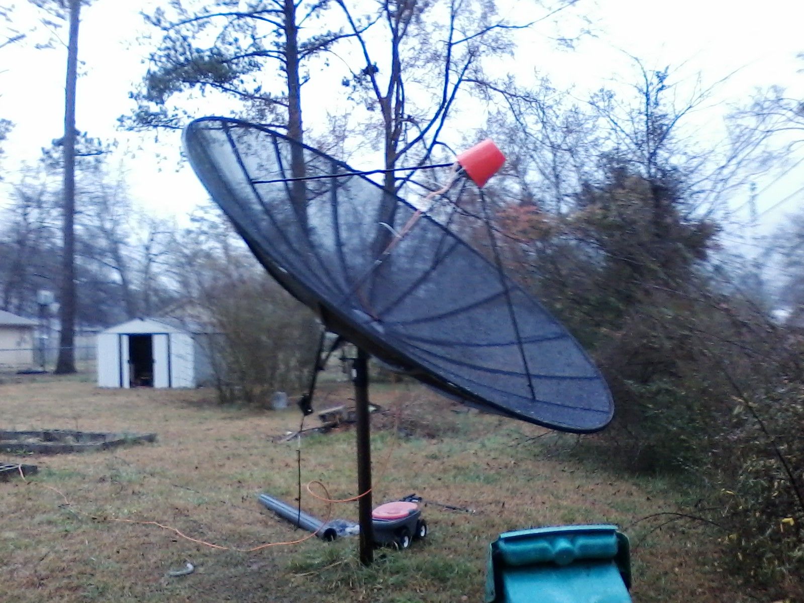

Photos of my new toy up and running! It's rainy here, so the pics aren't great.
PLEASE NOTICE THE HIGH TECH WEATHER COVER. THAT BABY SET ME BACK 100 PENNIES AT MY LOCAL DOLLAR TREE STORE. LOL!

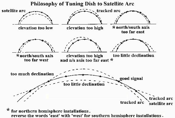

What about the declination aspect? I was using this picture below to fine tune. I'm just curious, as I am still in the learning process and know i have some axis and/or declination adjustments to make.

If re-adjusting the azimuth is necessary to maximize Quality readings on the eopposite side of the arc
Tranfer the mount mark to the pole You should now have 2 marks on the pole for the one mark on the mount. The difference in the two marks on the pole are because the declination is off slightly.
Can someone explain the 2 marks? I understand one mark, when you moved the azimuth and then penciled between the mount and the pole.. But, where does the 2nd mark come in???
For the second mark, transfer the mark on the mount onto the pole, if it's no longer aligned with the first.
Okay, so let me get this straight. Your twisting the mount on the pole on your farthest EAST. Mark it at PEAK. Then farthest WEST if you need to twist at all to peak, then there is your second mark, which means your declination is off..
DId i understand that correctly??
The objective is to get the AZ adjustment 'peak' for the E and W to occur at one point. This will occur between the two marks on the pole. When that happens, you're perfectly tracking the arc.
Do you know when to increase or decrease the declination
Wish I could remember that. Haven't really used it since BITD. Been trying to do 3d modelling in my head to no avail.
But if the E W az peak points move further apart, you've adjusted the dec in the wrong direction.
Reactions: iBoston
Fatair can do 3d modeling in his head! I think I only have a 2d head, lol. That dish should be tracking if it's got a good shape, the elevation is fairly close to correct, and the declination is set. That picture in the prev post shows the declination thing pretty well, it's all about lining up two semi-circles, one in the sky, and the other on the ground (track of this dish matching curve of the satellite arc.) Easier to do than to explain, of course. Mine 10' dish hasn't been adjusted in 12-14yrs and still tracking very close, but I'm still not 100% sure the declination is right as it could be. I'm afraid to mess with it though, long as I get good signal levels on the c-band birds, and that's all I use my big dish for nowadays.
