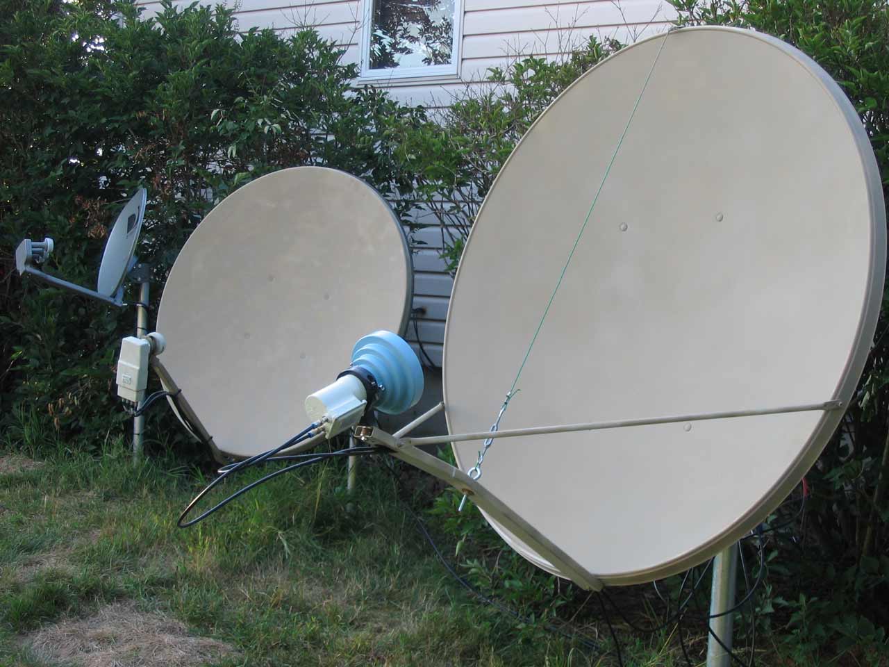

Note the pic, the turnbuckle arrangement to bring the Fortec 1.2M into the sweet spot for the lnbf.
