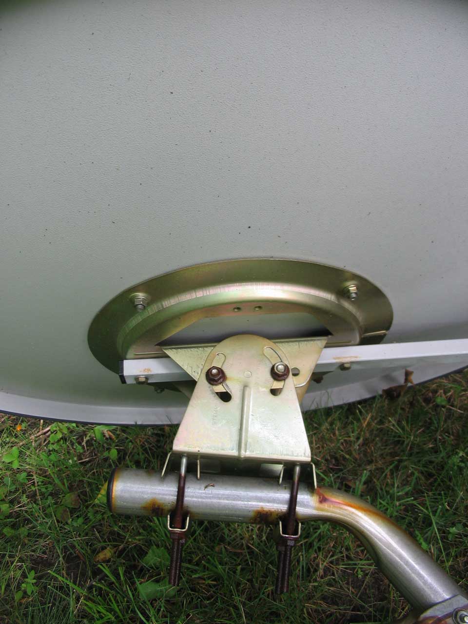

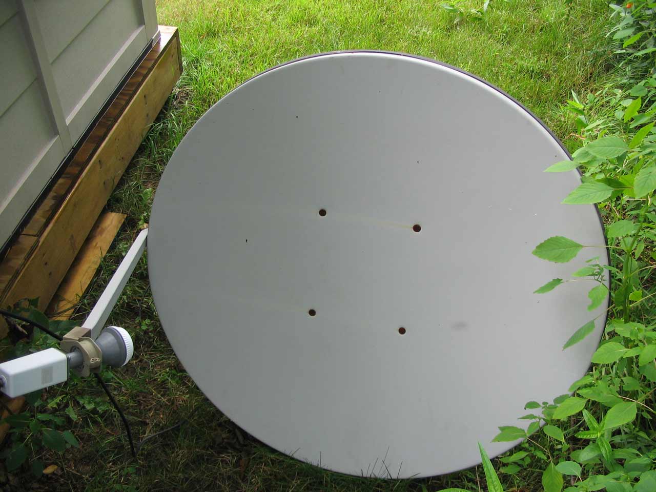

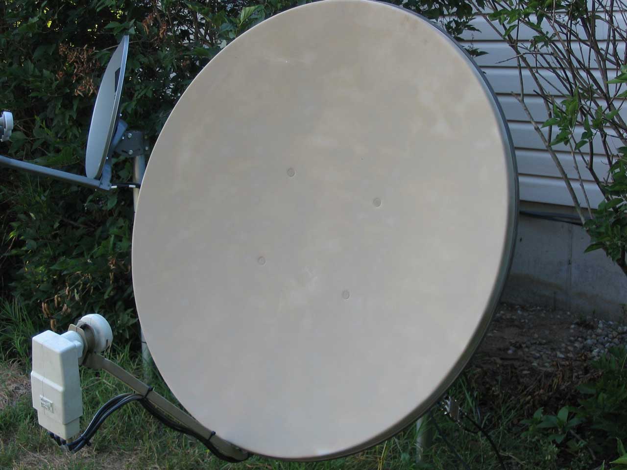

Here's 3 pics of my first free decent dish. It's a solid 1 meter, and was sitting in the parking lot of my favorite hardware store. Fell off the house next door ( was dangling by cable).
Can anyone identify, I suspect it's a classic of some sort, and will replace my 90cm Fortec, I think.

It's solid enough. On the dish bracket it explains that the bolt is the elevation point, and that the increments are each 5 degrees. It should definitely be an improvement to my 90cm Fortec dish. I have a 2 year old SG-2100 that I'll put into service again, and see if it'll move it. Already have it re-painted with camouflage paint .
I've got a BUD with a round backing plate like that, but never saw one on a little Ku dish.
I'd say it was commercial, based on the feedhorn and the single polarity LNB (as best I can tell).
You did well !

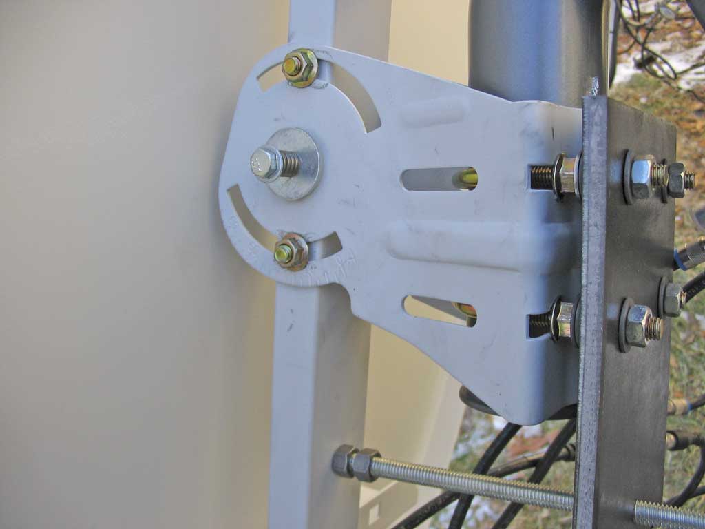

I may be able to move my 1.2M adjuster over to this dish. Haven't measured it up yet, but at worst , I'd need a couple more holes. Thanks for the idea, Green one.

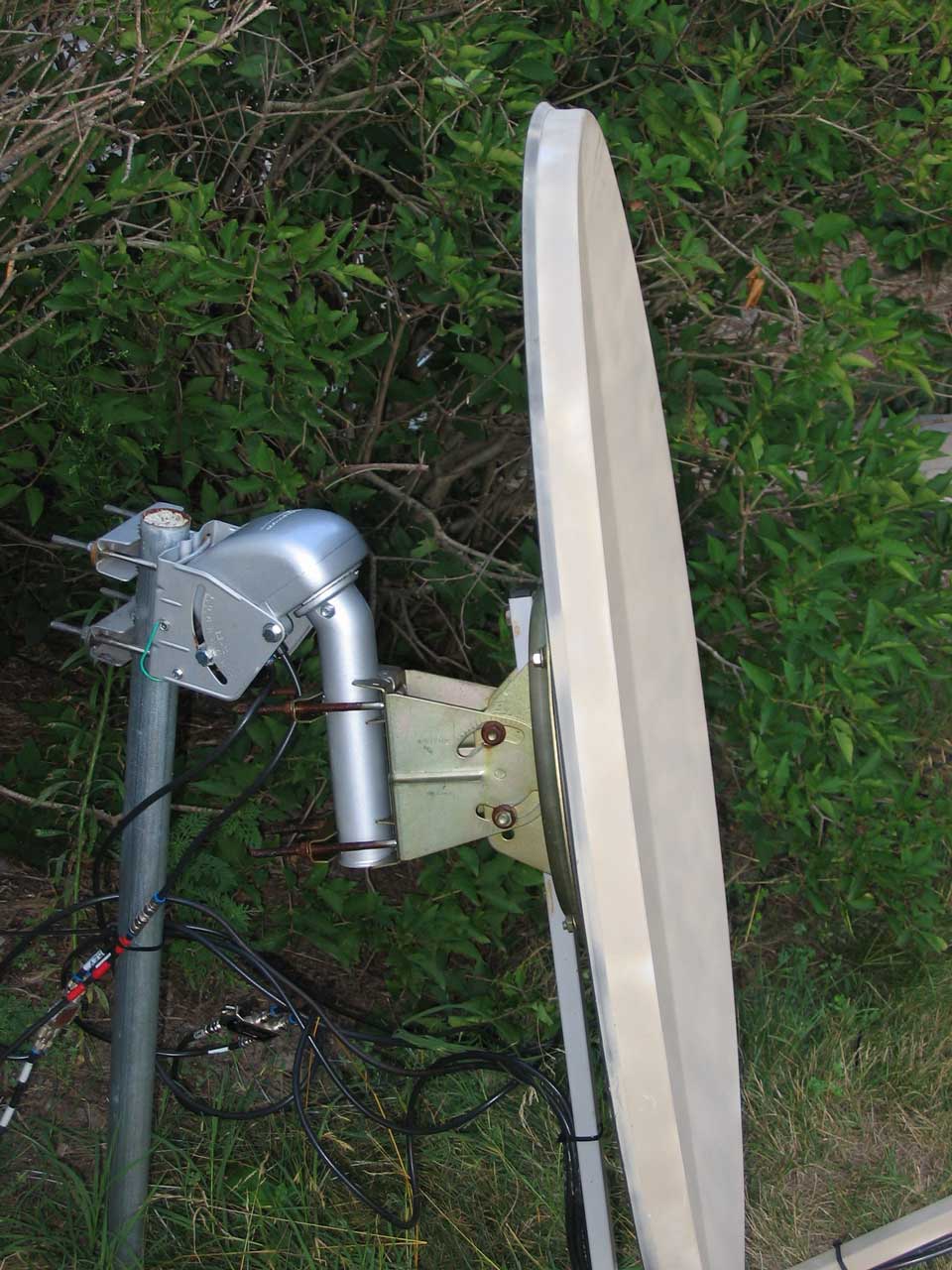

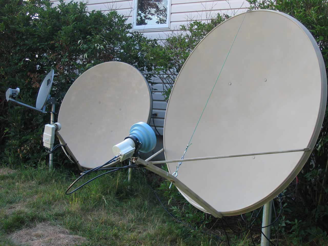

Update:
The 1 Meter dish has replaced my 90cm dish, with decent results. Haven't yet had a chance to modify my "dish elevation fine tuning bracket", but my rough setup today is giving better numbers across the arc. RTV is even decent with a Q of 45 on my Merc II.
Bought a new , 50mm tube for my SG21000 from Sadoun, and it's definitely the way to go. [edit] Anotherl plus, a blindscan of 123W no longer picks up the tp's on 125W. [/edit]
