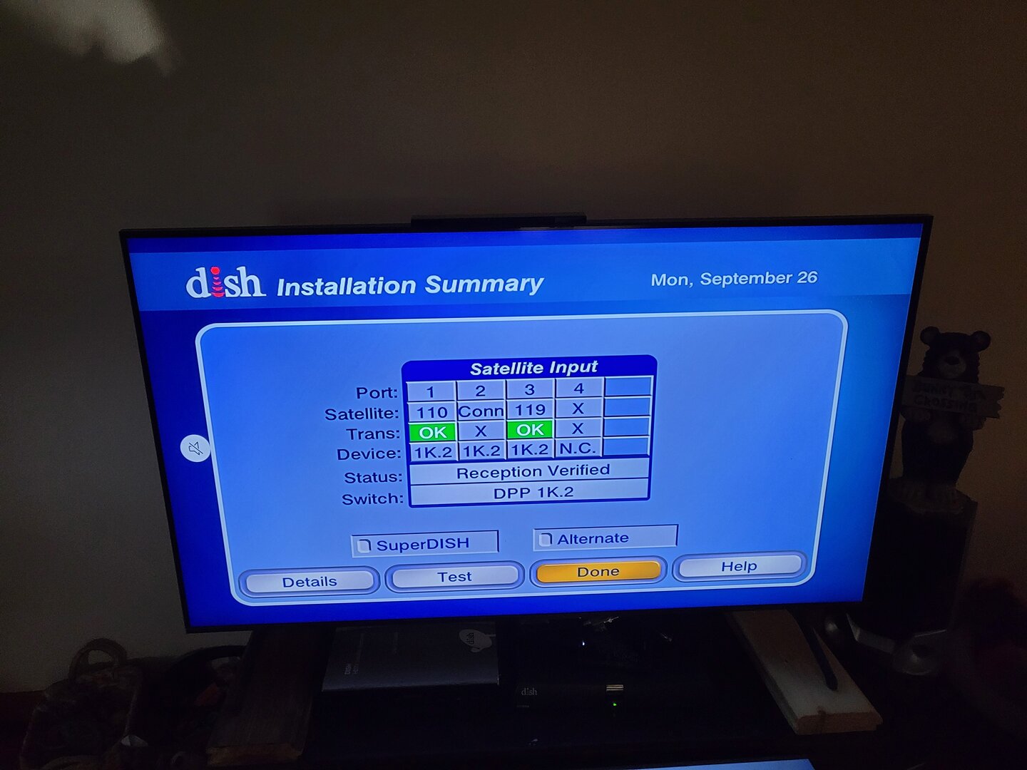

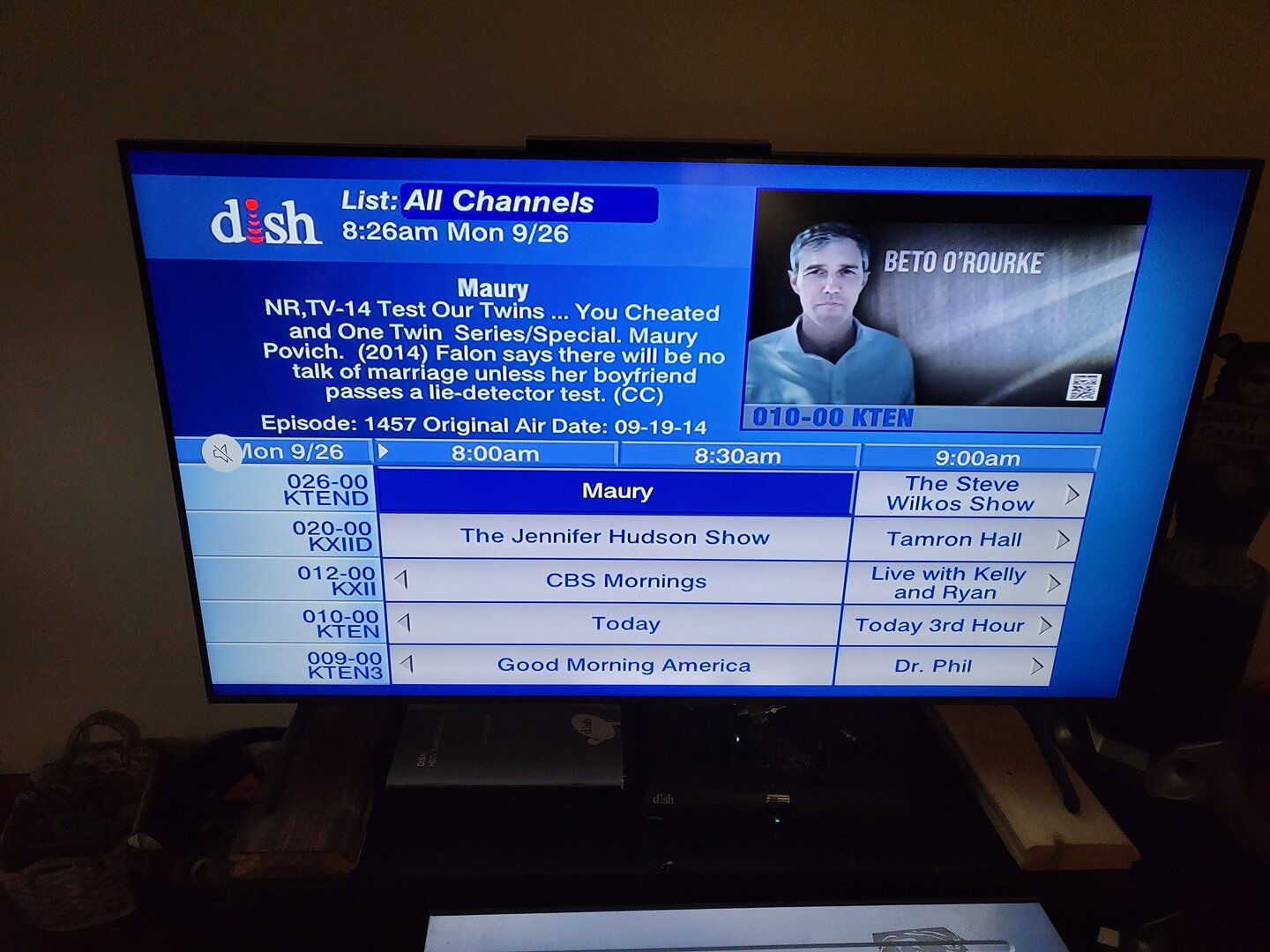

I am getting the locals on 9,10,12, etc. I ran the check switch. I don't see 129 listed either before or after I ran the test. Pixs attached...

Those channels 9, 10, 12, etc. that you see now are the SD feeds that are going away. The HD feeds would have an "HD" symbol on the left side of the box to the left in the guide, next to the channel number.
Since you don't have signal from the 129 satellite, I would guess that either you have something blocking the signal (tree growth?) or something is not hooked up correctly. It could be a sign that your LNB has started to fail. In that case, all you would need is a replacement Western Arc 1000.2 LNB, and then run the Check Switch again after swapping out the LNB. If signal from 129 is completely blocked, though, then you would need to either relocate the dish, or re-aim it for Eastern Arc instead.

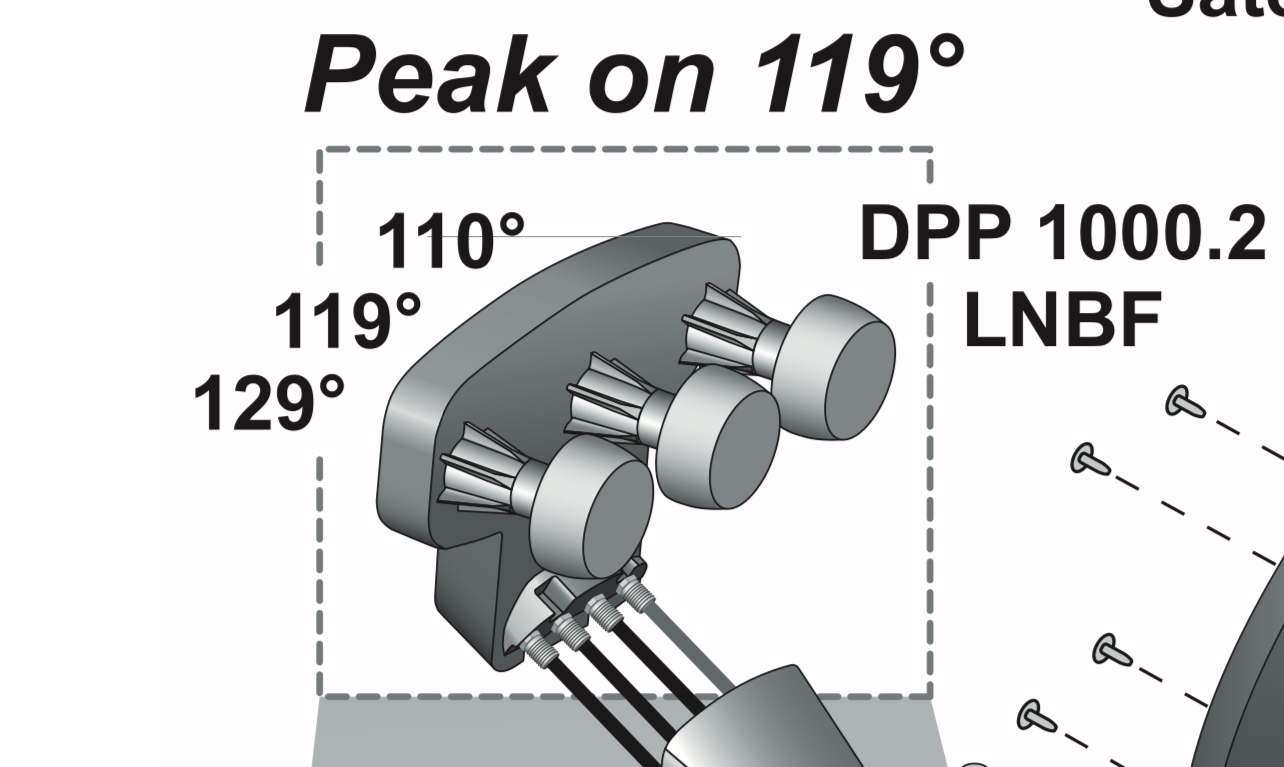

Your satellite dish is misaligned. You are receiving satellite 110 where you should be getting 119 and 119 is being received on the 129 head. The order the satellites should appear on your particular LNBF is 119/110/129. Referencing the image attached, I can tell you that you need to reduce your elevation a little (depending on where you are) then swivel to the right (or SW) a few degrees.
(Note that on the LNBF the center feed is port 1, port 2 is rightmost and port 3 is leftmost)
If you are doing this on your own without the help of a meter, it's a good idea to cover the two side heads with aluminum foil until you make sure the only satellite being received in the center head is 119. Once you lock 119 in, and your skew is correct/mount is plumb, the other two satellites will come in when you remove the aluminum and run another switch test.

I have a meter, it's been quite a few years ago that I installed this DISH and I don't remember when I replaced the LNB. I only had 512's at the time so I wouldn't know that I was missing anything. The dish is mounted 5' up on my Rohn tower. Unfortunately we have clay soil here and it shifts bad due to contraction and expansion. My tower is now leaning so I have no doubt that it (the dish) needs realigned. Tower is sitting in a 3x3x3' of concrete which is how we used to do it around here back in the days of Rohn towers, Channel Master antennas and amps.
