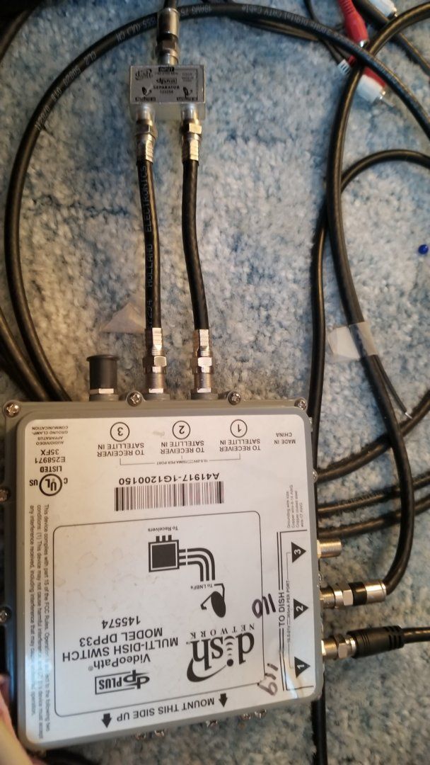

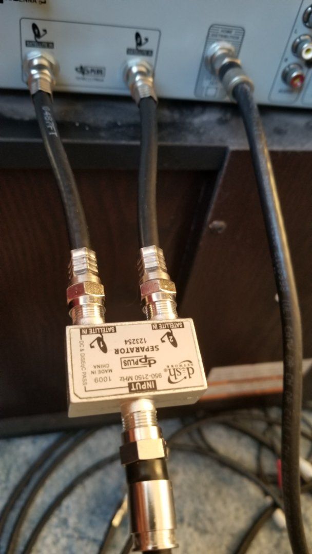

Have a dish vip 722 dvr, before we put in a switch box for satellites 110 and 119, the home distribution going to tv 2 was working, i would be able to control and have a tv guide on tv 2, now we have a switch box DPP33, i can only get a tv guide and no signal on tv 2, and it will only work if tv 1 satellite is turned off
I had that configuration with a DPP33 switch going to a 722 and 2 612's and it worked great. Do as TheMack says. Two outputs from the DPP33 should definitely not be combined together like that.
