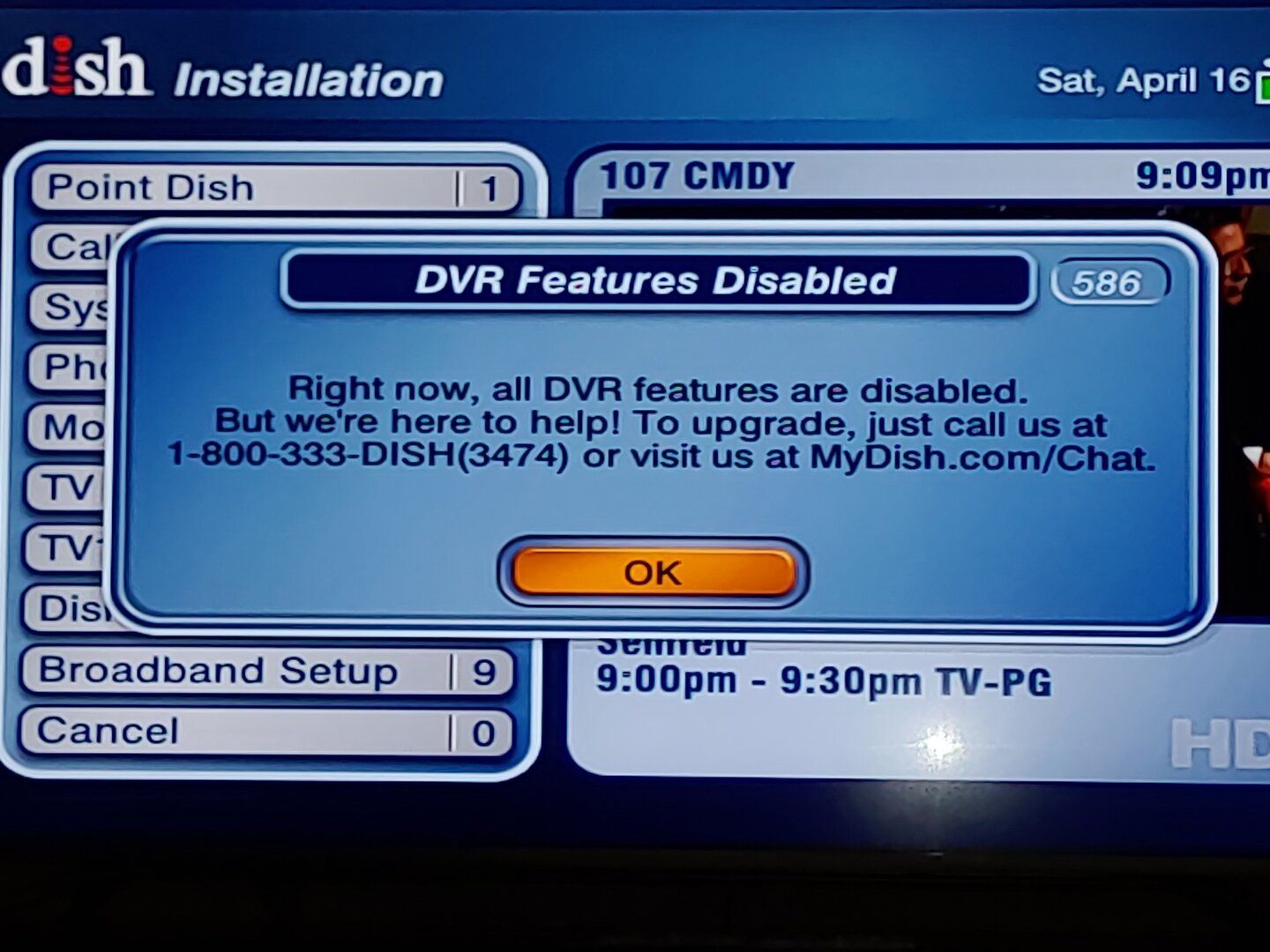

I had a 622 and three 211's all with EHD on my account. Had to replace my 622 because of bad rf modulator. So activated a 722 reman I purchased and now dish won't enable DVR function on the 722 because the say I need to upgrade to Hopper and yet DVR still works on my 211's .
Are you sure your 722 is not one of the "neutered" models? What I mean is that there is some that are being installed by Dish that have had their hard drives removed, essentially converting them into 222/222k's. These are usually installed to replace 322's for people that upgrade to ViP systems but don't want DVR functionality.
Also, where did you buy this 722?

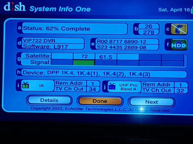

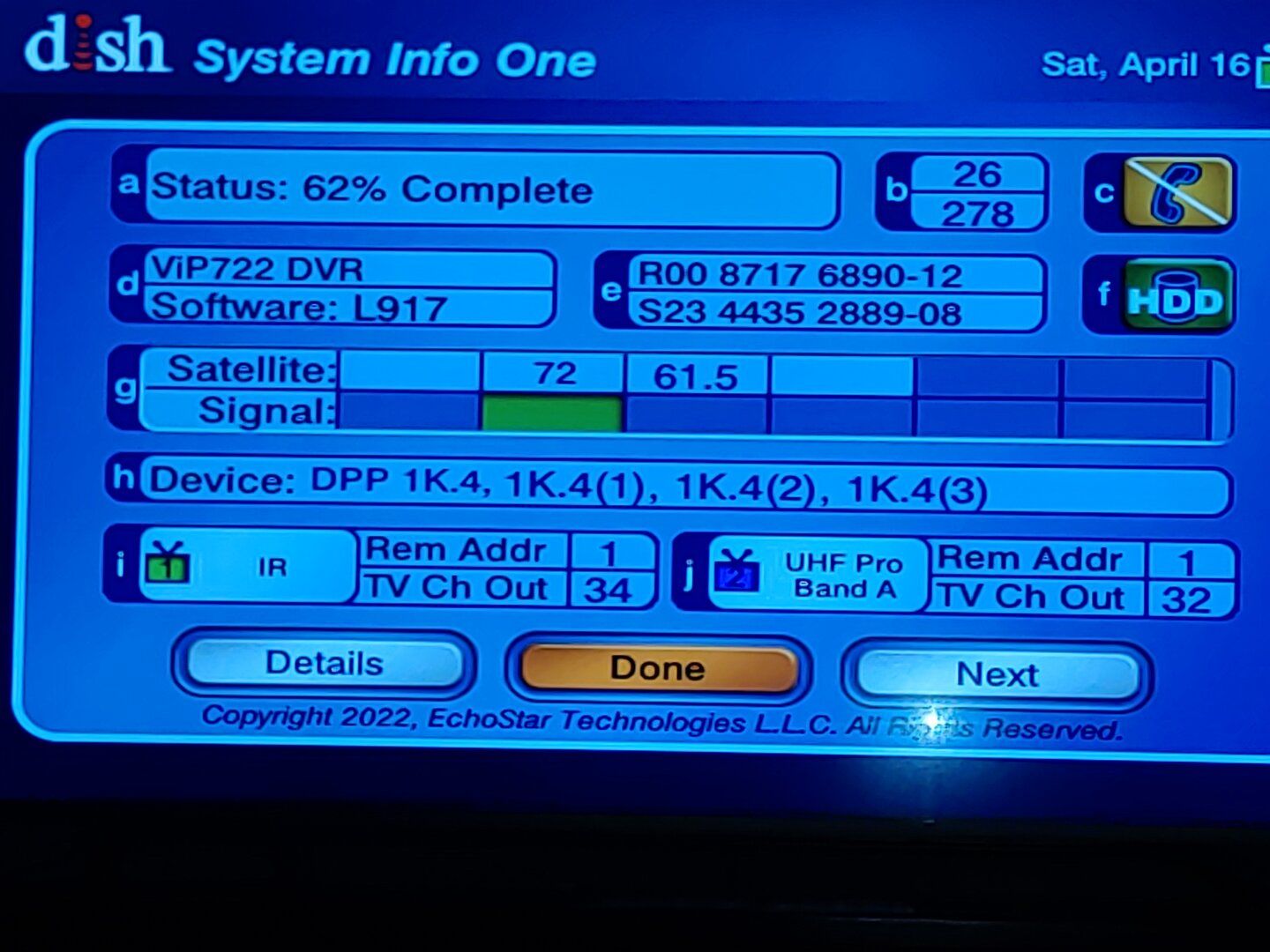

I purchased it on eBay as it is a remanufactured model and I have EHD connected to it. Maybe it is " neutered" here is system info screen and DVR disabled message.

Agreed, I've talked to two different agents.One agent said it was equipment malfunction other said said it's deactivated and DVR isn't available unless I upgrade to Hopper.

That I can believe. But don't I see a green in the "HDD" test on your right hand photo?
That I do not believe. Time to call again. BTW can you get 61.5 as well? Lots of channels over there these days.
With 1 sat showing green, is it possible a check switch needs to be done?

I see the test wasn't complete so the 61 may have just not showed up yet before he took the pic, but I was thinking the same thing at first
