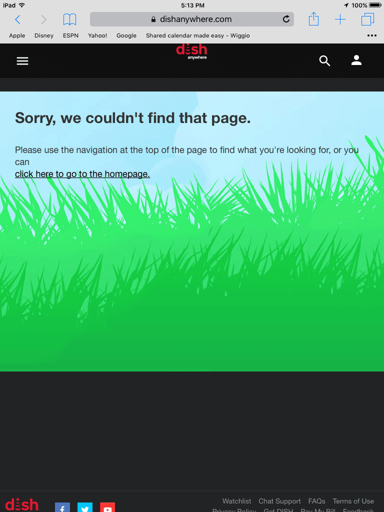

Trying to use Dishanywhere on my fire stick and I need to log in again ugh.
However when I go to the activate page it comes up that that page can't be found? Any ideas? Also looked all over the site and nothing.
However when I go to the activate page it comes up that that page can't be found? Any ideas? Also looked all over the site and nothing. View attachment 140230
That is what I got when I first tried to go to DA using my existing Bookmark.
I clicked the "Go to my homepage link" and it loaded the new DA interface.
I then bookmarked the new URL.
RodeoGeorge
Thanks. I did that but It still wouldn't work on my phone or my ipad but i got it to work with my desktop computer.
