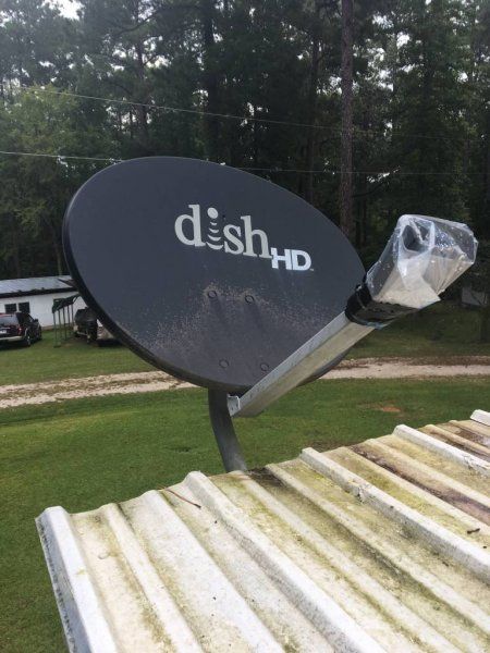

My uncle has a Wally receiver and tailgater dome thing. It works at his home but can not get the tailgater to work at his lake home.. I assume to many trees in way of signal. He does have a dishnetwork dish there also. What type of lnb is needed for this dish? They are located in South Carolina .I see there is western arc and eastern arc types. Not sure which one to tell him to buy. I told him dishnetwork would probably send him one free of charge. If not he is going to buy one. Here is picture of dish.

Needs a 1000.2 western or eastern lnb. Depends on which Arc his locals are on. Tailgater only does western
They will be West Coulmbia, SC locals. 10,19,25, 57 are the channels numbers. Any one know if there eastern or western?

From James Long's website, it looks like SD on 119 (Western Arc) and HD on 61.5 (Eastern Arc)
Columbia, SC
10-00 WIS COLUMBIA, SC (NBC) - 7252 SD 119° 4sB18 A () 5152 HD 61.5° 30s56 A (nbc)
19-00 WLTX COLUMBIA, SC (CBS) - 7251 SD 119° 4sB18 A () 5151 HD 61.5° 30s56 A (cbs)
25-00 WOLO COLUMBIA, SC (ABC) - 7250 SD 119° 4sB18 A () 5150 HD 61.5° 30s56 A (abc)
35-00 WRLK COLUMBIA, SC (PBS) - 7256 SD 119° 4sB18 A () 5156 HD 61.5° 30s56 A ()
47-00 WZRB COLUMBIA, SC (CW) - 7255 SD 119° 4sB18 A 5155 HD 61.5° 30s56 A
57-00 WACH COLUMBIA, SC (FOX) - 7253 SD 119° 4sB18 A () 5153 HD 61.5° 30s56 A (fox)
63-00 WKTC SUMTER, SC (MYTV) - 7254 SD 119° 4sB18 A 5157 HD 61.5° 30s56 A

My uncle has a Wally receiver and tailgater dome thing. It works at his home but can not get the tailgater to work at his lake home.. I assume to many trees in way of signal. He does have a dishnetwork dish there also. What type of lnb is needed for this dish? They are located in South Carolina .I see there is western arc and eastern arc types. Not sure which one to tell him to buy. I told him dishnetwork would probably send him one free of charge. If not he is going to buy one. Here is picture of dish.View attachment 134491
Sent from my SM-G930V using Tapatalk
looking at the skew, it looks like a western arc, but it would be eastern in SC. Maybe the picture is reflected?

Are you sure the tailgater doesn't have a line of sight this looks pretty clear.
Why would dish network send him a free LNB?
Why is there a bag on the arm?
He has dishnetwork service at his home. With a dishnetwork satellite dish. He bought the dome tailgater to use at football games, etc. He now wants to take the wally receiver to use at lake home when he visits there. The previous home owner of lake house I assume had dishnetwork service and had to send lnb back to dishnetwork. When they canceled service. Why wouldn't dishnetwork send lnb for his dish to use. If he is a paying customer? I found them on ebay selling for about 20 bucks anyway. I can probably find one at garbage dump. Heck I already found like 10 or so direct tv swim lnb there. In metal bin.
