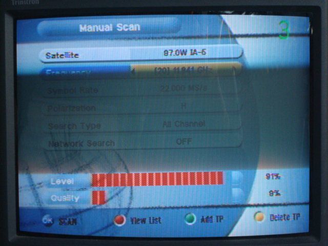

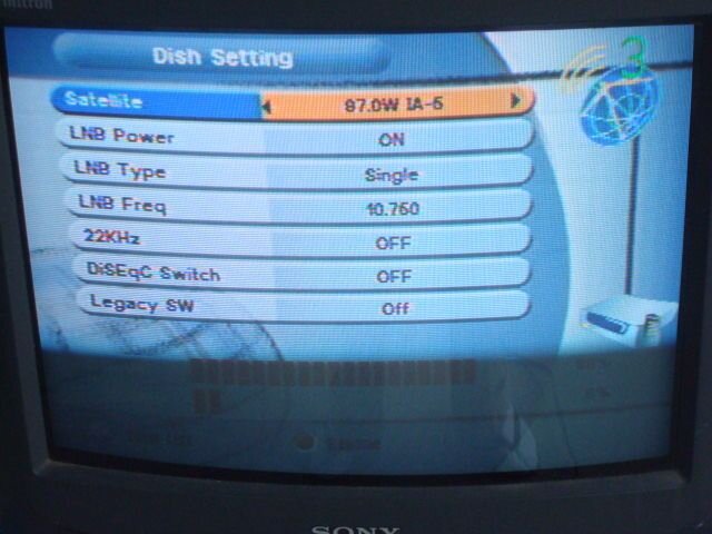

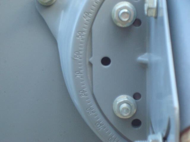

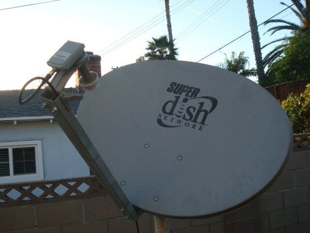

Hey All,
I understand above dish is usable for Galaxy 19( 97 sat ). I have aimed it already and I am coming up short. Any ideas will certainly help, thanks. ( see pics below - sorry not the best)
My settings for Brea, CA are: EL 44.6 / AZ 132.3 / SK -27.9R

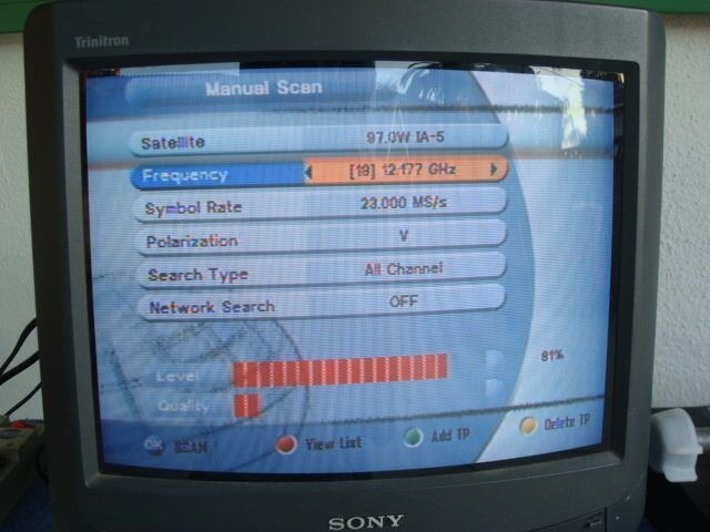

OK the settings are right but you need to select a VERTICAL transponder when aiming.
12177 V 23000 works well
bandstacked LNB's take the H side and "stack" them above the vertical so honestly the frequency wont be right on horizontal polarities..they will be higher
But otherwise it looks good for the settings

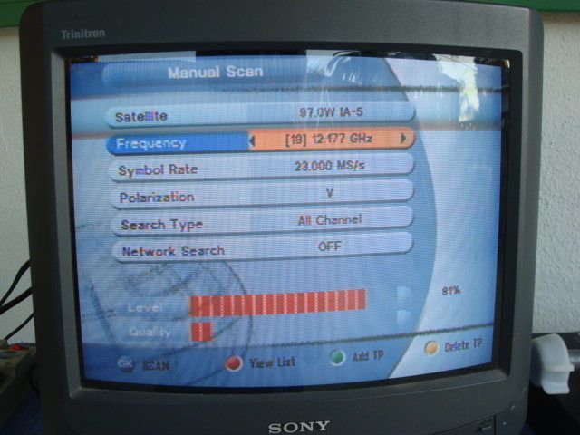

Thanks Iceberg,
Here I am trying to use a VERTICAL transponder, as you suggested, but I know I am not doing something right for I still get red bars.
The bars will turn green when you lock on the signal
Otherwise try a blind scan and see if you pick up any channels. Regardless of what sat you are on, the blind scan should pick up something
It looks like the LNB is on the stock setup just the covering is gone. Might just be that way due to the picture
Dish has that sinking feeling!
