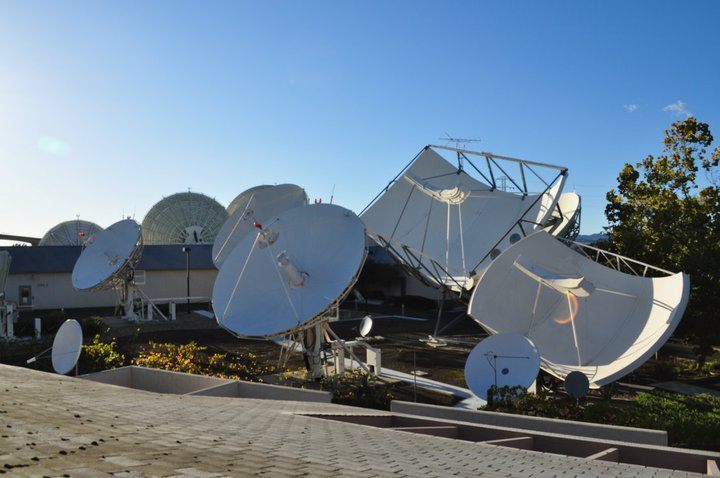

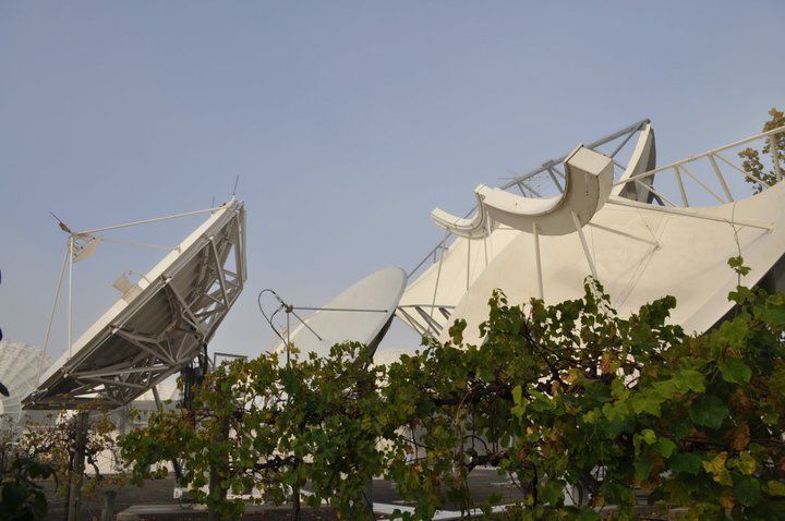

Here's a couple..

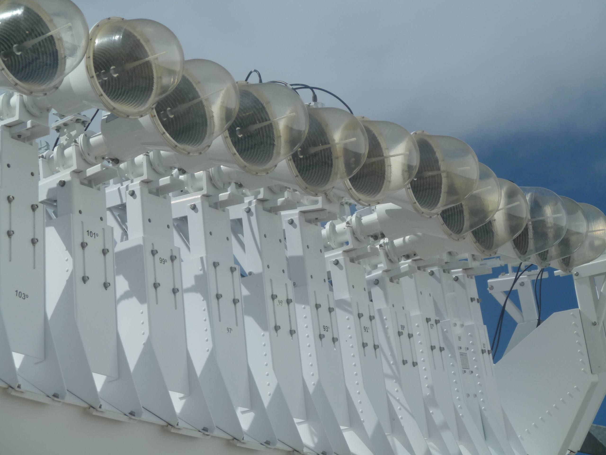

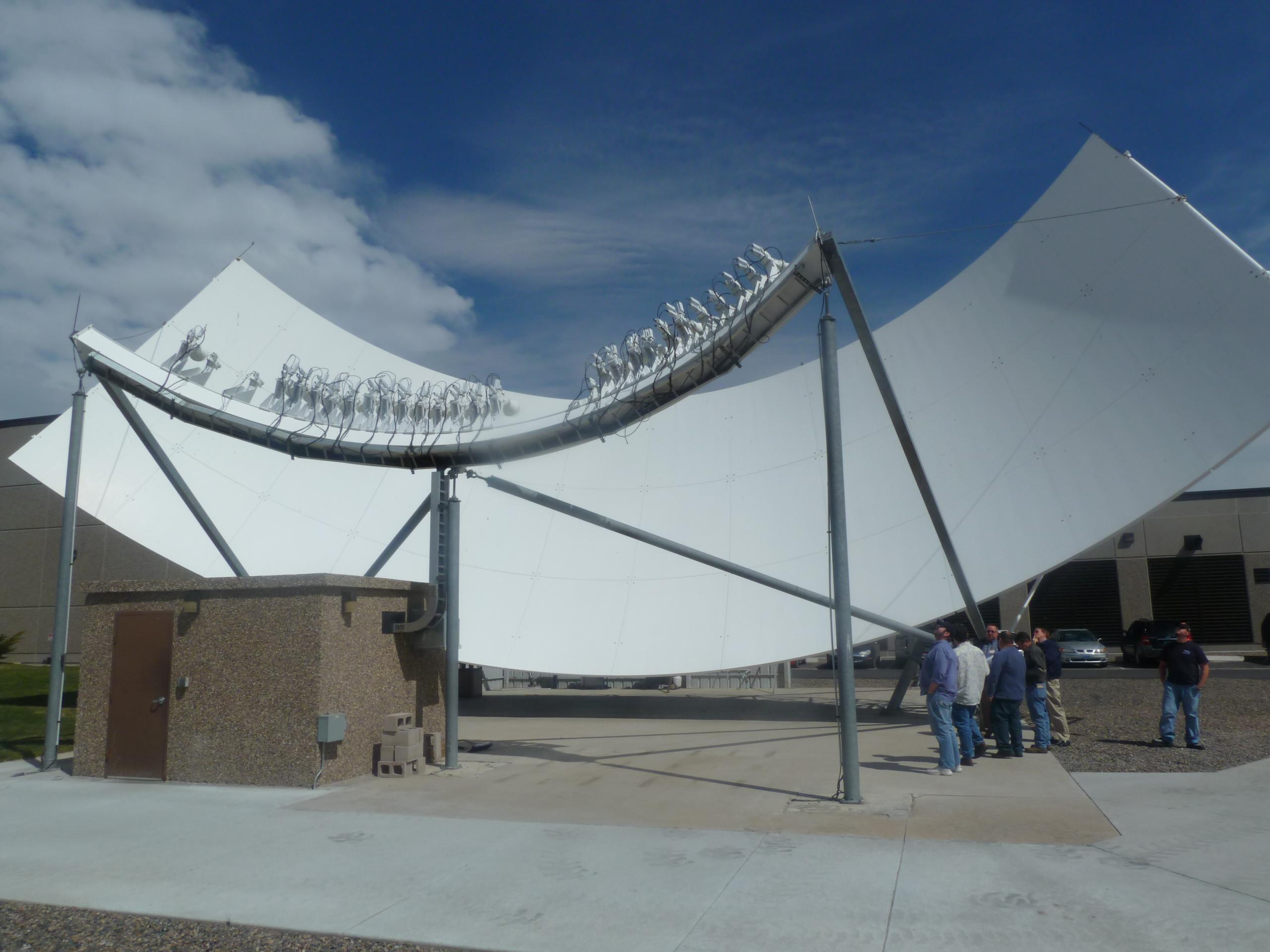

Here is the dish they use at the DISH Network uplink center.
A majority of the satellite signals they receive for use on DISH Network are received by this dish.
I find the LNB's really interesting, I would love to know what they are...

ATCi's small one is like 5 x 8 meters. Got the room? Have you experience making a simple parabolic? Might be advantageous. The Simulsat's are basically a spherical, horizontally, with a focal distance slightly longer than the focal length of the vertical parabolic shape. Whip out the calculator, sharpen the pencil, and start cutting ribs. Let us know "how it goes" with a pictorial step by step. Might be good for "bragging rights" but an actuator on a polar mounted BUD, or multiple BUD's will do the job for a lot less cost, and certainly, little chance of failure. 3 or 4 LNBF's on a 10ft BUD is easily "do-able". Fund saving tip: If you do it, maybe a Ku only model. Maybe ~2 meters high by ~3-4 meters wide.
Looks like an ATCi Taurus design....ATCi does not advert this Receive Antennae any longer that I can see at this time...If you are genuinely interested, I can inquire...

The photos give no indication what kind of lnbs are in that line where a scalar would ordinarily be.
