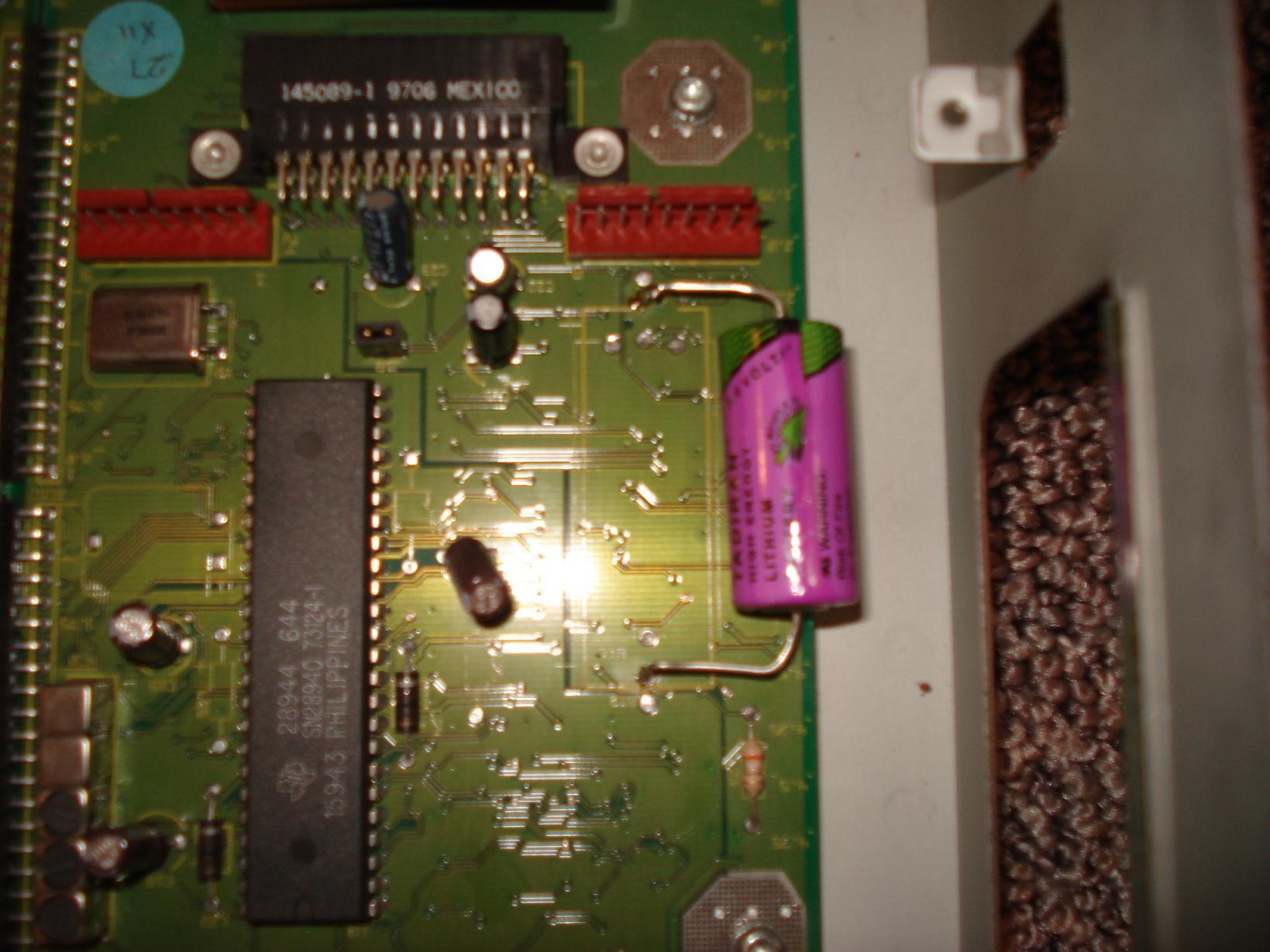

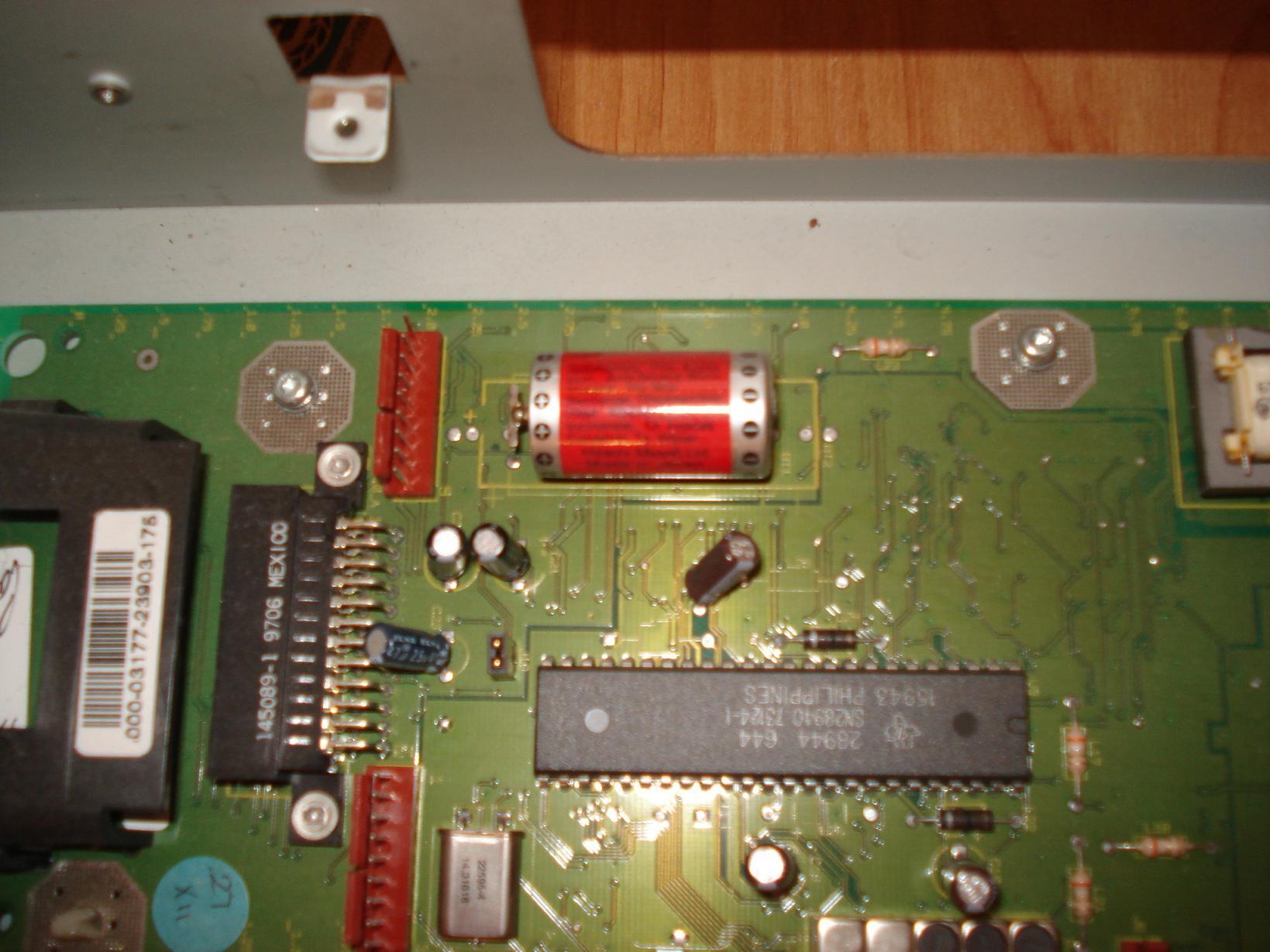

when I got my 920, I also replaced the battery...
I just soldered in the new one right beside the old battery, then removed the old battery...
what is the resistor for? are you trying to drop the voltage a little?
here is a couple of my pics...

nice work tvropro... :up
He only used the wire from the resistor not the resistor itself. He cut off the resistor after using the two ends.

Resistors are a nice source for short hook up wire. Plus the resistor fits really nice in the hole. Also it makes it easy to replace the battery again since you have terminal pins on the board. :)
