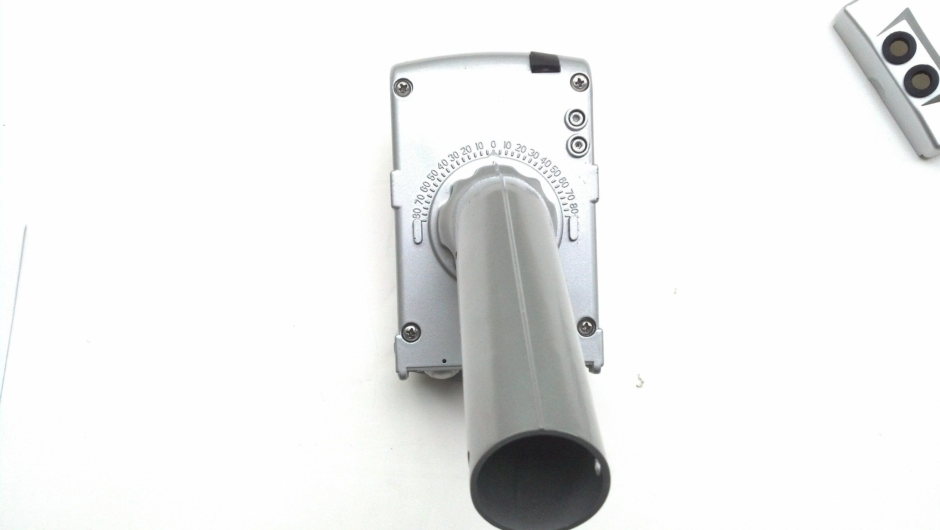

Ok so what did I do next. Well I decided to try and use a GEOSATpro 1.2 meter dish. Well the shaft was to small so, I sleeved a bigger tube over the shaft to work and it worked well. The dish is 27 pounds and it moved it back and forth with no problem.

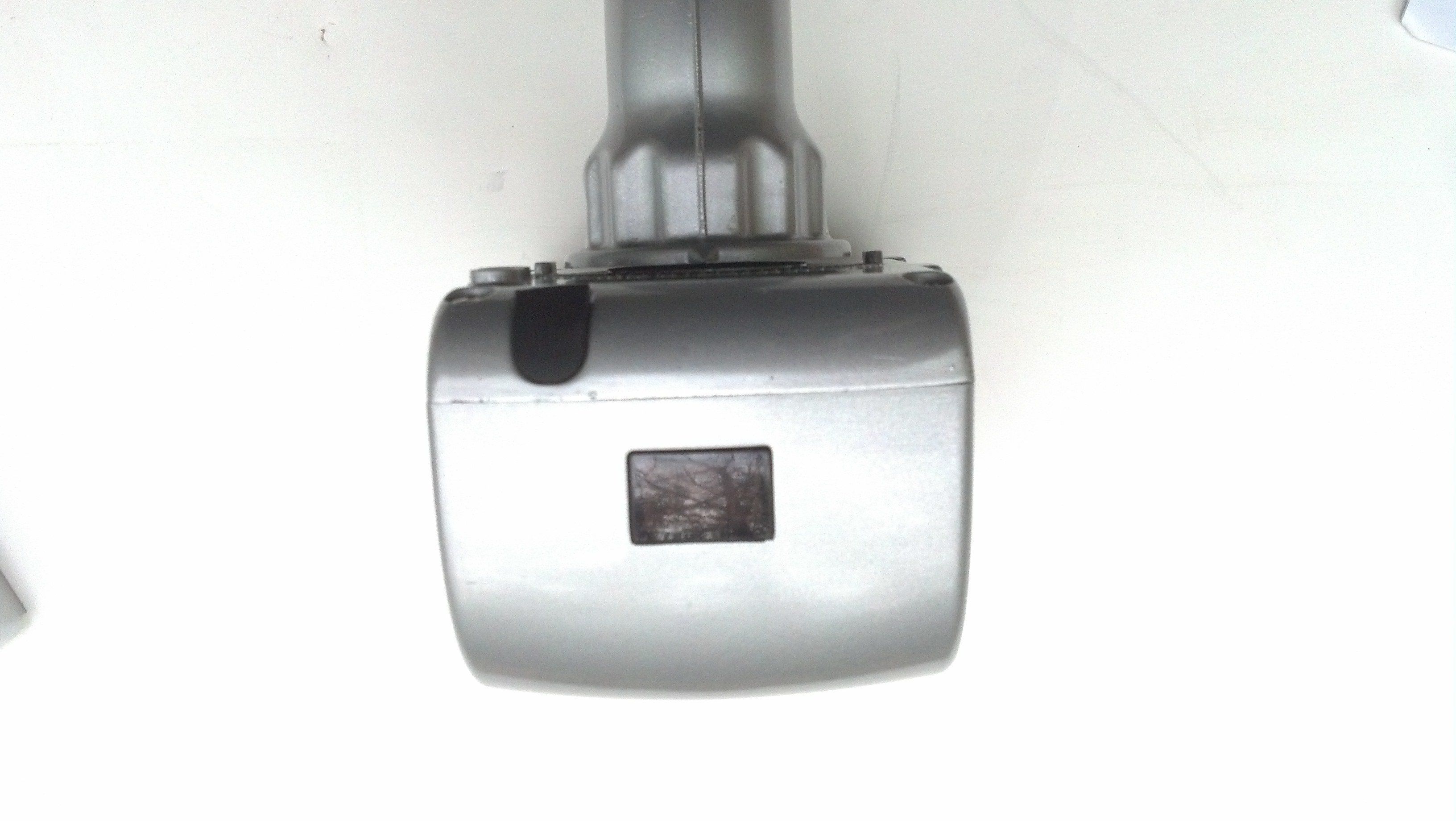

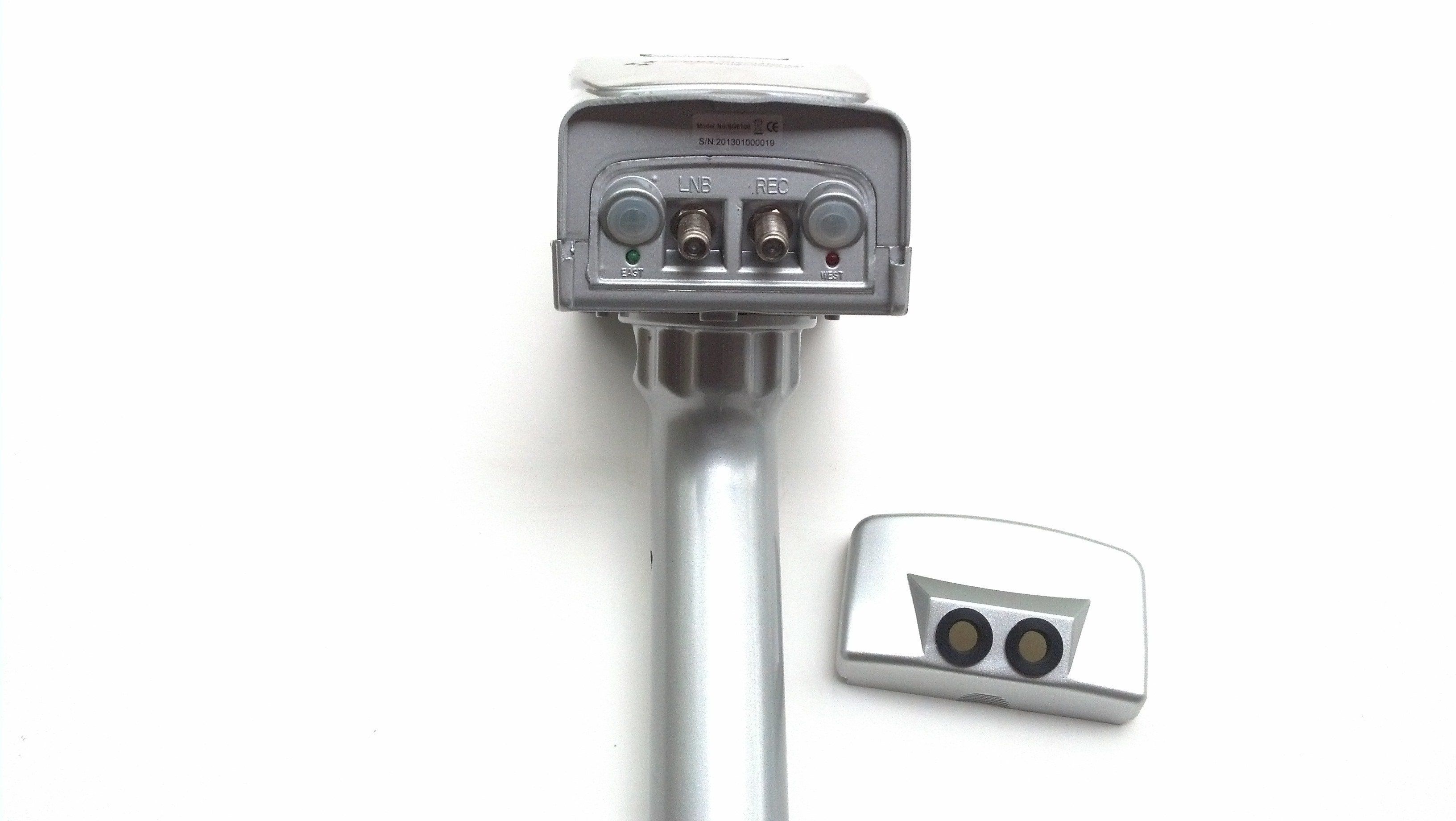

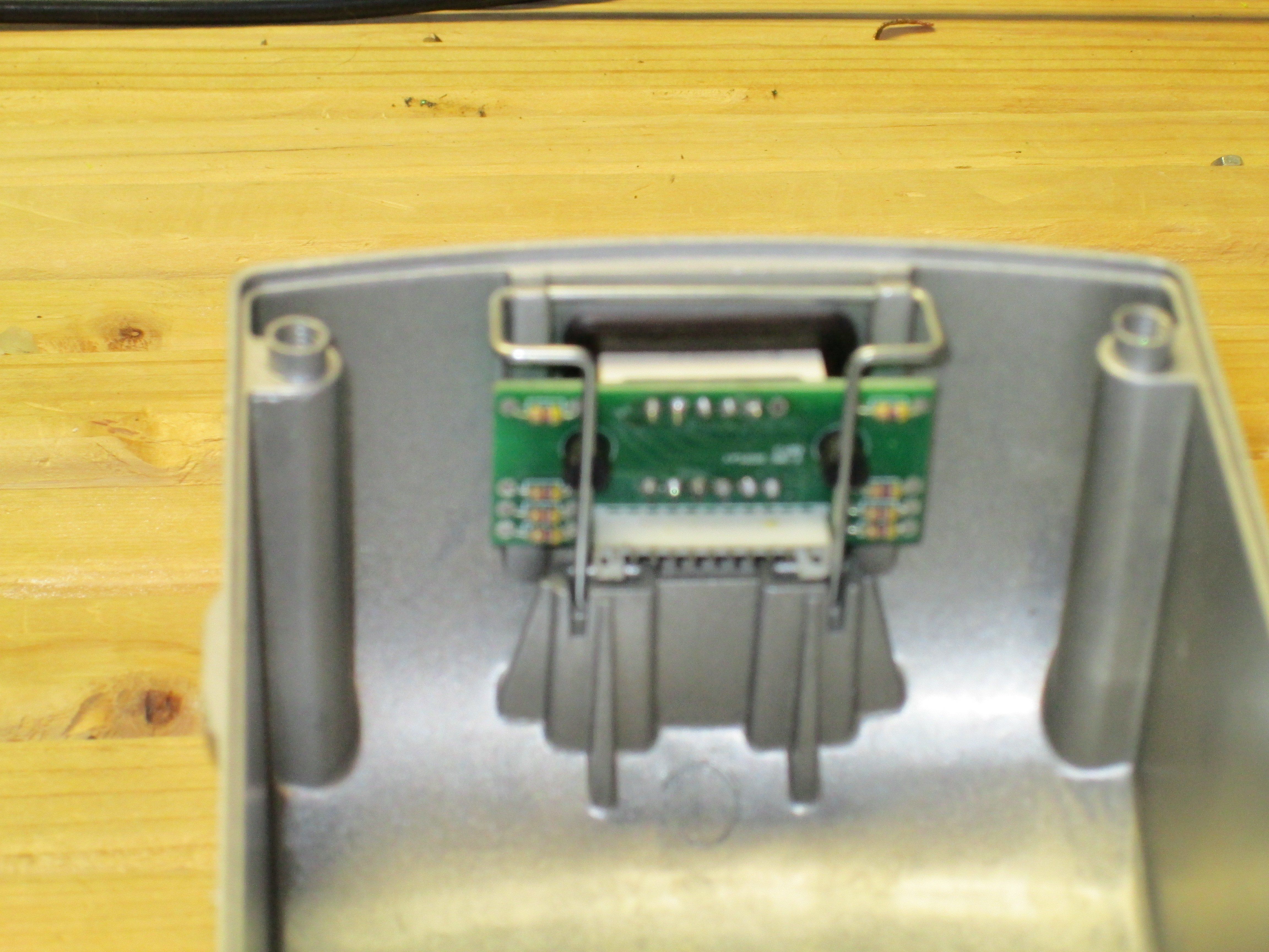

The only other down side is the new read out display, cool as it is, is that it is on top so you can't see it unless you get a step ladder out to view it, so it is kinda worthless. It also don't work very well in direct sun light, very hard to see. I never used it, even though it is there and works, and actually forgot about it.

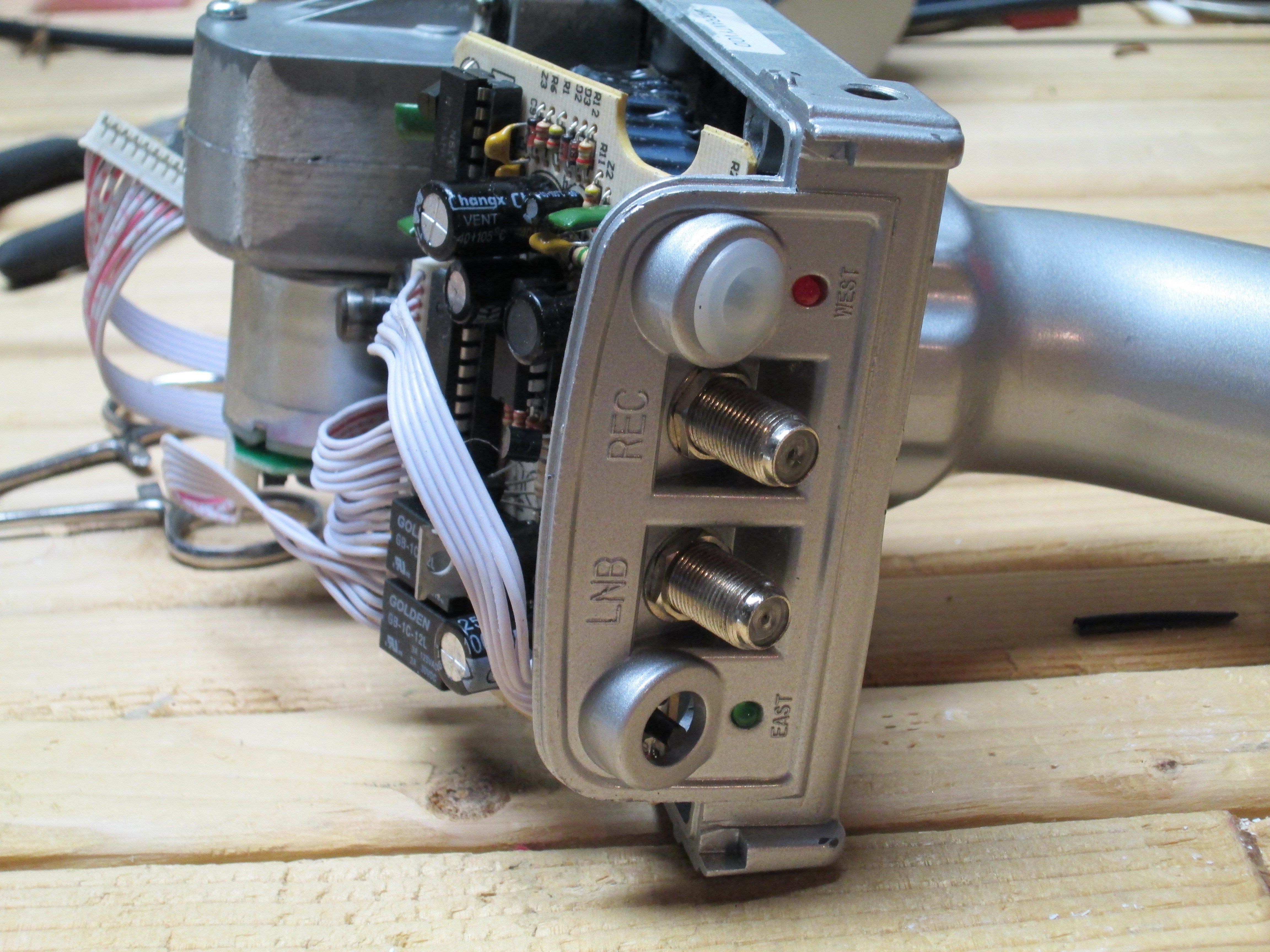

SG6100 Motor Inside View
The rest!!

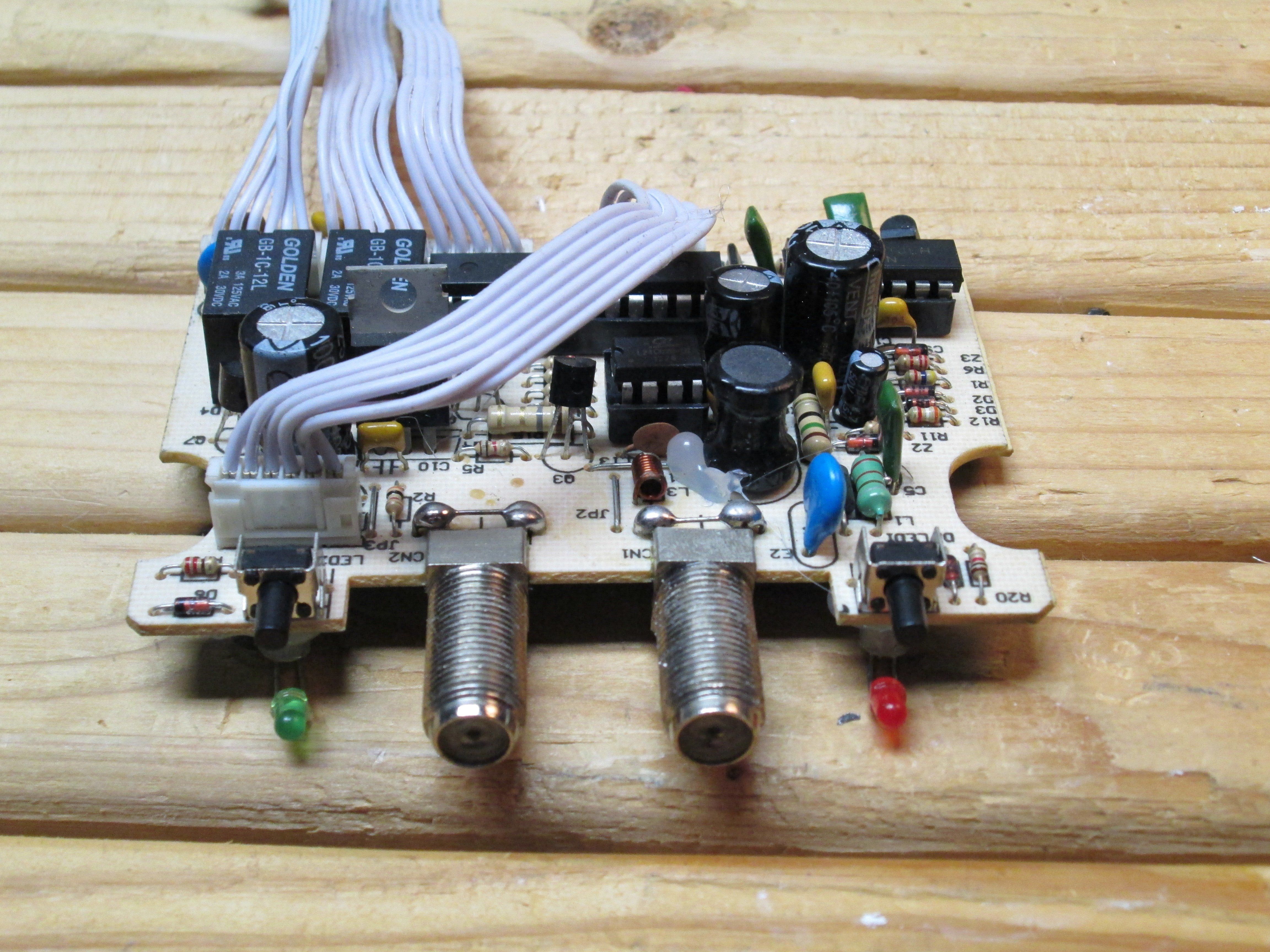

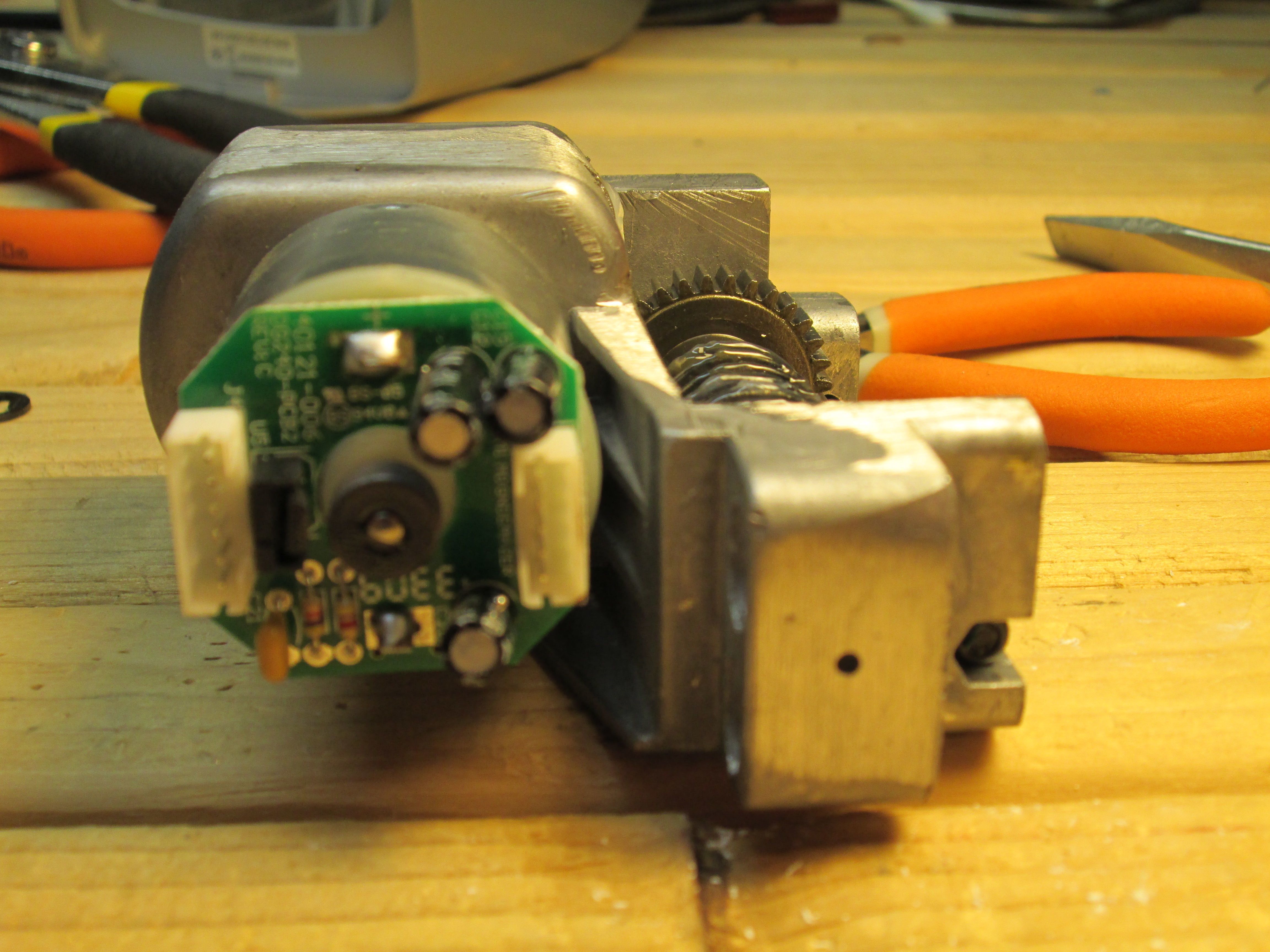

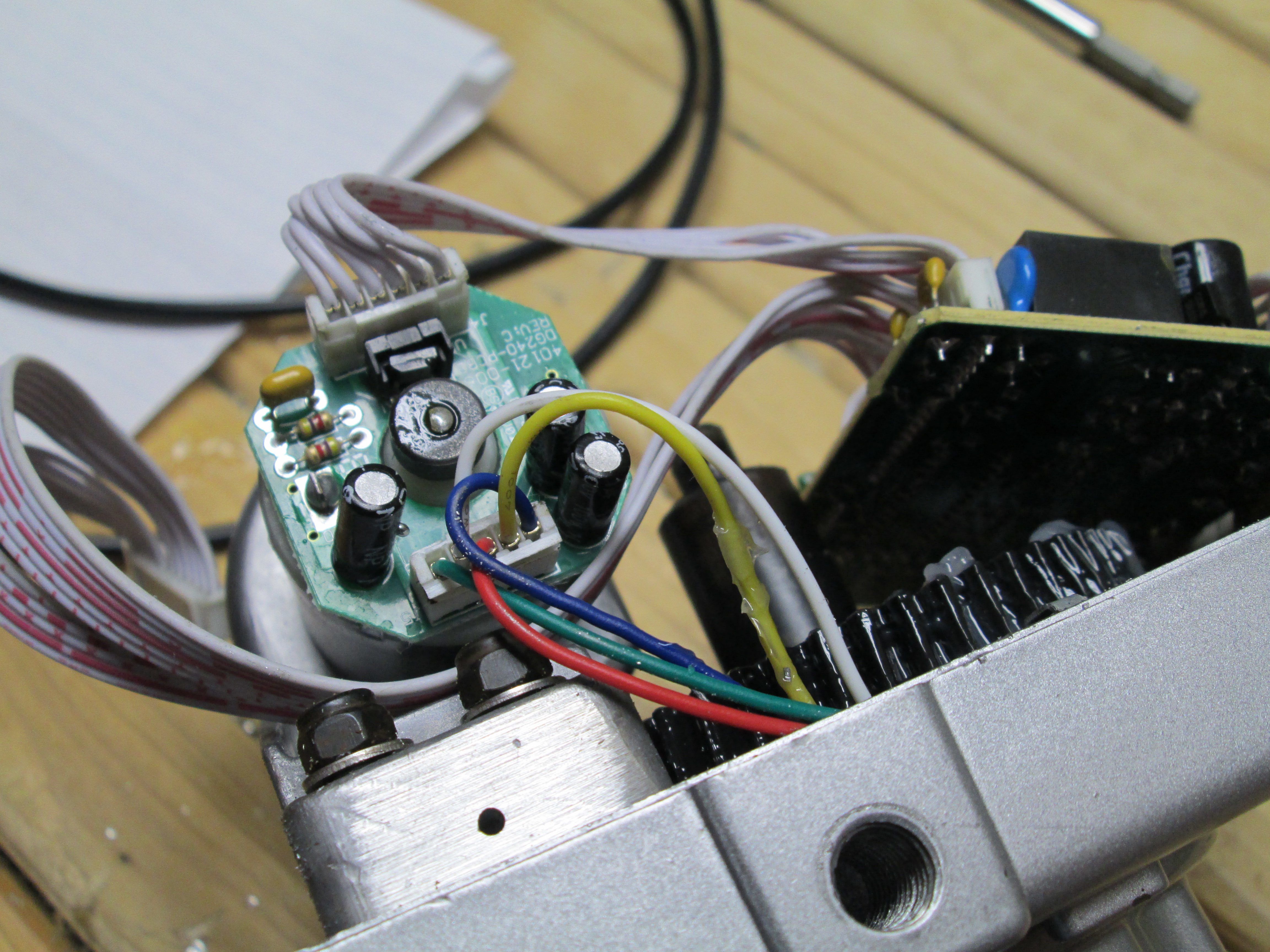

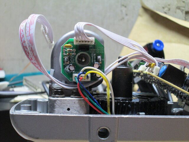

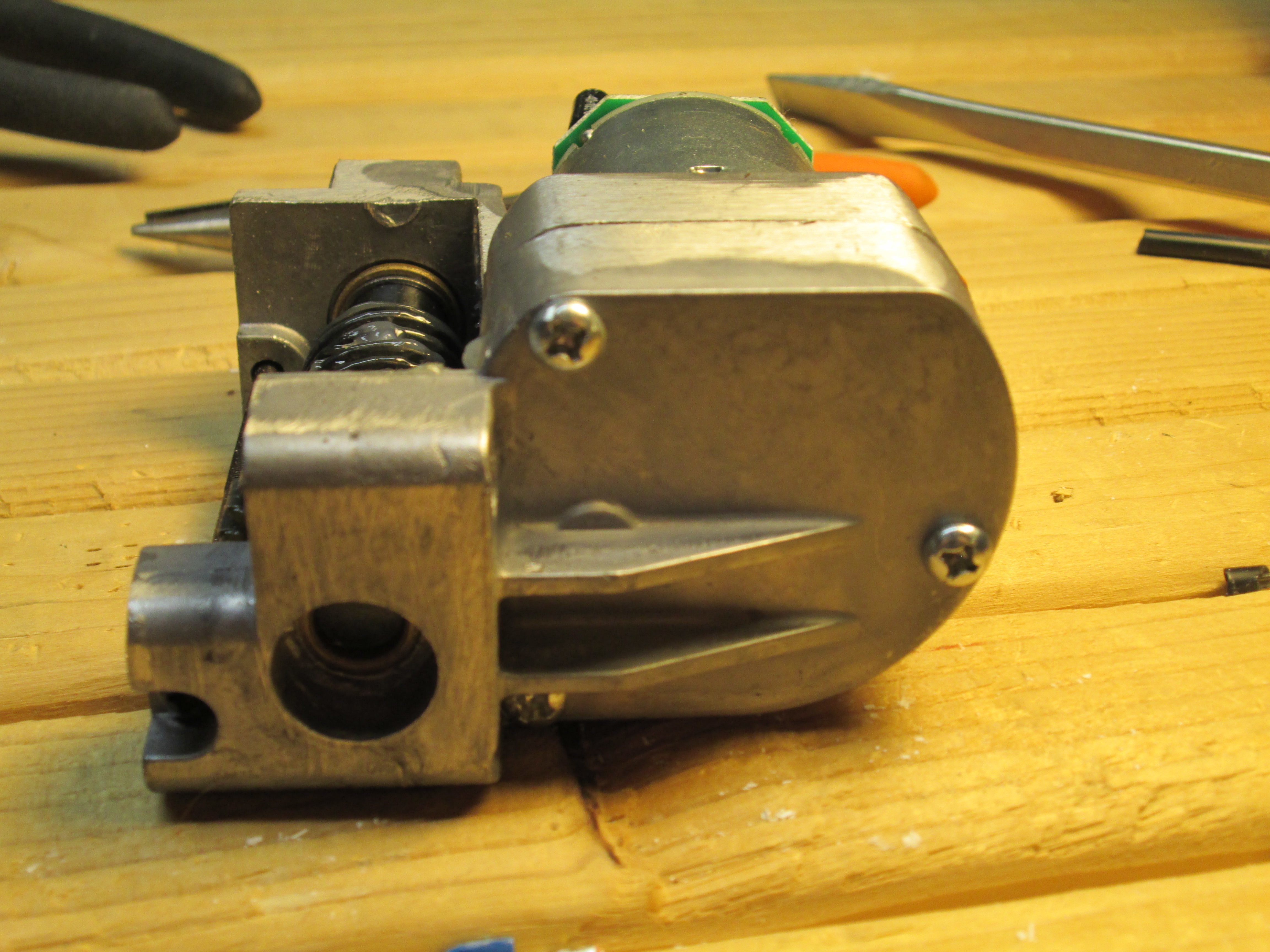

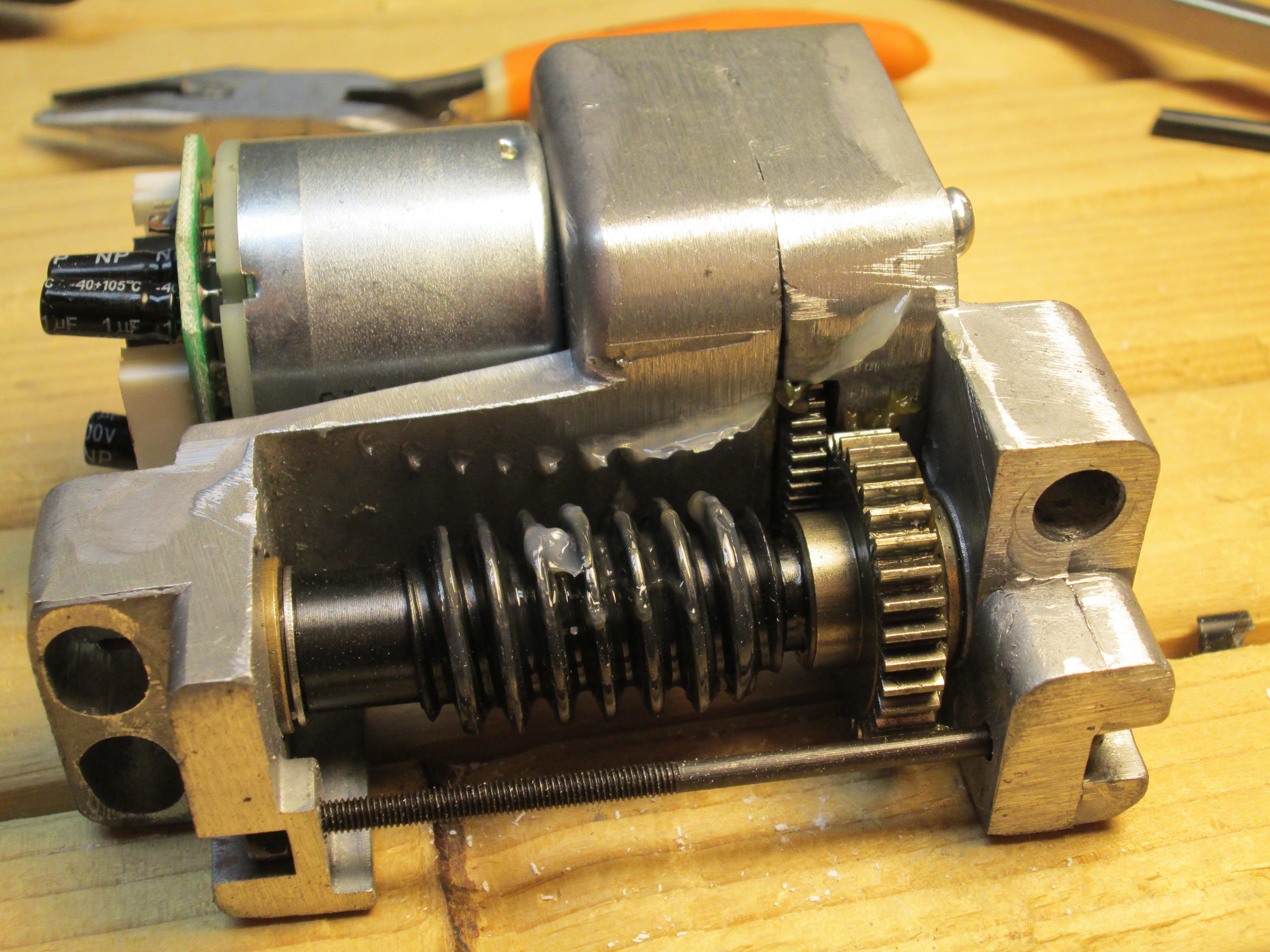

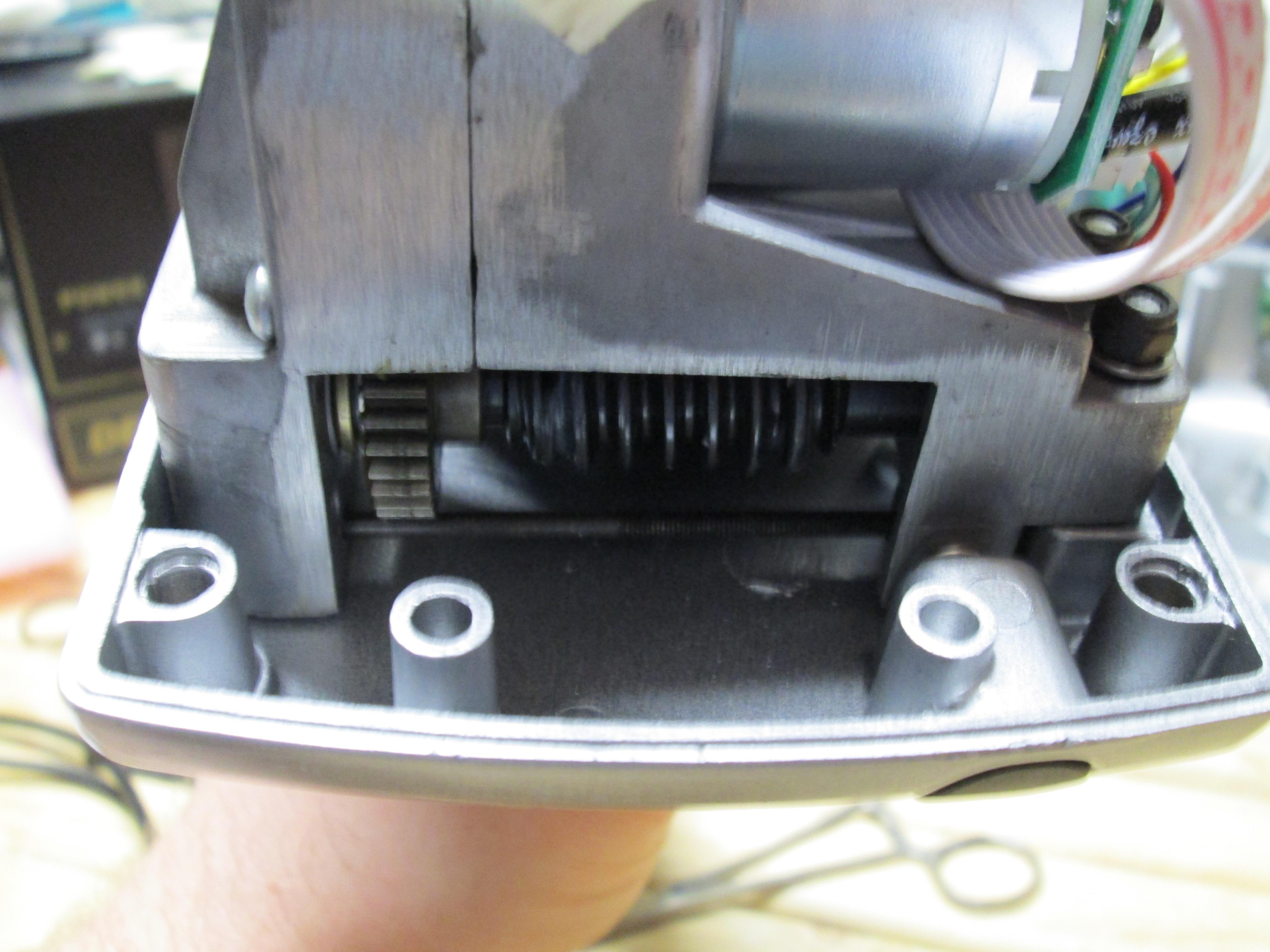

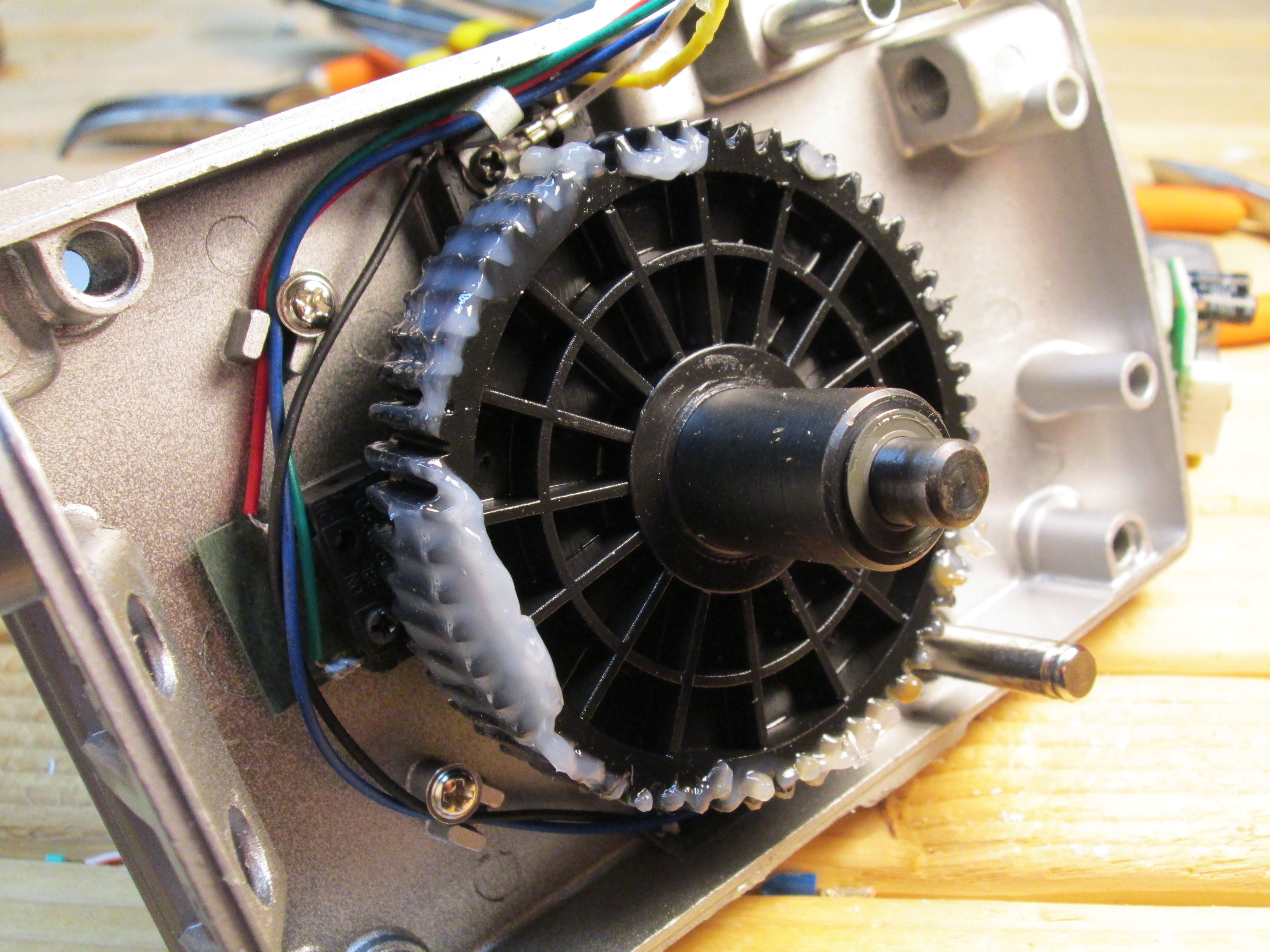

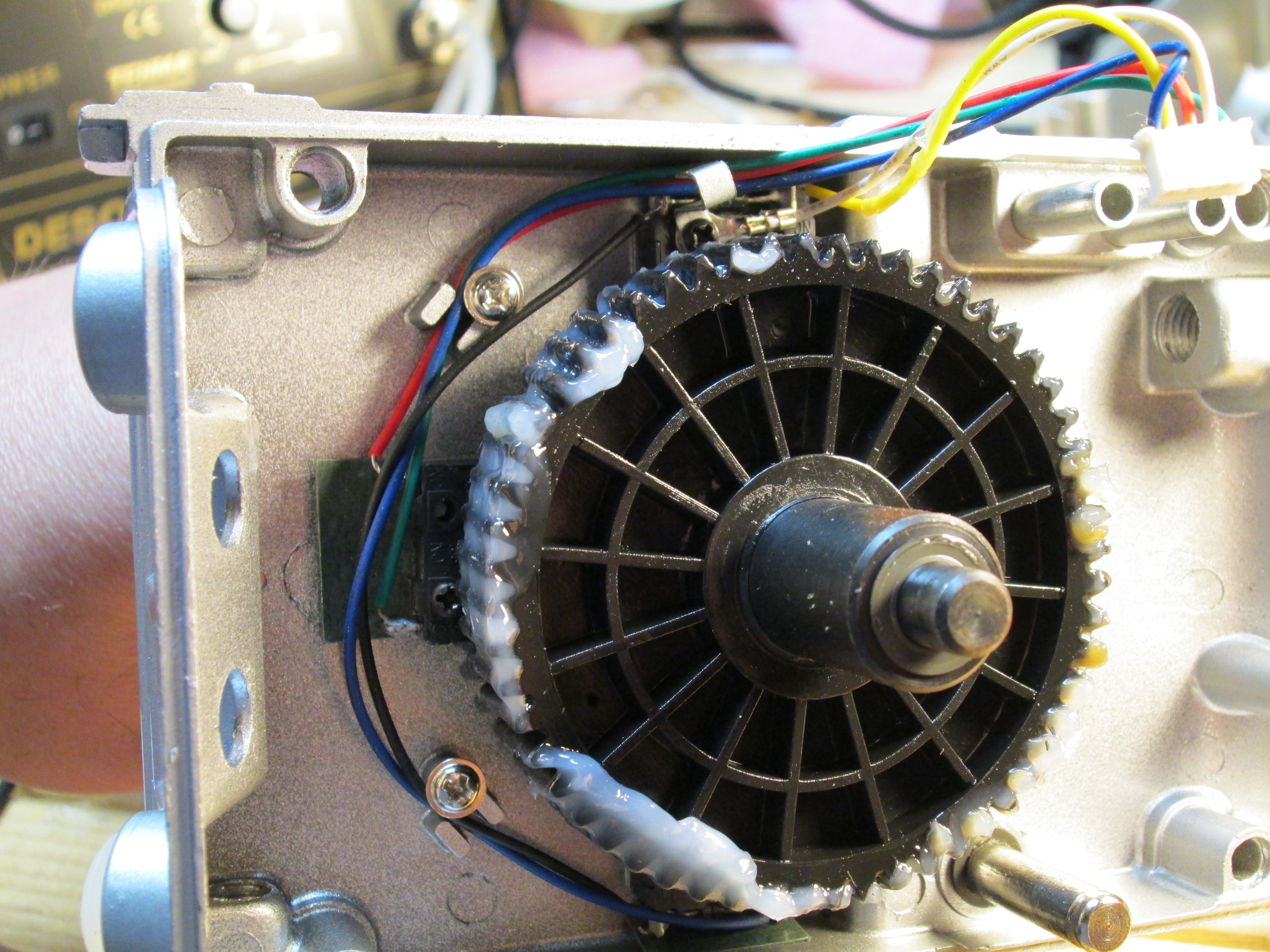

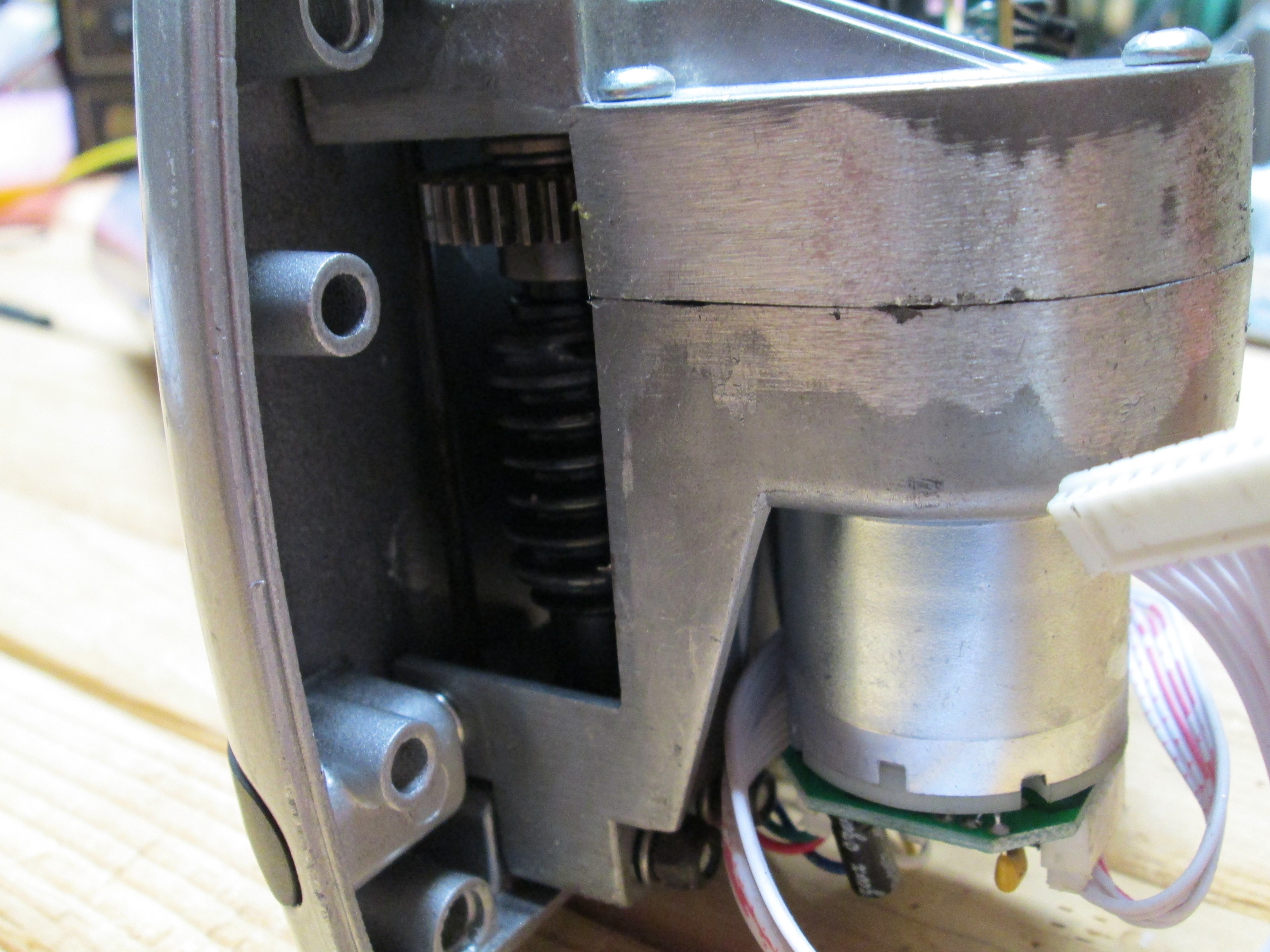

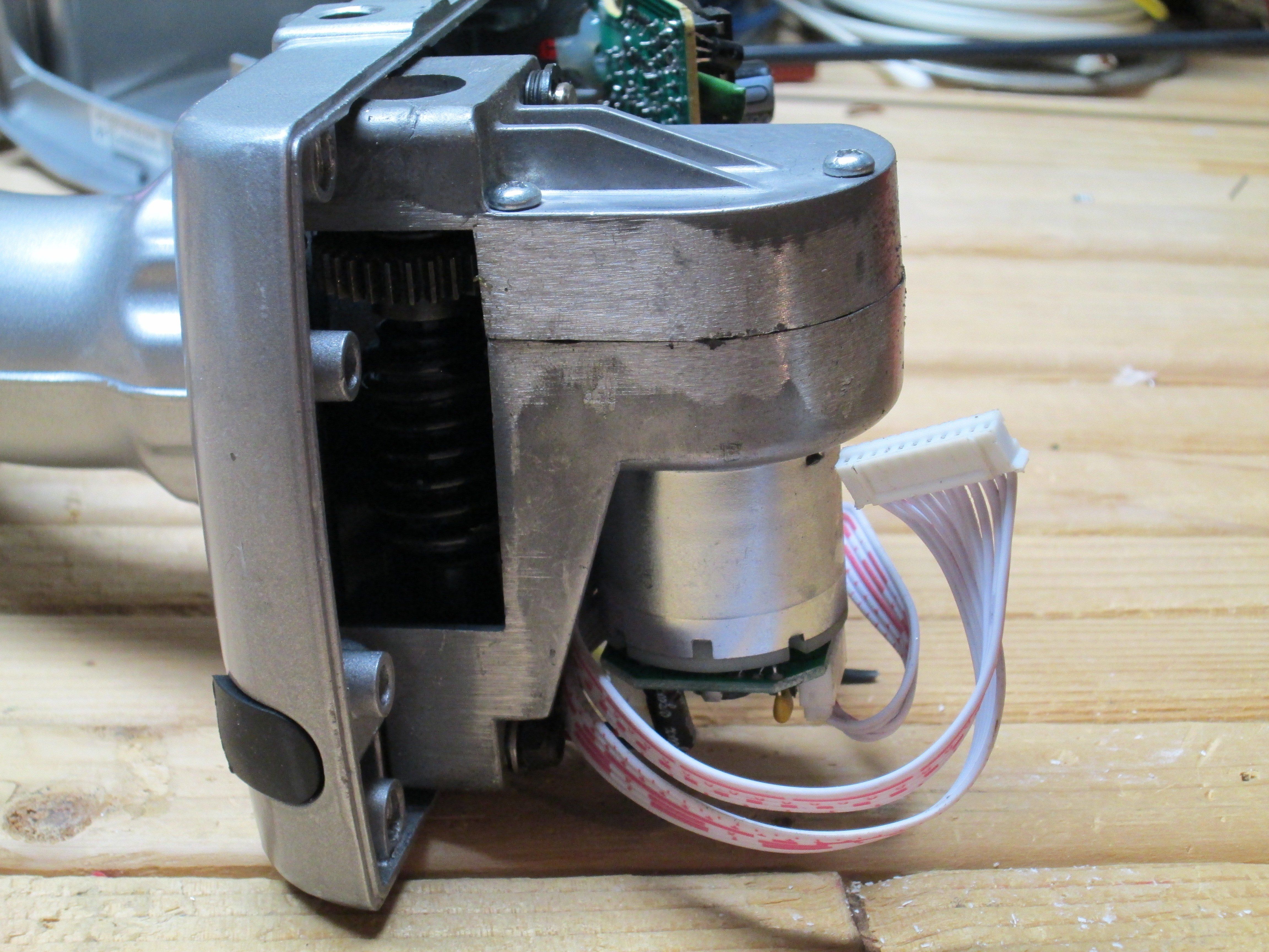

Great photos! The unit does appear to be very good construction and appropriate amount of lube.
The shaft gear is nylon and I prefer this over metal to metal gear drives. The nylon gear provides a quieter drive, less backlash and has much better performance in cold weather. Despite the marketing suggestions of metal to metal superiority, in the six years we sold motors, I never processed an RMA for a damaged nylon gear.
attachment.php

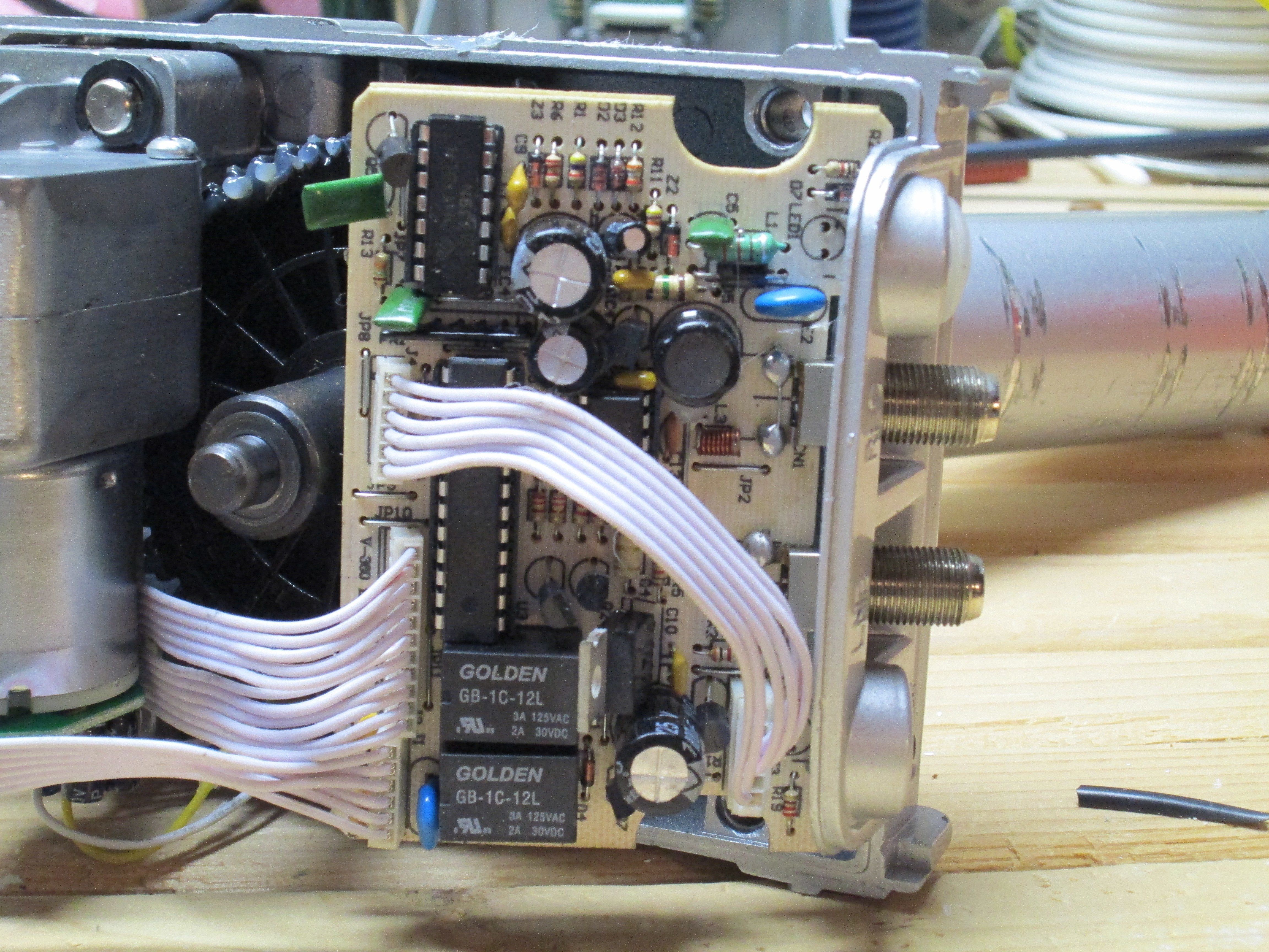

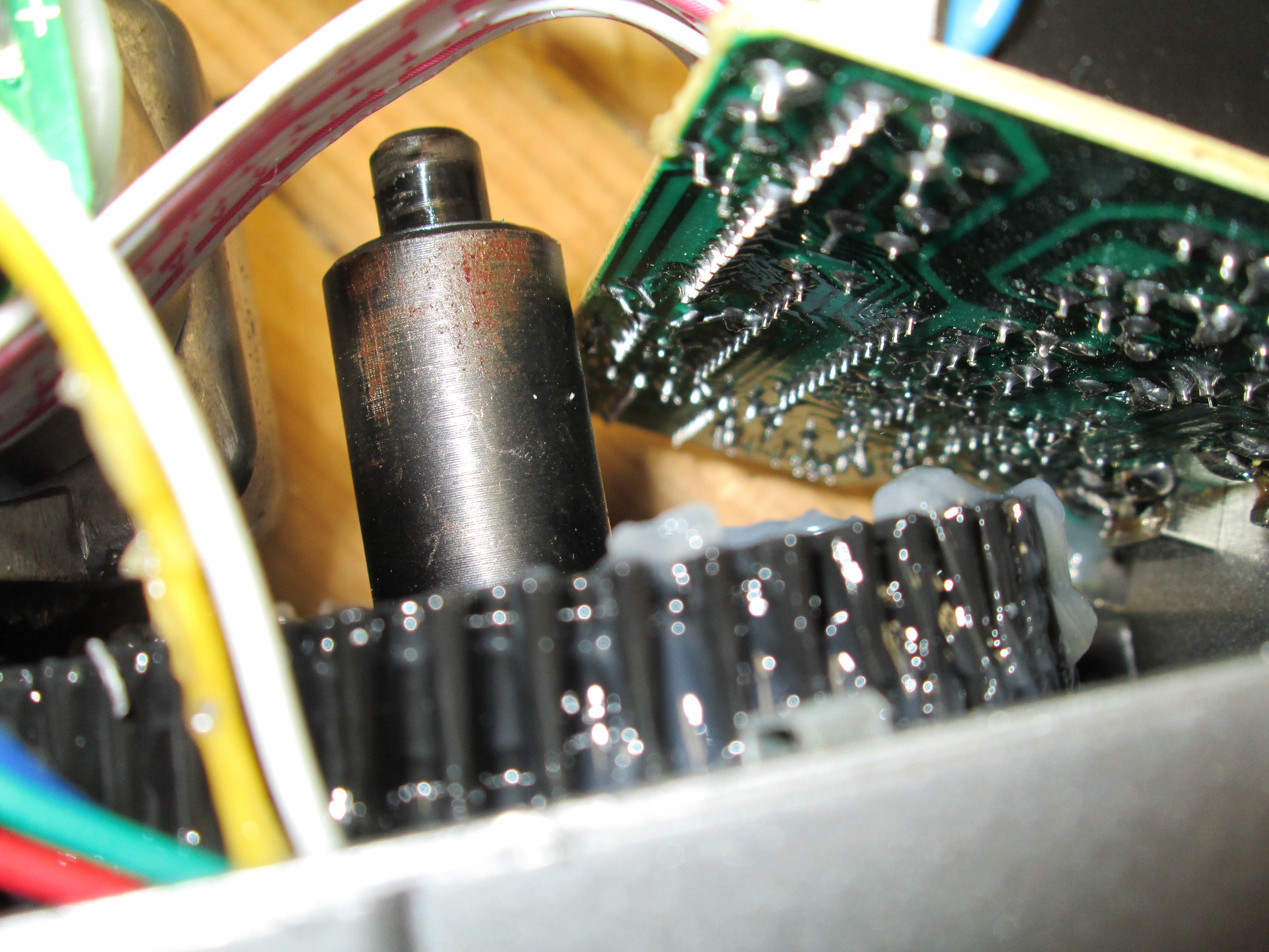

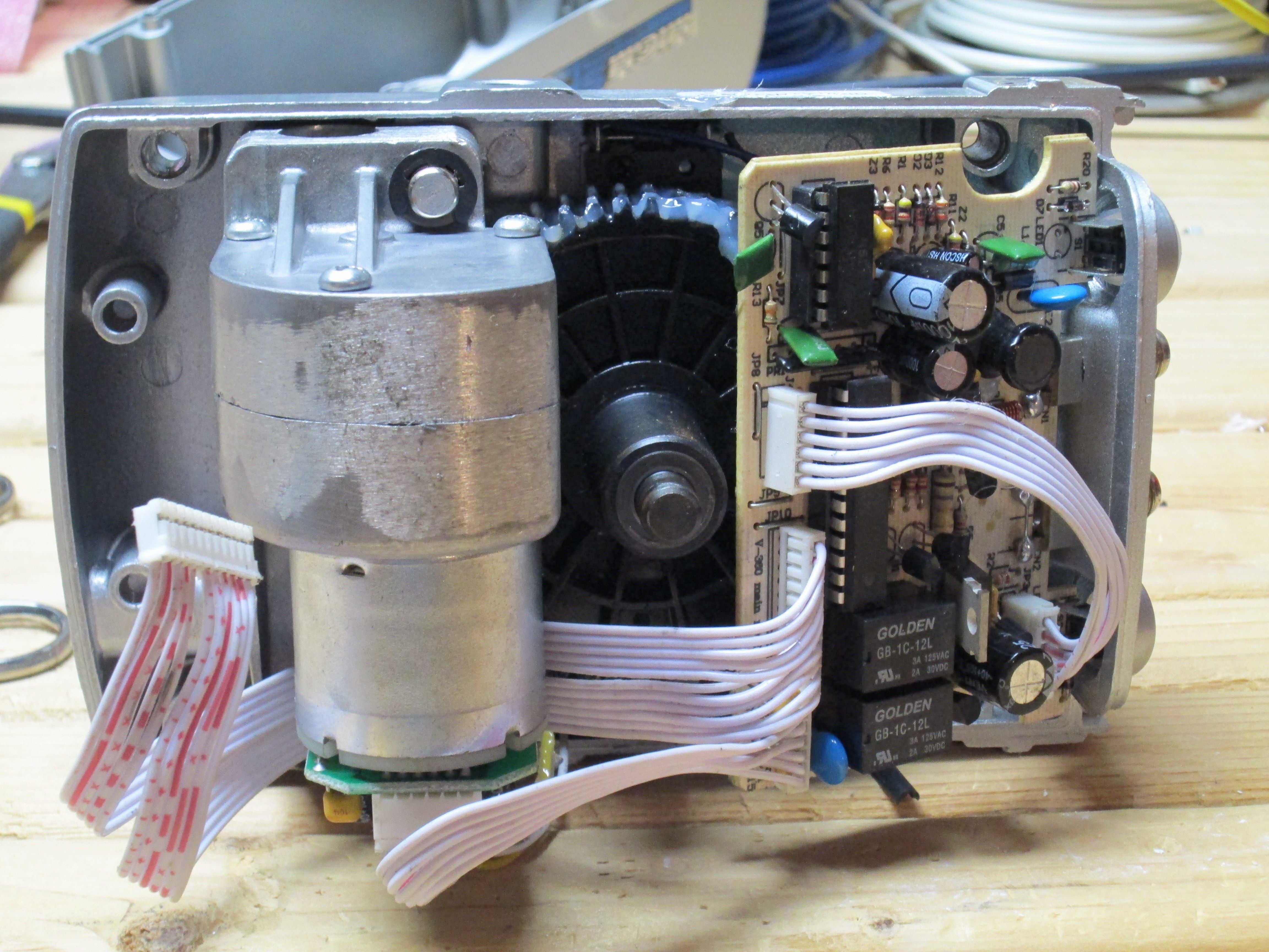

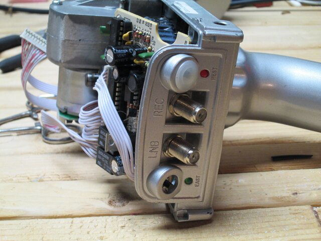

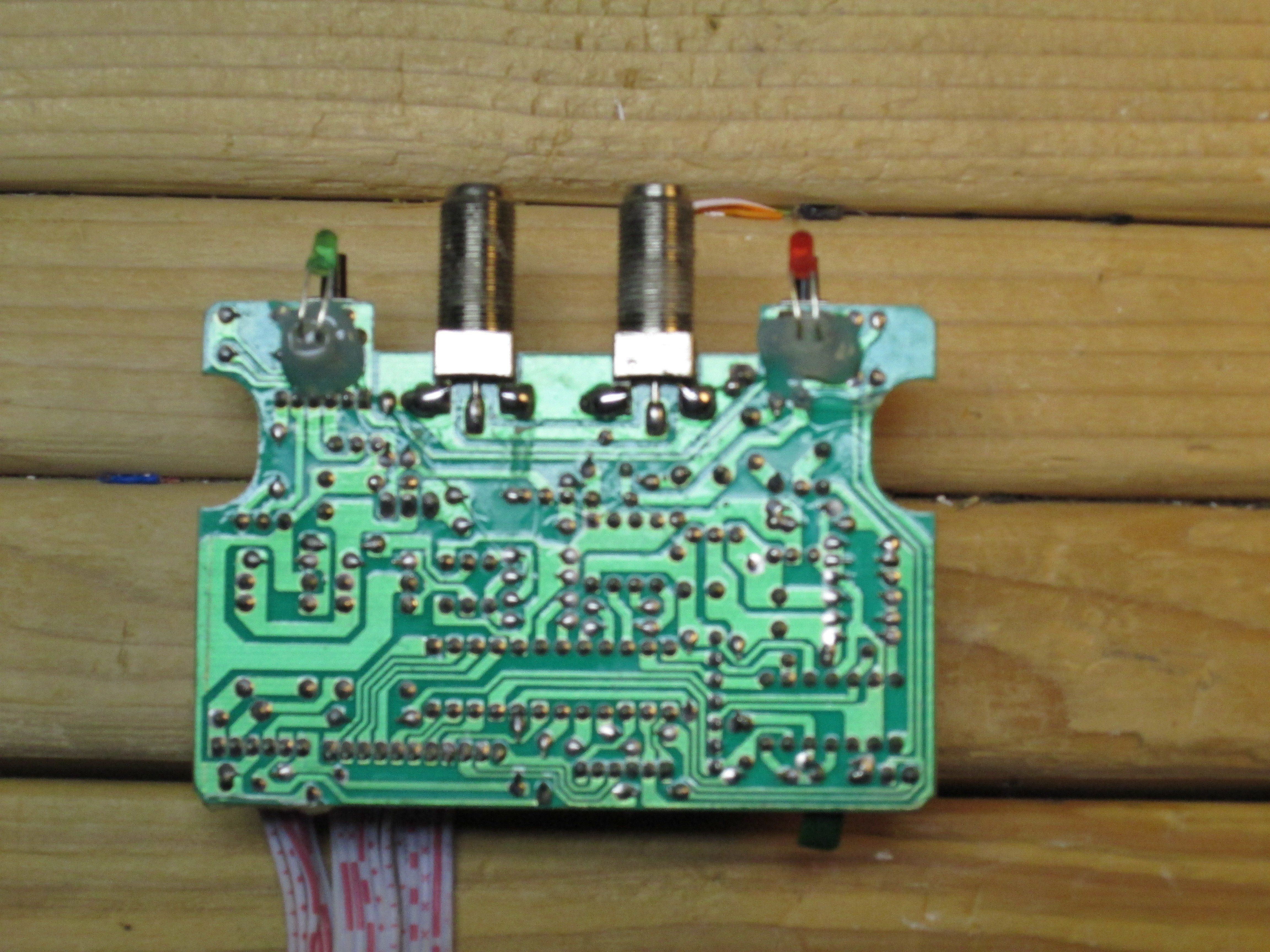

Most motor designs place the electronics away from the motor and gears. It caught my eye that the electronics are directly adjacent to the gear and shaft. I am unsure if lubricant on the circuit board might damage the PCB. Maybe someone with better knowledge of the effects of grease or other lubricants would comment on if this? Personally, I would require the manufacturer to insert a plastic or other barrier shield between the circuit board and the gear.

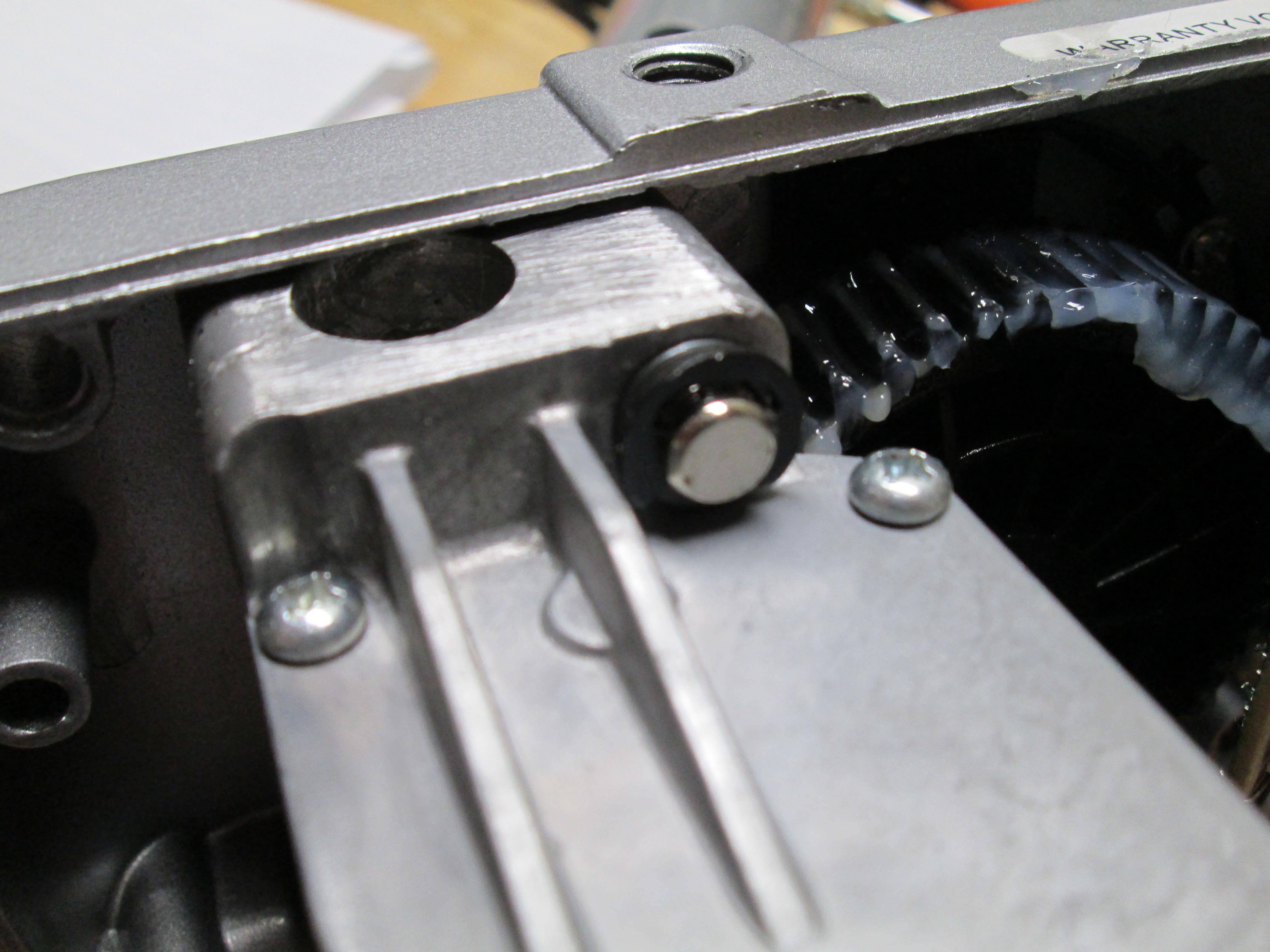

Not sure how the backlash is adjusted or how manual East / West mechanical stops are set.
Overall, looks like a great product and something that I will certainly test and hopefully recommend!
Merged a couple threads and posts..;)
Kind of looks like the lube is very translucent much like silicon lubricant, also known as dielectric grease. If so it's pretty much non reactive with the circuit board components and conductive material as long as it is pure and as long as it doesn't coat anything that needs to radiate heat. It likely makes a good thermal insulator as well.

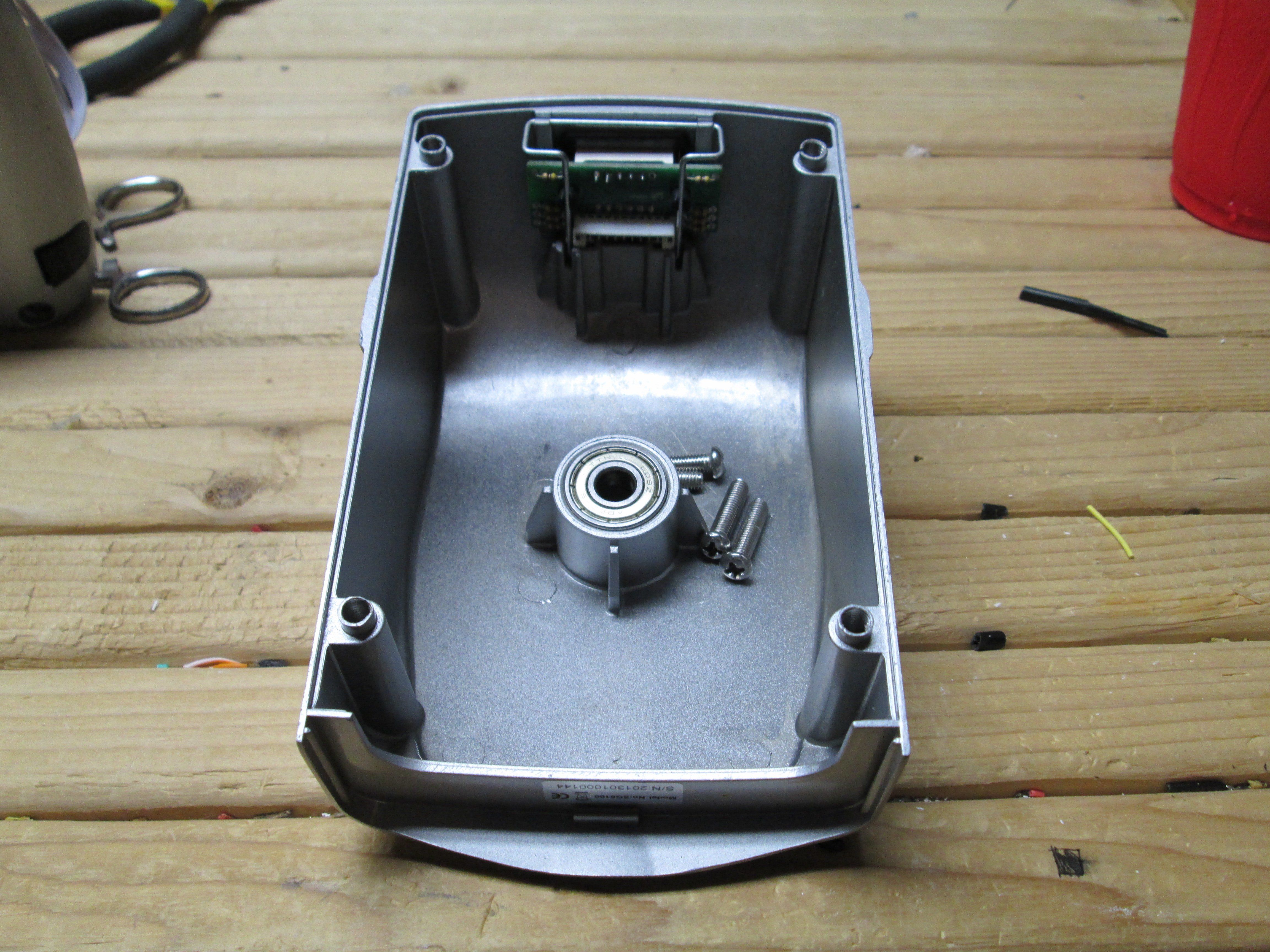

Motor does look well made. Certainly a candidate for a replacement if I were to require one. Great pictures Wallyhts. Looks like a real bearing in the top cover for the sector gear shaft. Maybe that's where there might be some play? 1/8 deg or less play wouldn't likely be a big issue, the mount and pole likely moves more than that as the assembly rotates anyway. Better to have just a bit of play than to have it bind.
Wander what the secret is that makes the motor go faster than other units? Maybe a more efficient electric motor design that has become more affordable in mass production to be used in this application...?

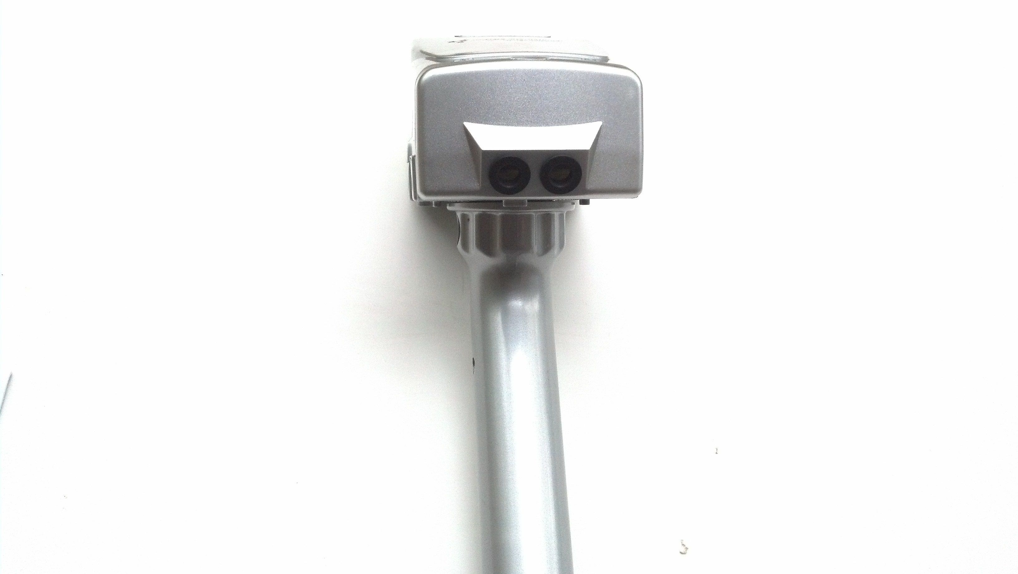

One question... the display at the top... how does it mount and how well does it appear to seal out moisture from entering the enclosure?
Also I really do not like the little rubber plugs that cover the switches. These tend to crack & break after a couple of years' exposure to the elements.

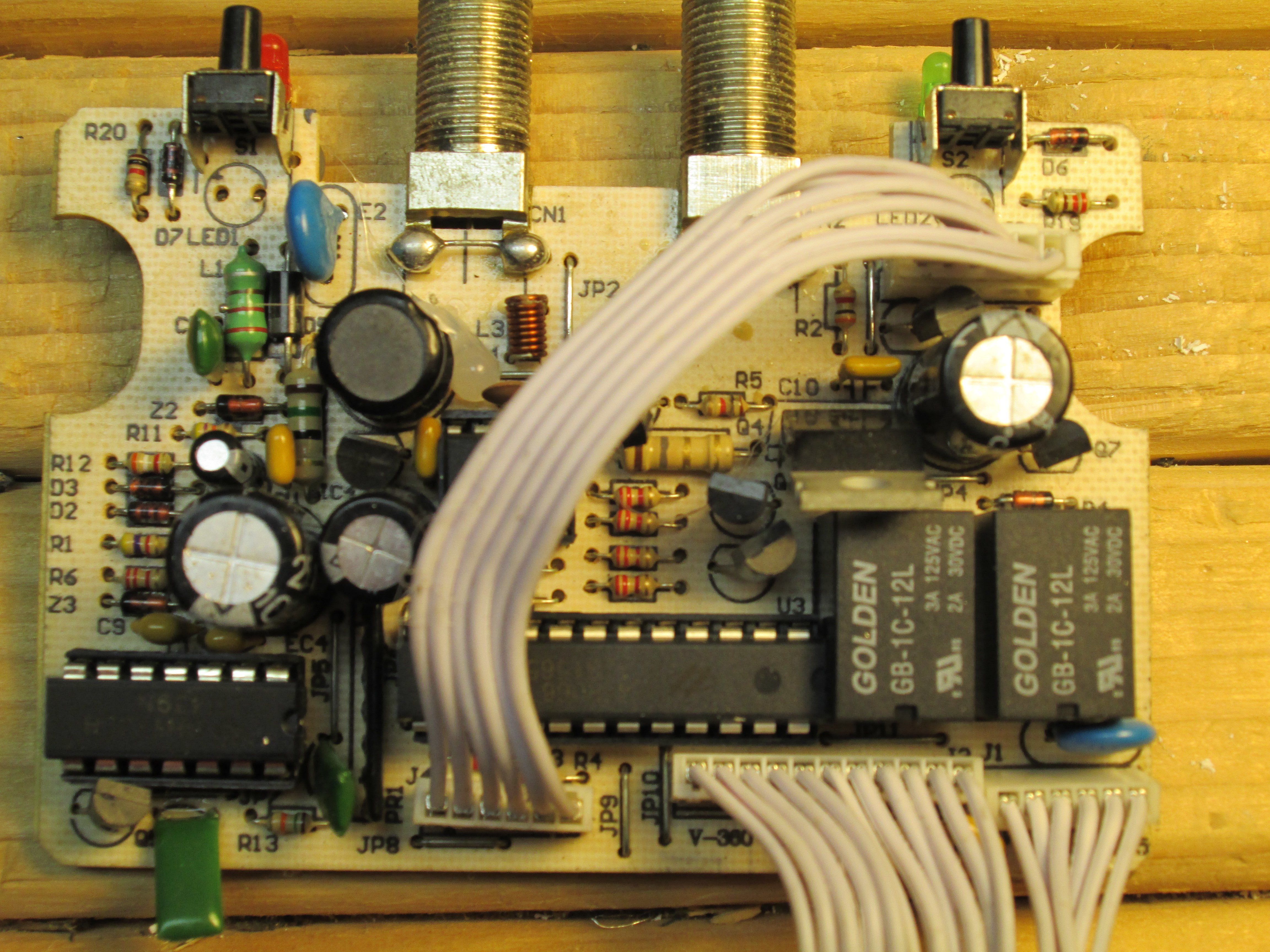

Observations from the photos:
Good, bad, et al . . .
- don't see how backlash is adjusted. Will be needed for wear.
- IC sockets? Doesn't seem appropriate for a production device.
- Is PC board held in place by anything besides coax connectors?
- Relay contacts rated 2amps @ 30 vDC. Seems appropriate.
- relays crowded by components. Replacements must be identical size.
- Coax connectors have square shoulder. Do they fit into square recesses in motor casing, preventing connector twisting?
- Looks like limit switches are under big plastic gear.
Or it's a great thing if one has any EPROM reader. :)
Nope
Good question not sure will look when I get back to town Sunday.
Good catch on the PCB supported only by surface mount f-connectors. Might suggest a modification of the manufacturer to support the rear of the circuit board. With the vibrations and sudden movements of a motor in action and those caused by wind load, the f-fitting solder joints might be the fail points.

Hey ke4est .. did you take a pic of the motor on the 1.2m dish??
