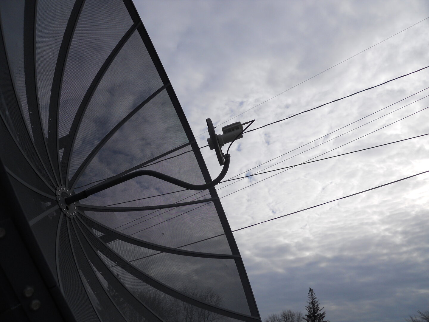

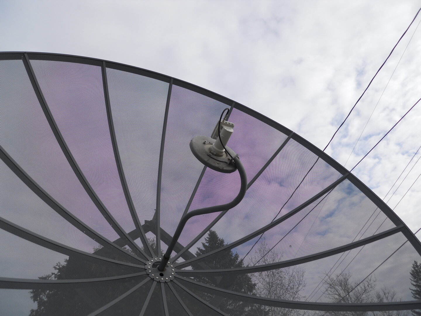

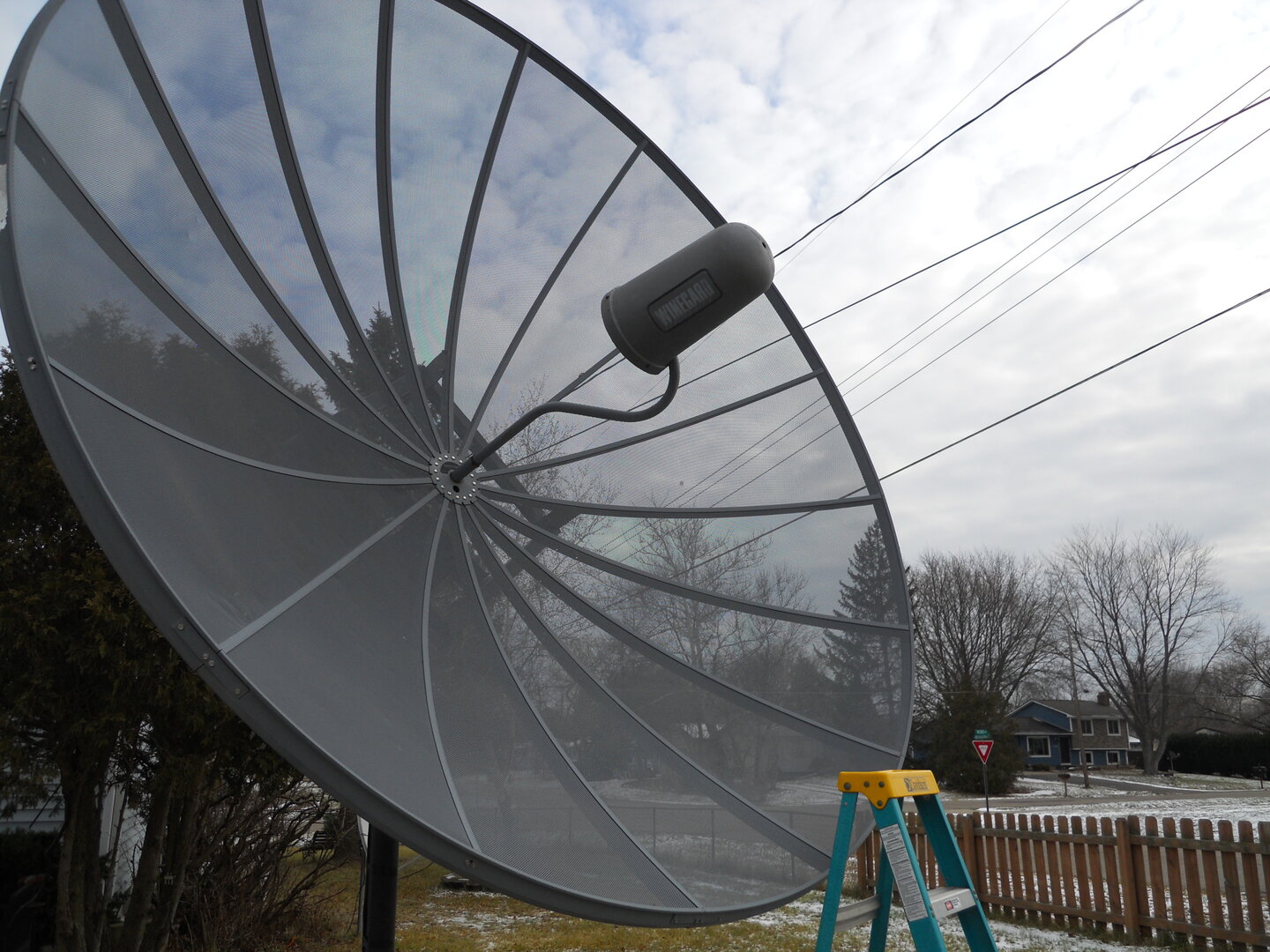

I received my Titanium C138 5G Filter LNBF yesterday. Fast shipping from Titanium Satellite. We have a big storm coming here to Michigan today, so i thought i would beat the storm and get this installed. I have a 10 Ft Winegard Pinnacle BUD and lucky for me, i have the manual so i know the focal distance right from the specs. Set that and had to do a best guess for the rotation of the LNBF. Turns out i was off quite a bit at first. After a few adjustments got that just right too. Its a bit of trial and error for me. The dish has to be moved to extreme west for me to be able to reach it with a ladder barely. And no sat signals there. So i have to set it, run the dish to true south and check thats its horizontal.
Anyway, this Titanium C138 5G Filter LNBF totally fixed my 5G issues. Completely 100%. Prior to today and for about 4 weeks now i was using a BSC621 C/Ku Combo LNBF. And that worked great for me for C and Ku. But i started noticing pixelation creeping in. I checked online to see if 5G was finally in my area, and it was. And then it got worse and worse. Checked every possible "other" issue, connectors, coax, etc..
The Titanium C138 5G Filter LNBF totally fixed all of that for me. Before i could get say CIVI on 119.0W but it would pixellate enough to make it unwatchable. Over on 127.0W i could not even get a signal on the NFL /Mav TV Transponder. After installing the Titanium C138 5G Filter LNBF, no problems whatsoever, CIVI etc plays perfect. I scan in everything on on 127.0W, same on 103.0W. 3 Sats tested, everything is great.
If you have 5G issues like i did, i would totally recommend this product. I am a happy camper having my C Band back to normal. I lost Ku Band on my BUD by changing, but i will add a Ku Sidecar LNBF come spring. For today, i am satisfied, and i beat the storm by a couple hours. Now i can sit here safe and sound the next 4-5 days and watch TV!
And that you Brian @ Titanium Satellite for a great product and fast shipping!

Sadly - the very next day after i posted this - the storm and the heavy winds started, i went to bed that night and the next morning my BUD had separated from the Actuator Arm completely. Dish was all the way east resting against the mount pole. Bracket hardware holding the arm to dish had busted into pieces from the wind, never seen anything like it, and i have been through some horrible wind storms. (i should've took some pictures). Took me all the way until today to get it back in shape again, mostly due to the 3 day storm, then come cold weather. But today got it back in tip-top shape, all dialed in. Beginning to feel like a real expert after all this work in the last week or so. lol. In the spring i am going to go over every detail on my BUD, ever nut and bolt will be replaced, rust removed and painted etc.. It is SO horrible when something goes wrong and NO TV!
