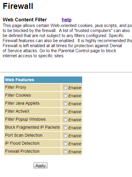

And TWC wants to charge 10 bucks a month for it too. Already have mine I bought on my desk waiting for my install Friday morning. ;) Do you have the flood detection turned off on yours?

Yes I have all the firewall stuff turned off on the cable modem, but have my EA4500 doing that job.
