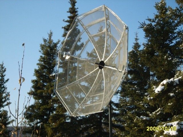

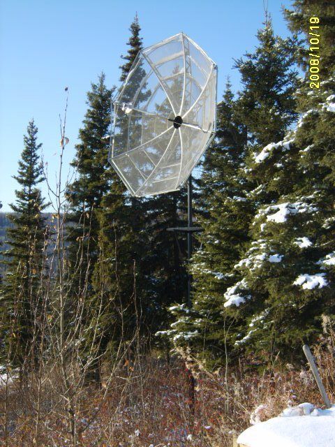

Paraclipse copy- 12' on KU
I am about to find out myself, I have an old Paraclipse knock-off ( a very good one) from back in the day made by a company called U.P. Superior. I dragged it up to Alaska with me in the 80's, and used it for years on C band. I used to install C band systems, and these antennas worked very well indeed. Have never tried one on KU though.
I just ordered an inexpensive KU LNBF for prime focus feed and am going to give it a try. I expect it to be tough fine tuning the feed and mount. The mesh holes are the same as a Paraclipse.
Problem is, the antenna is on a 20 foot pole made of drilling rig well casing sunk in a mass of concrete at the base, no guy wires. My service access is a platform I welded to the mount, which doubles as a Moose stand (!)
It is tough to get to the feed for tuning.... Guess I will use an old GI receiver for a dish mover. Wonder if I should try to use the current butttonhook feed, or fabricate a quad arrangement?
Attached is a photo of the beast.

I think I would try first with the buttonhook assembly, just for grins. Park it on G18 first, there has been color bars on one tp, 19 I think, for months, to help aim. Then if it's going to work, you should be able to get some of the digitals on the ku side without too much tweaking. Check out the focal length for your dish, ku needs to be much more exact to get the best signal. And of course, the tracking of the dish might have to be adjusted. A 12' will see more precisely.
