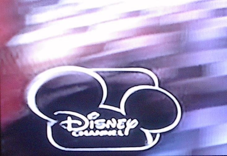

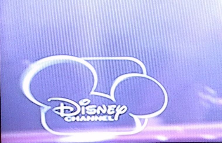

Master vs DirecTV
Here are two pictures I took of a 4DTV master feed and DirecTV's counterpart. I did this of the channel logo so it can show the sharpness difference and artifacts. You'll notice with the master it's very clean and sharp (no artifacts) Direct is soft and has mosquito noise hanging around it. It's the same for the W5 stuff, like the Direct shot. I took this with my tripod off my 1080p HDTV screen.
EDIT: Look at the word channel, see how it looks smeared in the Direct shot. I bet that is because of the downsizing of the resolution then blowing it back up. We know in the master it's the full 640x480. What I'm showing here is no second generation be it HITS, pizza or cable all loose quality because of the re compressing of the original to fit in the bandwidth the provider allocates. This also is why the quality of the second gen's don't shine on a HDTV since it wants pure signal. The master provides this and looks good on a HDTV even though it's SD. With the kill off of the masters for good as of Dec 31, except when something goes ITC we will not be able to enjoy this quality anymore. This is why I need to keep the generic maps. To enjoy these open events and the quality I had daily for 23 years. What I took for granted is now only a hobby type thing :(
