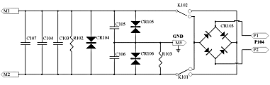

There is a TVS that is located on the actuator supply pcb that go bad. I believe the part # is CR104
Here is a link for the part:
1.5KE51CA-E3/54
You can clip one end of the leads if it is shorted to see if it restores operation. If it does get the new parts before using it for regular service.
The pictures are for the 920 and were found on the net.

Is there voltage at the input and output of the bridge? Is the bridge rectifier shot? The circuit is pretty simple. Vcc through bridge feeding a couple relays. A few protection devices too.
You should check the caps and other parts for any signs of short, value change etc. If your going to get another 922 with a known good board in it then I would do a swap. If that don't fix it the issue, it's looking like a logic control problem. If that's the case you would be better off to ship it to ATS. To answer your question about the TVS if it was shorted when you clipped it from the circuit the thing would work as long as the logic circuit is good.
