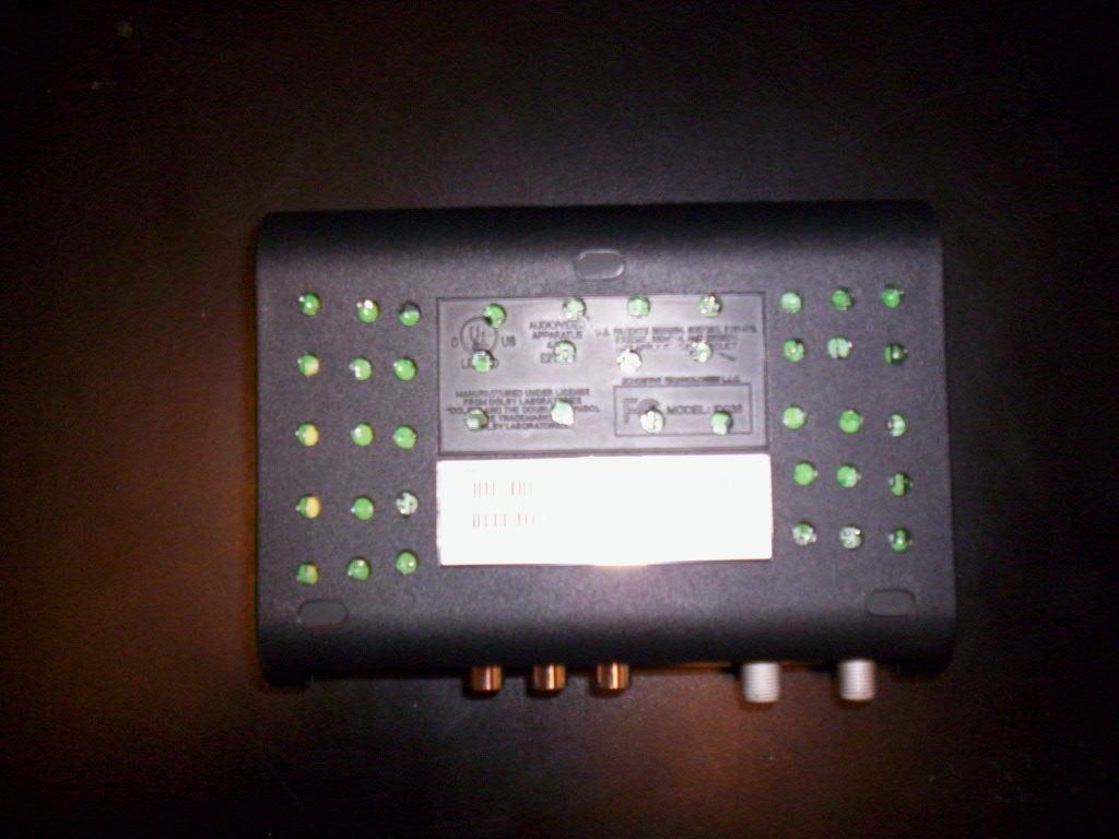

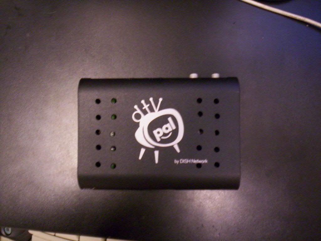

The DTVPAL runs warm, so I removed the board from the case, (not much larger than a pci network card) and drilled the top and bottom full of 3/16 holes.
Runs much cooler.

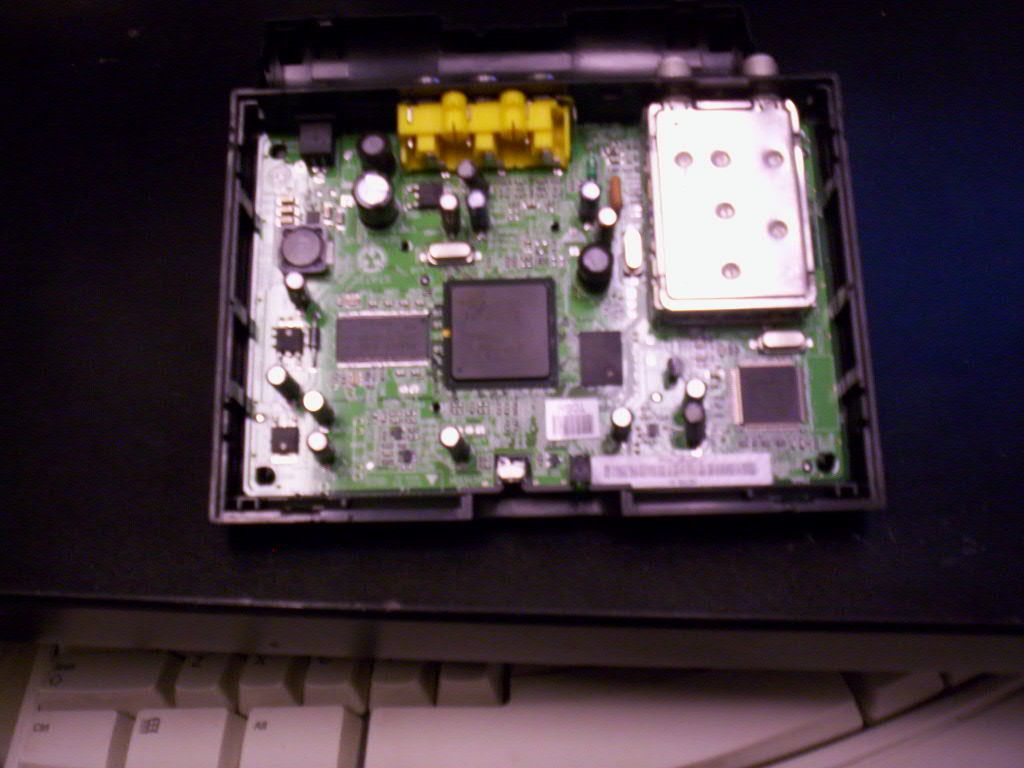

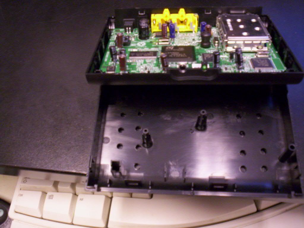

Found some time....
As you can see. there is little room inside... MAYBE you can fit one of these video card fans to the inside top of the enclosure. There is about 3/4" between the board and underside of the top.
there is 1/8 " between board and bottom.
To open case, you will see two slots at the rear above and outboard of the RCA connectors. Push in with small screw driver while separating case halves.
Good Luck!
(sorry for lack of picture clarity, but it's all I have...)

Thanks for pictures, but sorry - it's useless. If you don't have better camera, could you please provide info what printed on chips and the tuner can ?
Well, pardon me. No one asked for chip numbers.....
I'll post them as soon as I get a few minutes this evening.
For now though, I seem to remember Thompson or Thomas on the tuner can.

So, something is far better than nothing, and these are the first inside pix I've seen.
If the guys on the AVA forum have any, I haven't run across 'em.
How to take the box apart was a major concern, too.
Your comments about heat in the box, and how the cooling vents helped, were of interest.

I'm glad for the pics, and the news about heat.

DTVPAL Chipset Numbers
Cross reference with Pic at bottom of post.
1: Hynix 815A C
HY50U121622DTP-D43
KOR
NWFDU2477
2:STi7707WUDP
L3749005
220KWL3
MLT22811
3:Spansion
S99-50048
815BBW21 H
Thiland
04 SPANSION
4: STV0373
VQ737KJX
22 02V VQ
MLT 22 810
5: Tuner Can:
THOMSON
These strings are typed exactly as printed on the chips with the exception of copyright symbols and logos.
Hope this helps. If you need anything else let me know !
