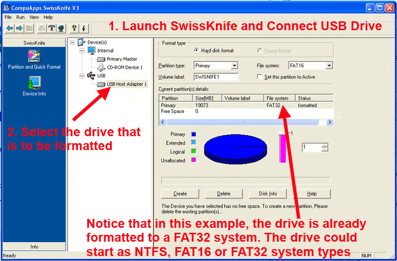

I've downloaded SwissKnife twice. Both times it displayed 2 options for formatting.. HC..?? or FAT16. There was no choice for FAT32. It highlighted the 15 gb 'H:' drive as being already formatted at FAT32. I saw no option to delete any existing format on the drive.
Both instances of SwissKnife stopped working, and I uninstalled it. I also uninstalled the HP program.

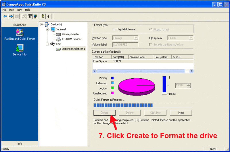

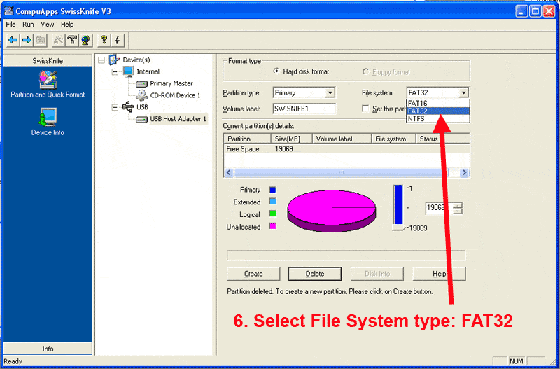

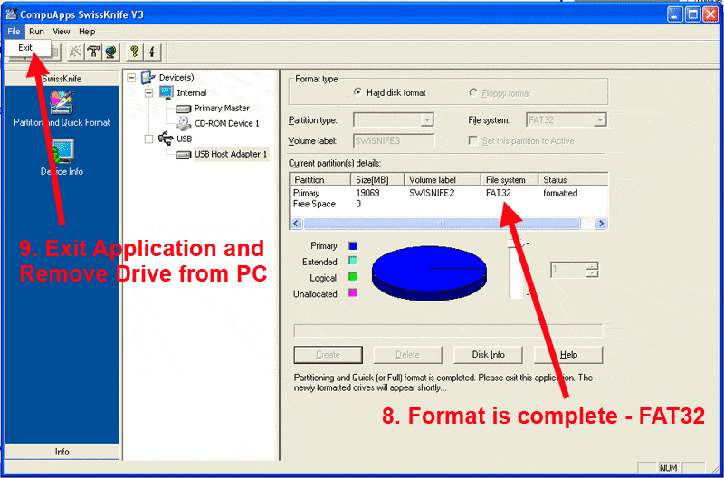

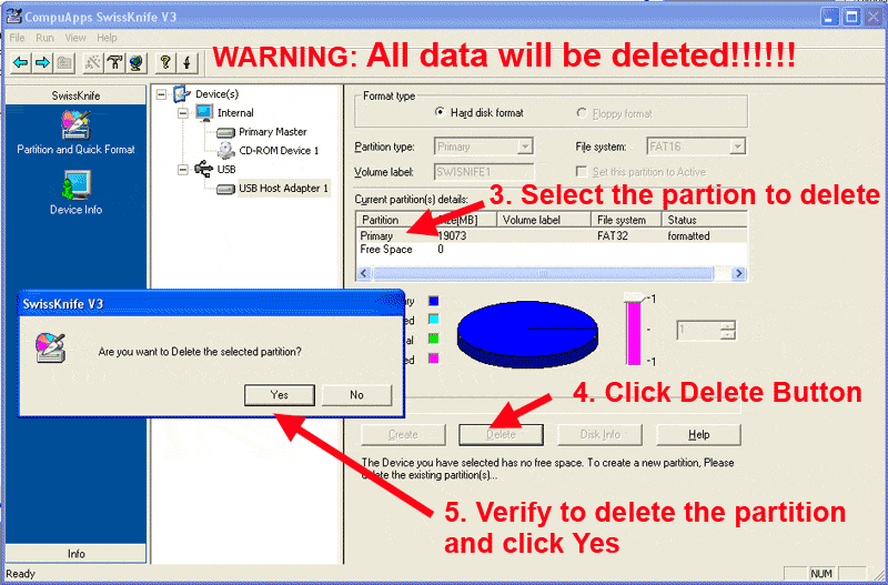

Here is a quick tutorial on how to format a drive using SwissKnife.

Thanks, Brian for the tutorial on reclaiming the hdd. I didn't know it takes a 'delete' function plus a 'create' function. It was easy to do after a long, hard road to getting a SwissKnife program to work.
I downloaded 'free' SwissKnife many times on the church's 64bit machine. It never worked. Most times, it just died. It never showed an option to creat a FAT32 format. The only options were NTFS and FAT16. I gave up and came home and tried the 'free' version on my 32bit machine. It also died or would not completely load. I paid for the premium version. It took 6 hours to get an access key, but when I did and read your tuorial, it worked fine.
I took the drive back to church and it records/plays back fine in the 1100c. Since my very first navigation of the drive on a computer resulted in a corrupted file system, I am reluctant to do that again, although the delete and create process can now be done very quickly.

Both the free and the premium versions of SwissKnife will format to the FAT32 system type. The Fat32 system format option is available as long as the original partition is erased before attempting to format.
