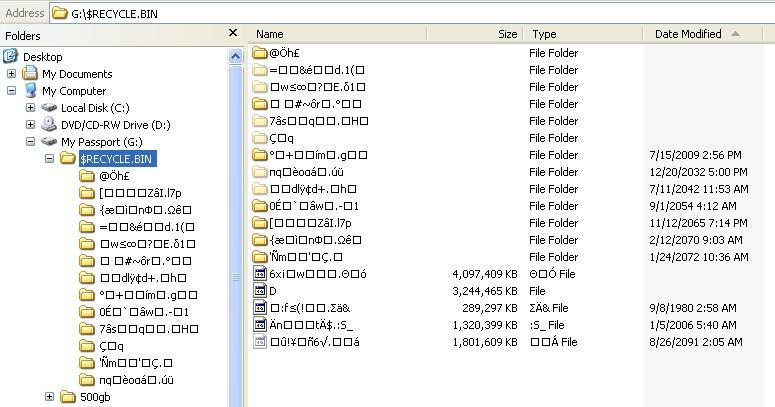

I have a WD 5000BEV external USB drive. It came as FAT32 already. Plugged it in and it did time machine and time record fine. When I plug it into my XP pc I can't see the files in a useable format. Do I need a different OS to see the files, or what is the solution? Screencap attached. I can't browse any of those folders that were created either. When I plug it back into the dvr I can play the files fine.

Usually this issue occurs when the hard drive directory is corrupted. This may have been the result of the hard drive not being formatted with the receiver prior to recording and occurs frequently on hard drive that are over the supported 500GB size. Unfortunately, the recordings will be lost in the process of fixing the directory. We recommend that any hard drive must be formatted by the receiver prior to recording. The factory formatting may be generic and missing important table information required by the receiver to reference the recordings.
How to correct?
You might be able to just format the drive with the receiver. If this does not correct the issue, you will need to first format the drive in a Mac or if on a PC with software such as SwissKnife to FAT32, then format once again with the receiver prior to recording.
Notice: Never delete or rename program recording files with a computer.
