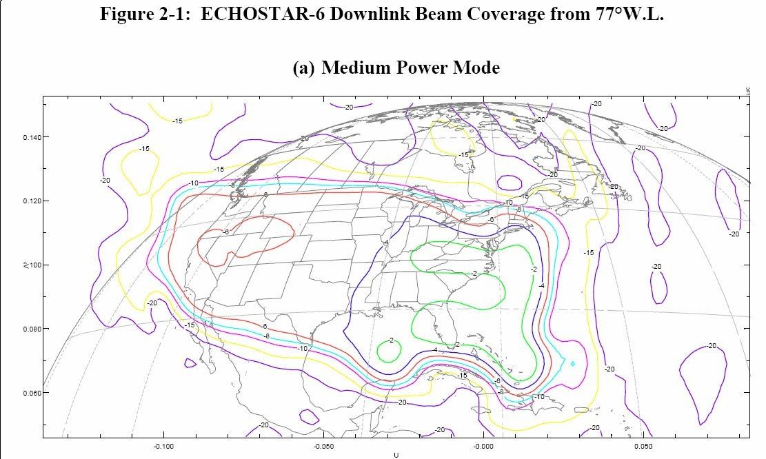

The 9 degrees of spacing allows a single dish multi satellite to work better. Essentially the multisatellite dishes are a compromise, designed to work best in one spot. As you move farther away from the spot the more out of focus it gets (you can aim at one satellite but the others get more out of focus). The large spacing allows them to still pick up a signal from a larger geographic area.
If Dish has a satellite at 77 and Telestar decides to provide service with a triple dish pointing at 72.5, 82 and 91, areas that are far off the designed center point can have the focus of the dish moved far enough that 77 starts to interfere (most likely with 72.5 since 82 would probably be peaked). The dish would probably work over most the useful area anyways (NW Canada pretty low on Horizon to see 72.5) if it was locked on peaked. Of course Dishes tend to get blown around and such getting out of alignment, having a satellite at 77 would make a dish fail to get signal when it otherwise would.
Of course there are ways around this. Dish could work to keep the 77 satellite pointed more south, making reception more difficult in the northern US, but possible with a larger dish. If the Dish satellite fades out before it becomes a problem in Canada, they could minimize interference, especially if they make it south and east and not hit western Canada.
Both the 86.5 and 77 slot FCC grants have quite a bit of discussion about how Dish has to work with Canada DBS companies to prevent the interference or not be able to broadcast from these locations.

Funny how we always seem to think of things from our perspective (i.e. seen from the ground three satellites form an arc in the sky).
Another way to look at the "eastern arc" is from the perspective of the satellites in the vicinity of 61.5. Their signal pattern forms an arc of coverage on the eastern part of North America. From their perspective it only takes one sat to form an arc :)
