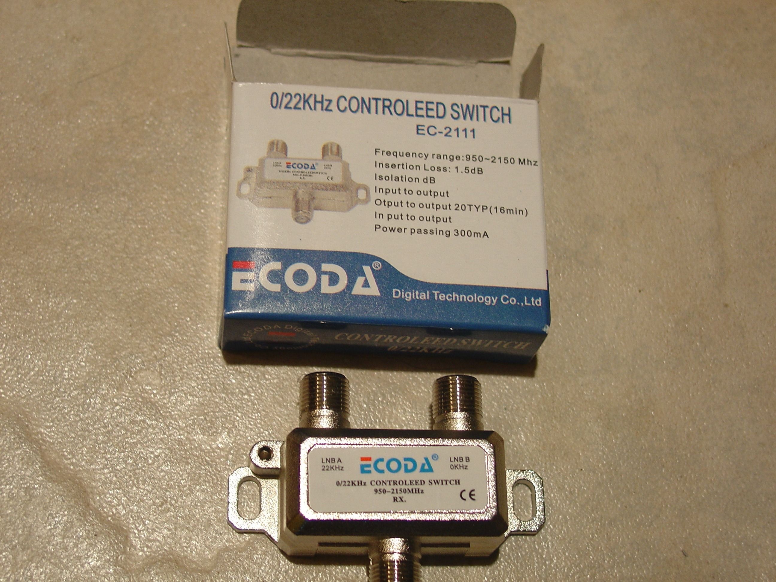

Picked up a couple of ECODA 22KHz switches. Did a temporary hookup with the SV 8000 to test the switches. SV connected to the 22KHz off side and PBS came in w/o any problem. Signal 64, Q 43. Turned 22 on and signal went to zero. OK switch works that way.
Shut down, changed connection to the 22 "on" side, powered up and, what, I had PBS? But 22 was "off". Was getting signal 30 and Q 6. Turned 22 "on" and signal went back to 64 & Q 43. This appears the switch "leaks" on the 22KHz "on" connection. Is this the way these switches work or do I have some low quality knock offs?

22KHz switches need to have both inputs connected in order to work properly. 22KHz switches will not work correctly if only the 22KHz ON side is connected. What you are experiencing is normal with only one input connected.

Interesting, I'm running several Ecodas myself and I guess I never tried only one port and never experienced it. Now I want to test it.
