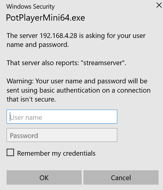

I guess I've worked myself into a corner. The updated TNAP6 now enforces a user / password login that is different from the old root/root. There is a plugin called Change root password. I tried using it and obviously messed things up. I now cannot log into my Edision box though using it for watching channels works fine. It says the password is incorrect. As a result, I can no longer ftp files into the box, use telnet, and I can't stream from the box. Potplayer and VLC present a login screen which I can't crack.
Anybody have any luck with all of this?

But still, with most current updated TNAP 6, when I try to stream via webif, or an app like Potplayer or VLC, then I'm presented with the login screen shown above in Post #1 or similar. Entering the original login credentials still doesn't work. It just prompts again. What other login info is there for the box?
