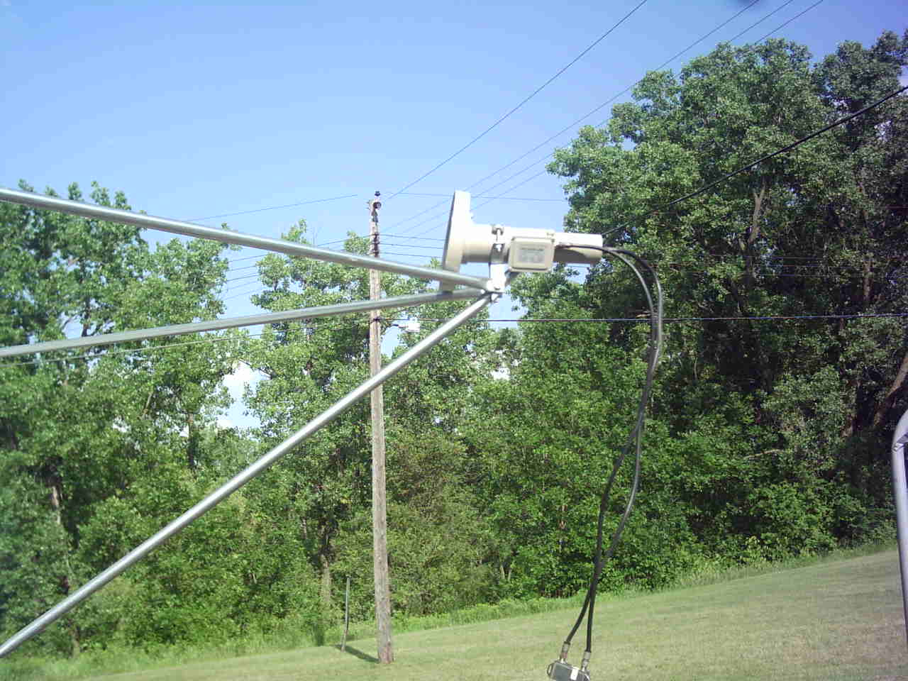

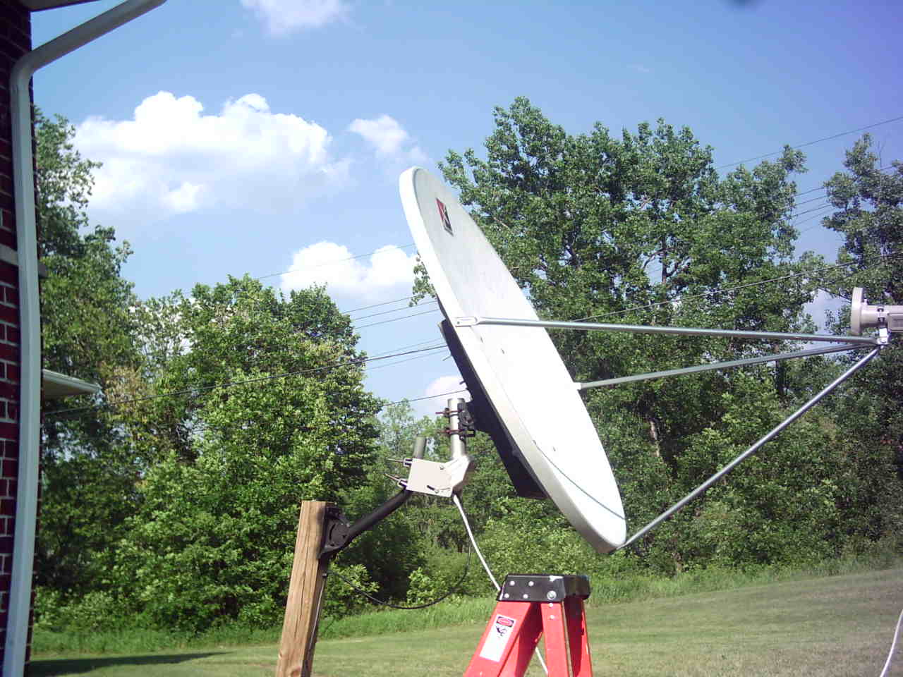

You gotta get that pole perfectly vertical, plum, if that motor is going to track the sats. Also, the motor needs to be clamped to the straight section of the pole. It looks like its on the curve at the bottom. Maybe you have corrected this since, if so, my apologies.
From that picture, the dish needs to be tilted more downward, at my latitude. Your mileage may vary.
Same comments from your previous thread still apply.
(See other thread for even more pictures.)
Until those matters are dealt with, anything else is just a waste of time. :)
I merged those two threads together :)
But until either the mast or more importantly the pole is vertical, you are going to have nothing but headaches. I think if the mast is vertical then you will have more success :)
Having an absolutely level mounting pole is especially important when using a motor. You'd be surprised by how much a hair off level will throw off your arc...
